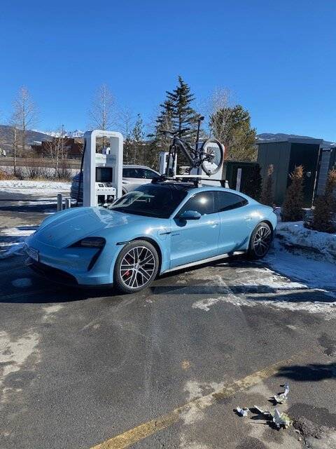

I would add to Dave's cold weather efficiency loss that if you put the roof rack on your Taycan it will affect your range as well. Put a bike on top of your Taycan, then plan on losing 15% to 20% of your range.
Drive in colder weather with the rack and a bike plan don't plan to go much farther than 150 miles at 75 miles an hour. I did this the first week of December and drove from Vegas to Denver. I stopped at every EA charger, and it made for a long day of driving!
I don't advise this until you have some experience with the car, experience charging, and a good plan on where you will charge.
Porsche Taycan How to Road Trip in a Taycan - Tips & Suggestions IMG_0300

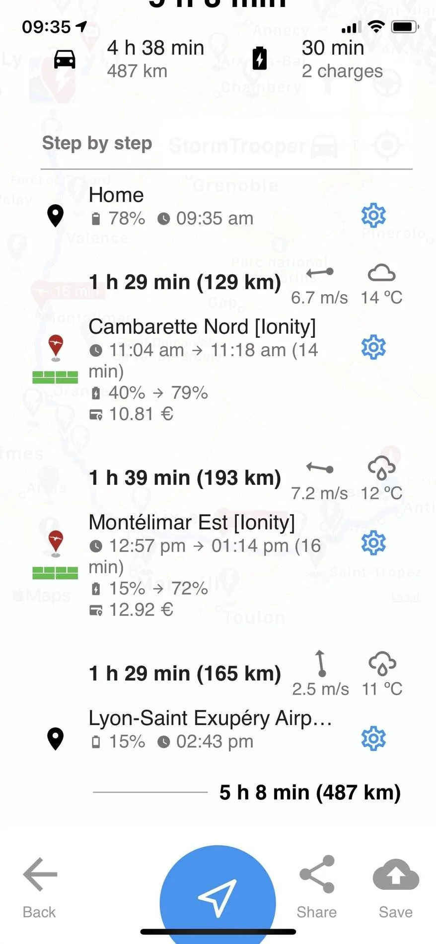

Thanks for this thread. Some useful extra tips here. I use a process very similar to @ron_b . I like ABRP which is quite accurate once you set the consumption data manually. I also have ABRP running on my phone but not always via CarPlay. In ABRP you can see a lot ( not sure if all) Ionity chargers available. They seem to change in more or less real time? Really useful and I have seen one station go from green to red when there seemed to hve been problems at the canrger!
screenshot below
Porsche Taycan How to Road Trip in a Taycan - Tips & Suggestions A70A8414-AE1C-4137-BD3D-4DEDB499F777

What consumption rate are you manually setting @Scandinavian ?
I see the default for 4S with performance battery is: 3.92 km/kWH @ 110 km/h.
3,904
3,549
I see the default for 4S with performance batter is: 3.92 km/kWH @ 110 km/h.
I have set my Turbo at 4.44 km/kWh. Or I had set it to 225 Wh/km and now pressed that hutton to convert. That is what I have achieved over a couple of weeks with normal driving out on national roads.
That's a great point, I forgot to mention. I tweak my ABRP to 270 Wh/mi @ 65mph. I have a Taycan 4S with 20" wheels and All Season tires.
That's with efficient driving in Range Mode but not overly speed restricted. 65 to 85 on the freeway. Outside temperatures around 55F-65F avg and cabin 69F.
If I want to be conservative I use 300Eh/mi.
P.S. the 270Wh/mi or 300Wh/mi numbers I plug into ABRP don't represent what I see on my Taycan on average. That is 322Wh/mi at 6700 miles. But ABRP probably has old battery capacity values requiring me to fudge the numbers.
For validation I just plugged in my 220 mile trip with many stops from the Bay Area ending in Pismo Beach. I started at 96% and ended at 11% so projected vehicle range would be 259mi. To get ABRP to plan it I needed to specify 250kW/mi @ 65mph and with that it estimated 90% battery usage when I had 85%.
