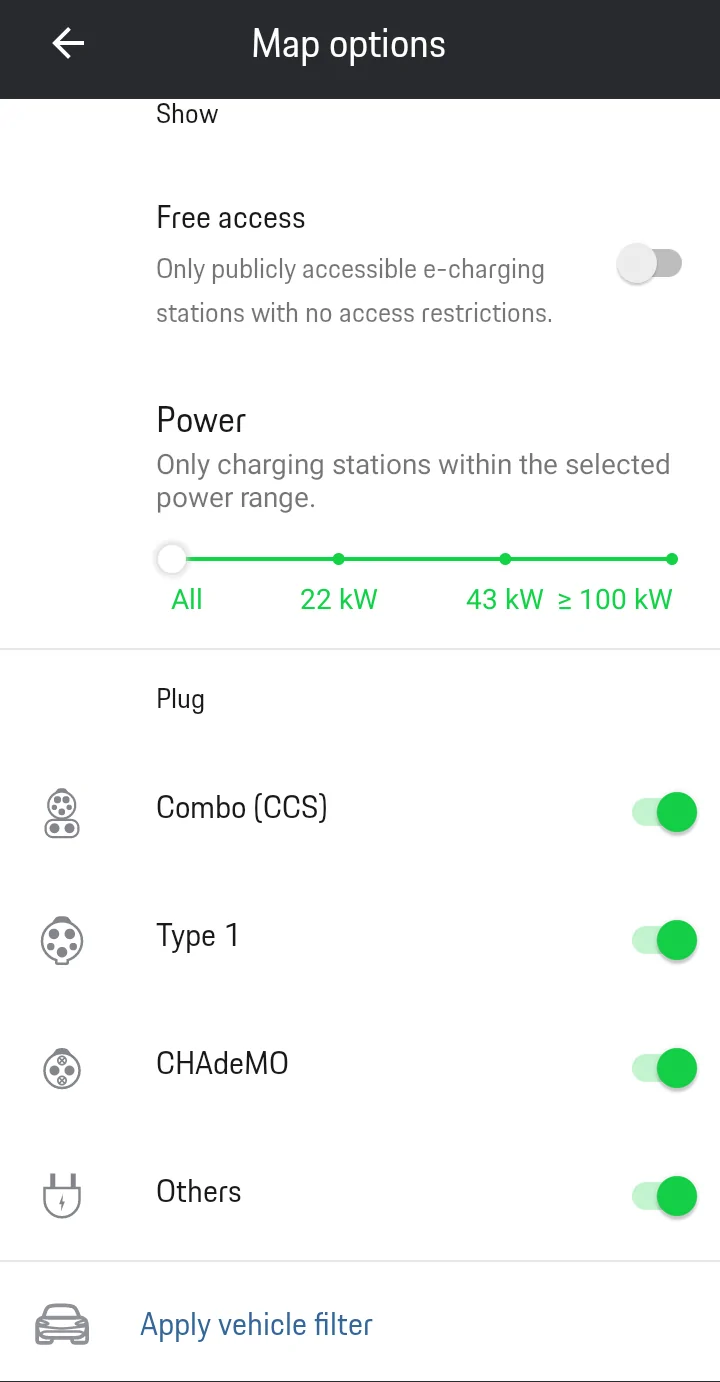

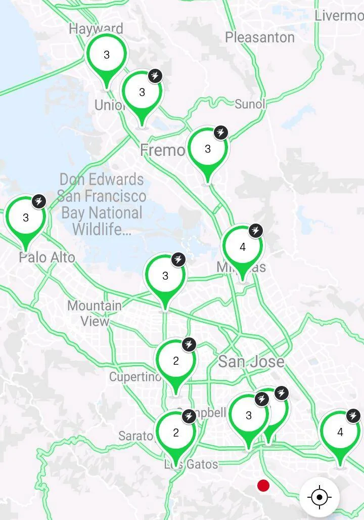

The "Charging NA" App for North America seems to show nice filter options but only shows EA stations ion the map independent of what you request. Wondering if the car shows much more?

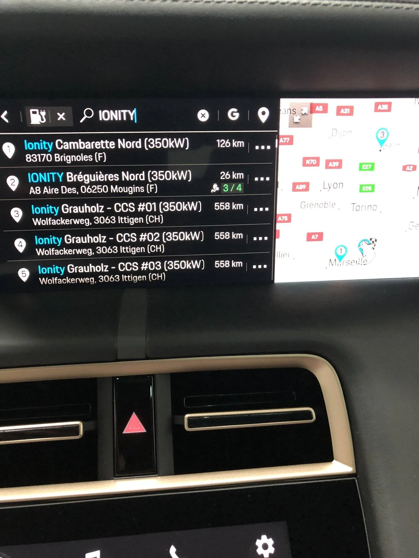

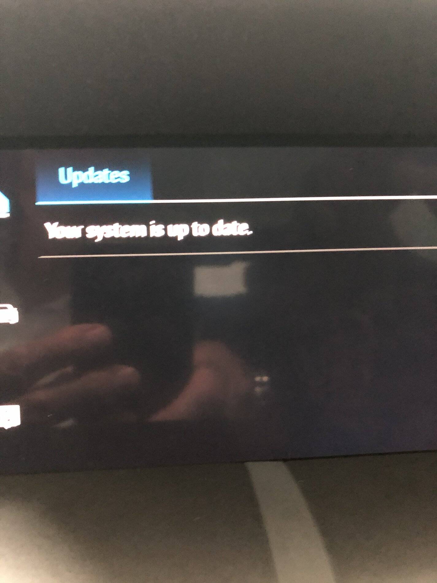

It has now got chargers in the system again. But it is not really worth the information. Two Ionity chargers over the border in Italy that have been opened 20 days ago plus one that was opened 140 days ago, are not showing up in the system! And all software is up to date!

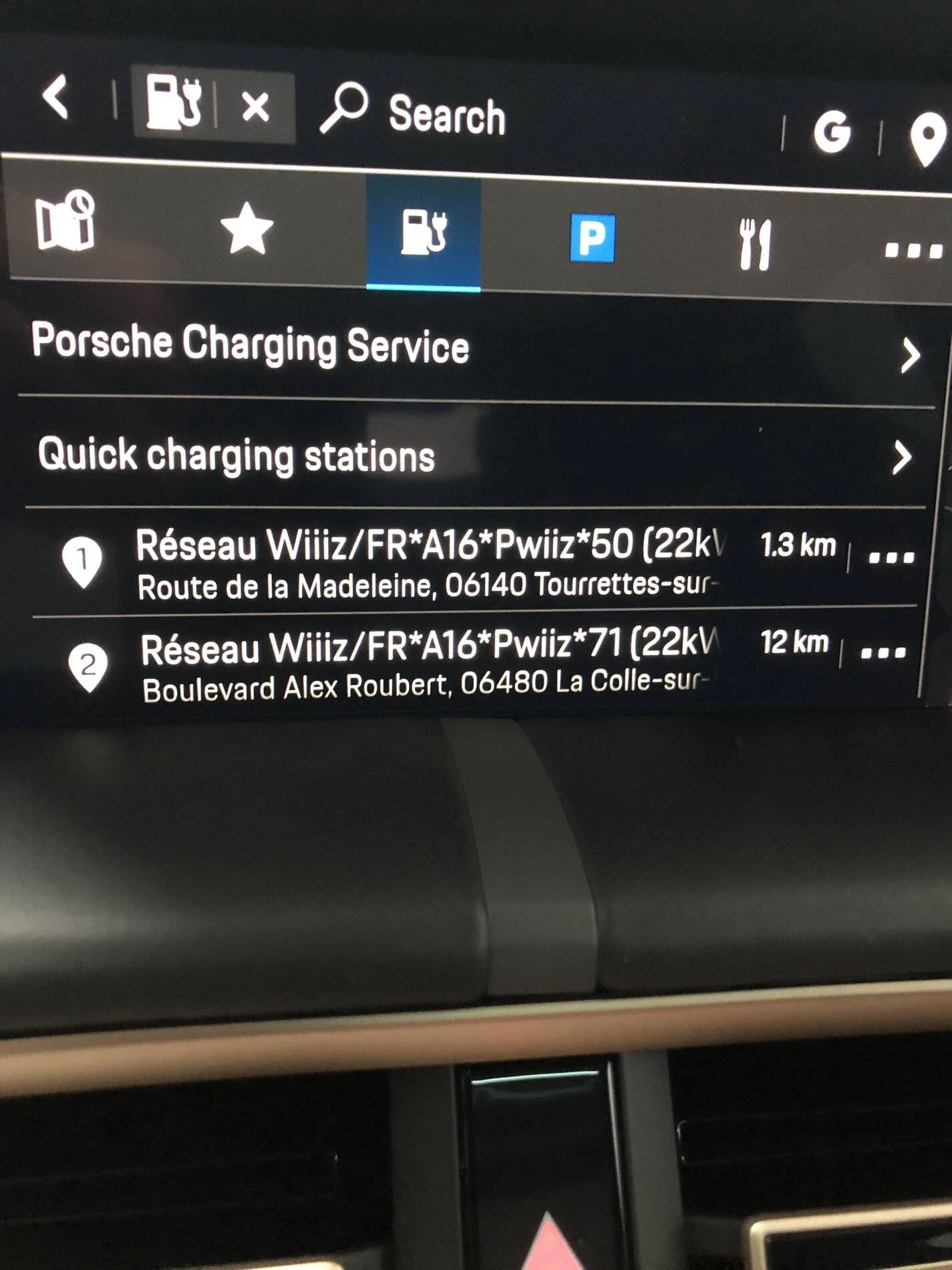

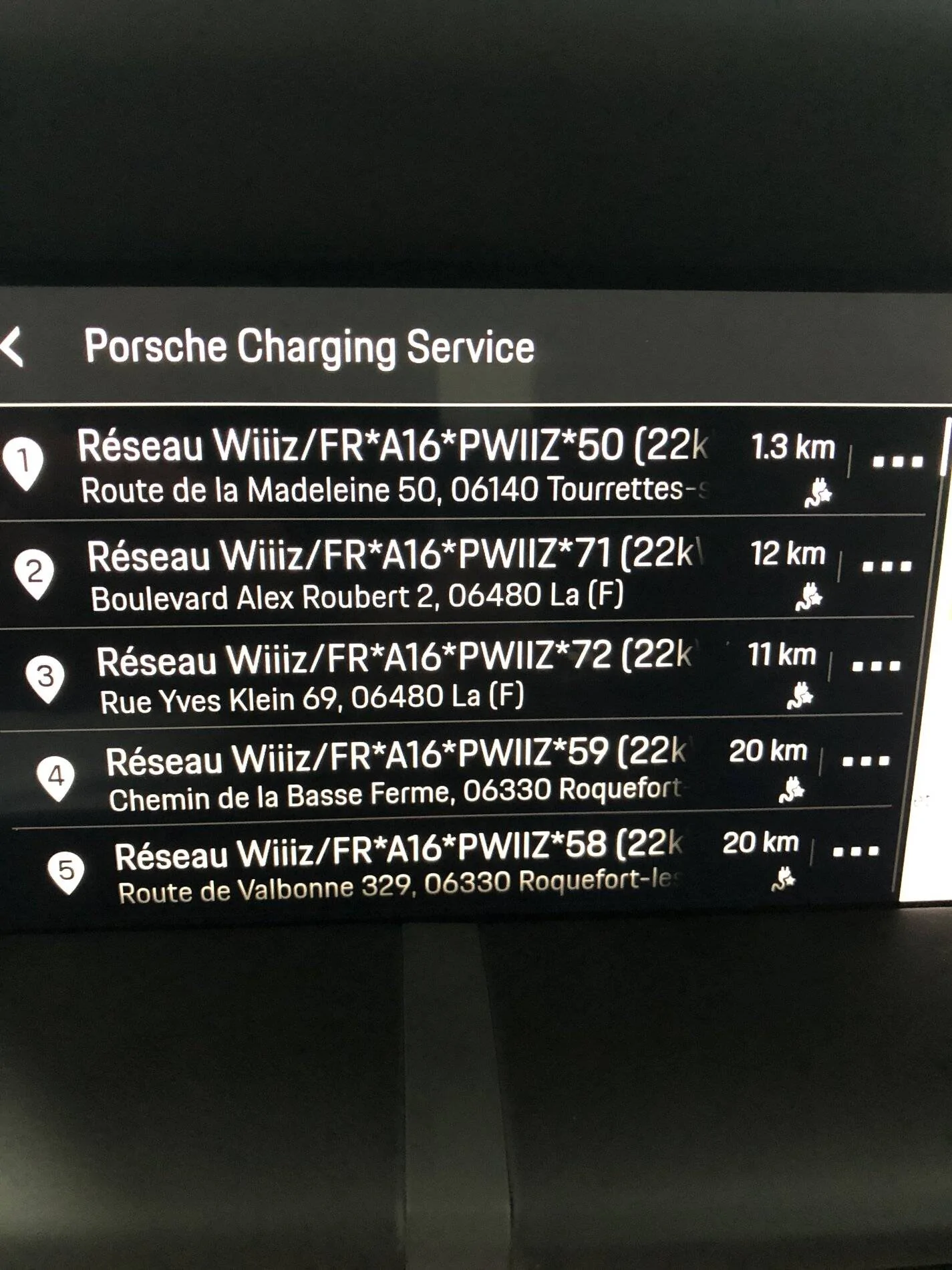

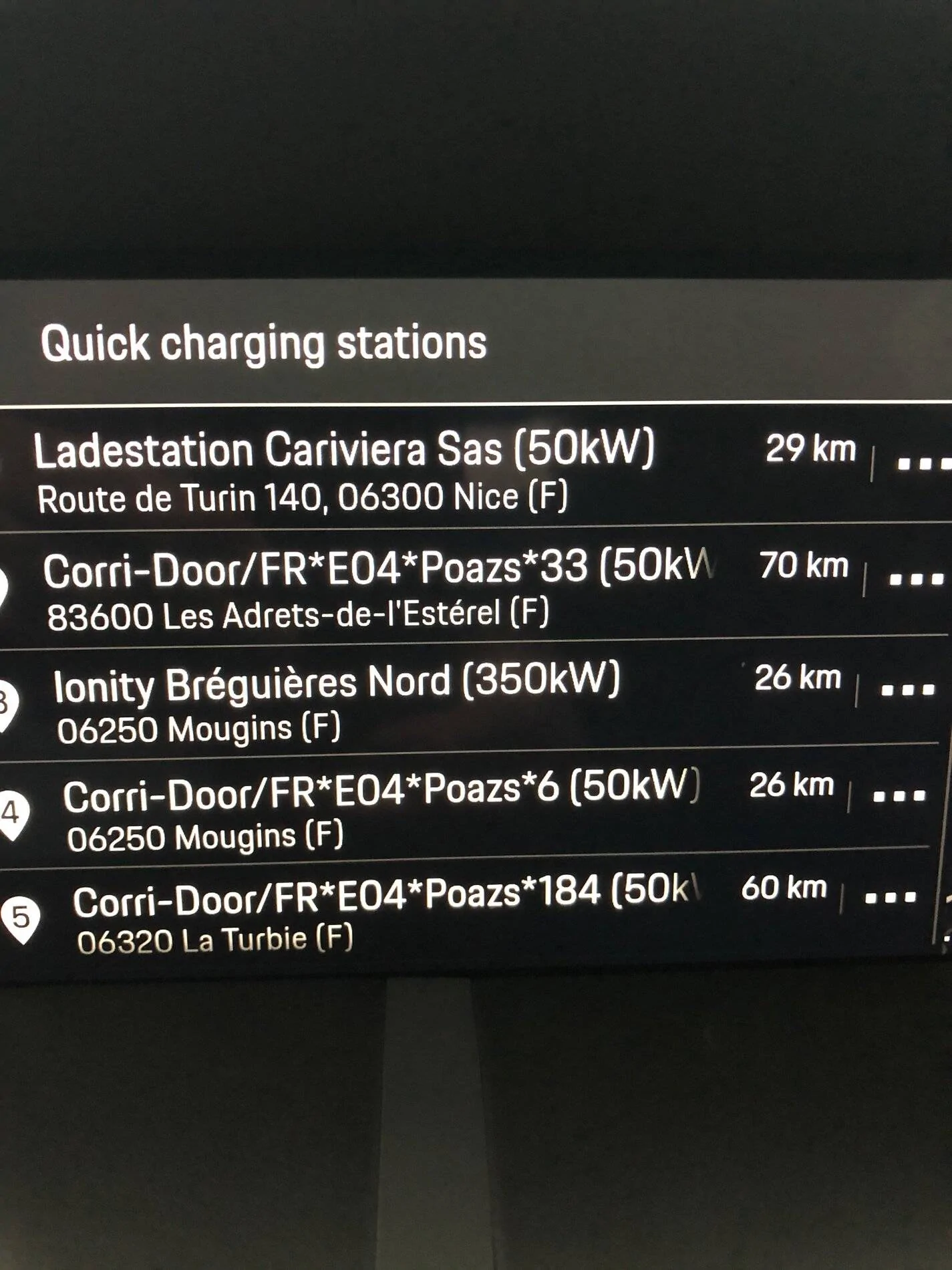

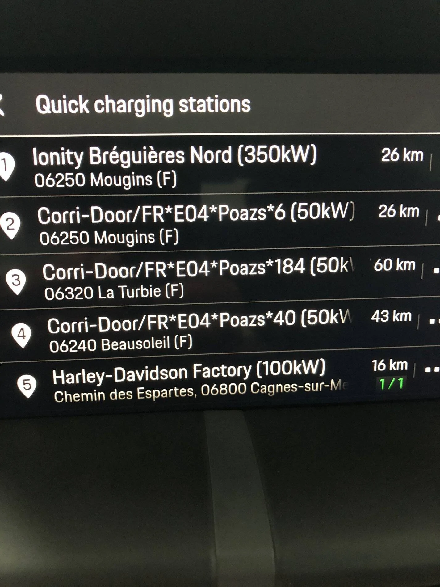

You can sort between Porsche Charging Service and Quick Charging stations. Picture beloW.
Quick charging stations are all above 50 kW and shows a few on the photo. Problem is the CorrI-Door chargers that are listed have been out of order for 6 months. There was an incident with that manufacture product and all needs to be changed. But the Taycan will happily guide you to that one. Other EV Charging apps will not!
Porsche Charging Service will then bring up all the others around. The ones in the picture are all described as 22kW chargers ( car will only charge at 11kW) but it is not correct! They are between 3 and 7 kW.

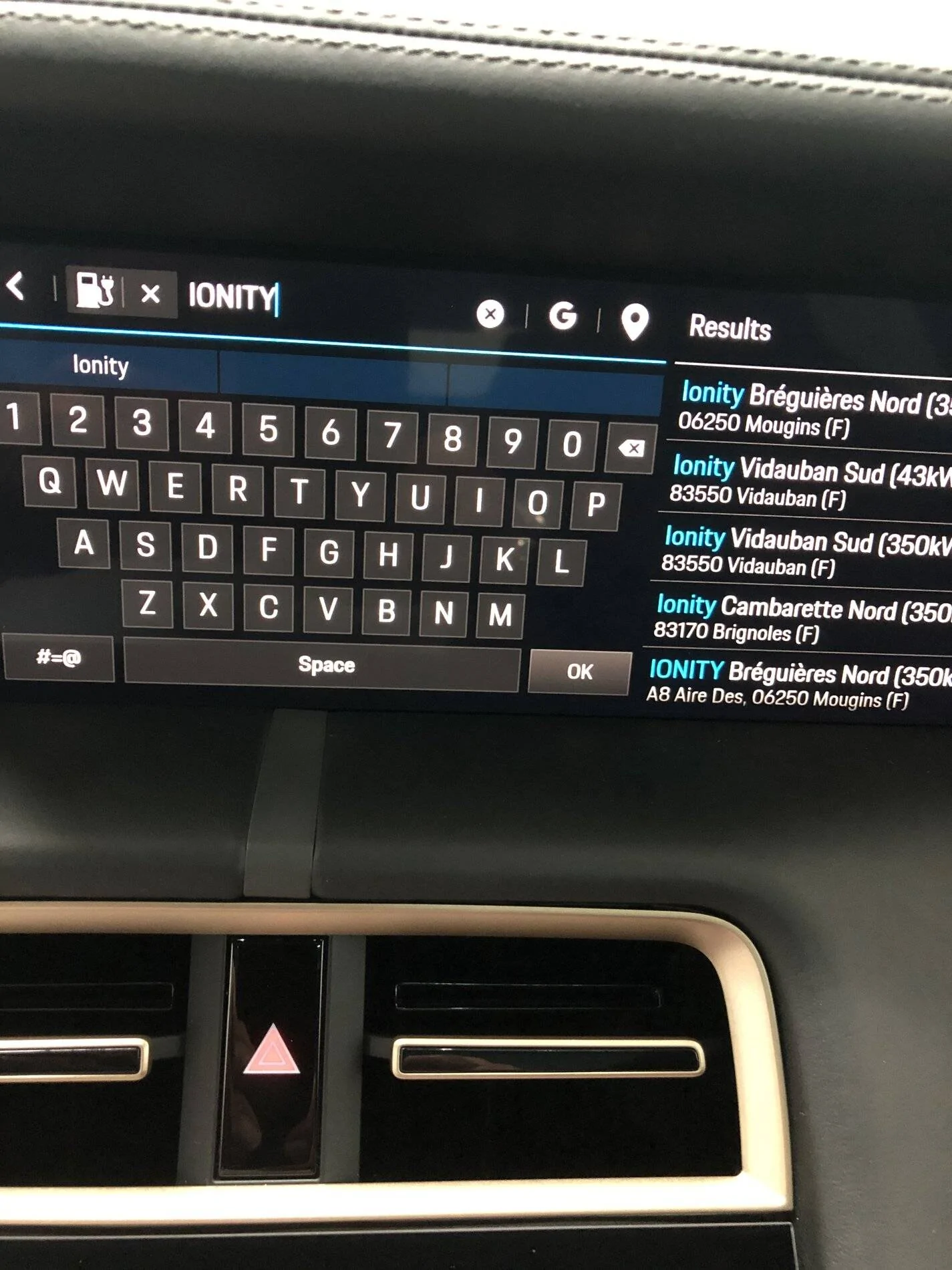

You can of course then search for Ionity and that brings up what it finds. But the two chargers in Italy on the way up to Switzerland are not displayed or listed!
