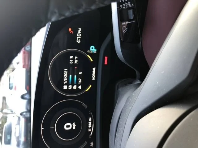

In one image the battery temp is over 100 deg. F after charging. IIRC, optimal temp is 85 deg. F. I have no idea the optimal range, but there has to be some upper limit where if the battery is too hot charging is reduced to protect the battery chemistry. Could be indicative of a problem with the battery cooling system (louvers, fans, pumps, etc.) but I would expect an error code in this case. So temps may be just fine. Anyone have experience with charging rate vs. battery temp?
Like @porsche_coyote said, higher temperatures are not so bad below 120F. The car will heat battery to about 92F when routing to a charger. Then high speed charging will of course raise it.
See chart at start of this thread, I know it only shows up to 95F but I take this chart as a temp at start of charge statement, not a temp during charge.

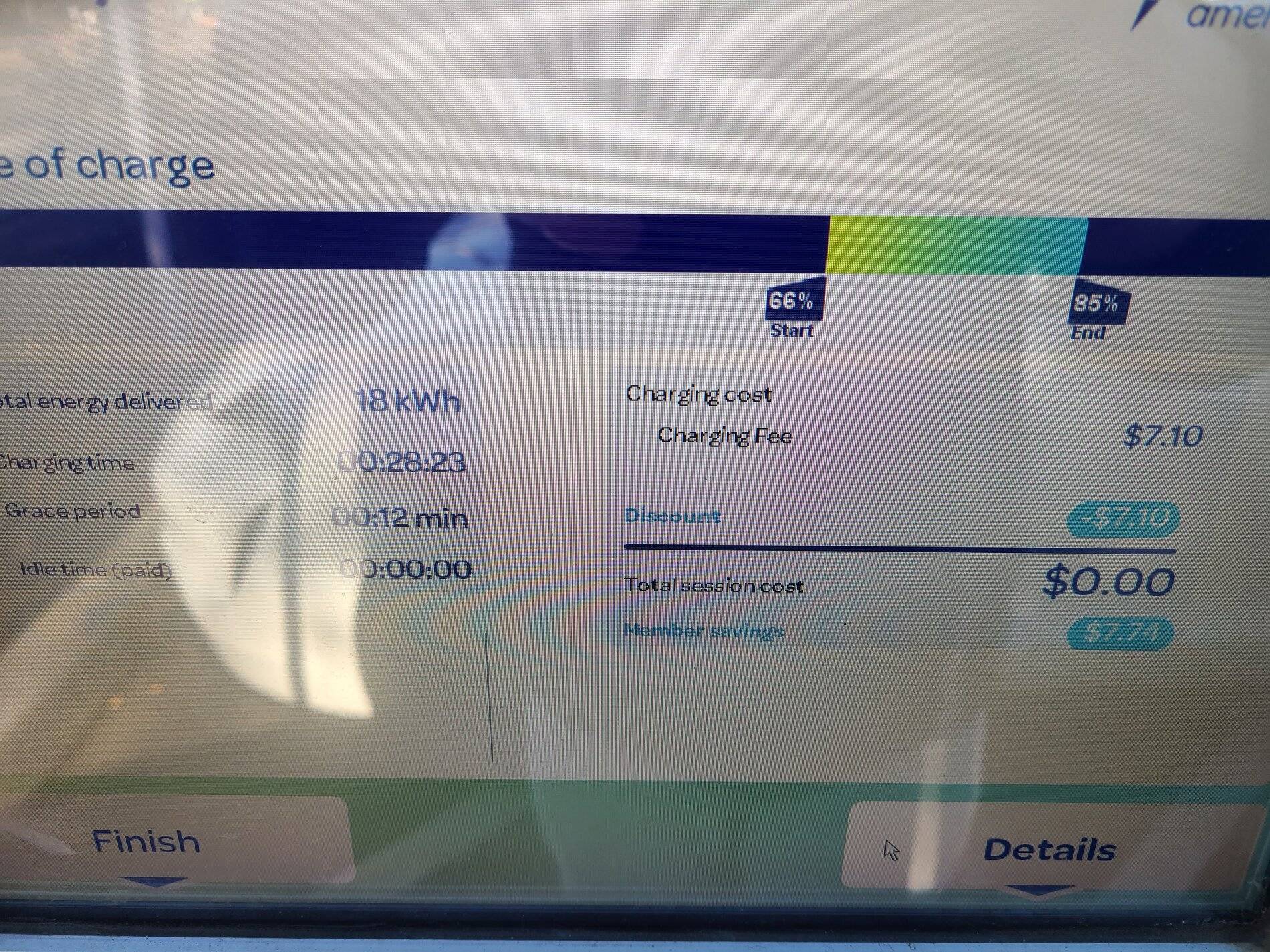

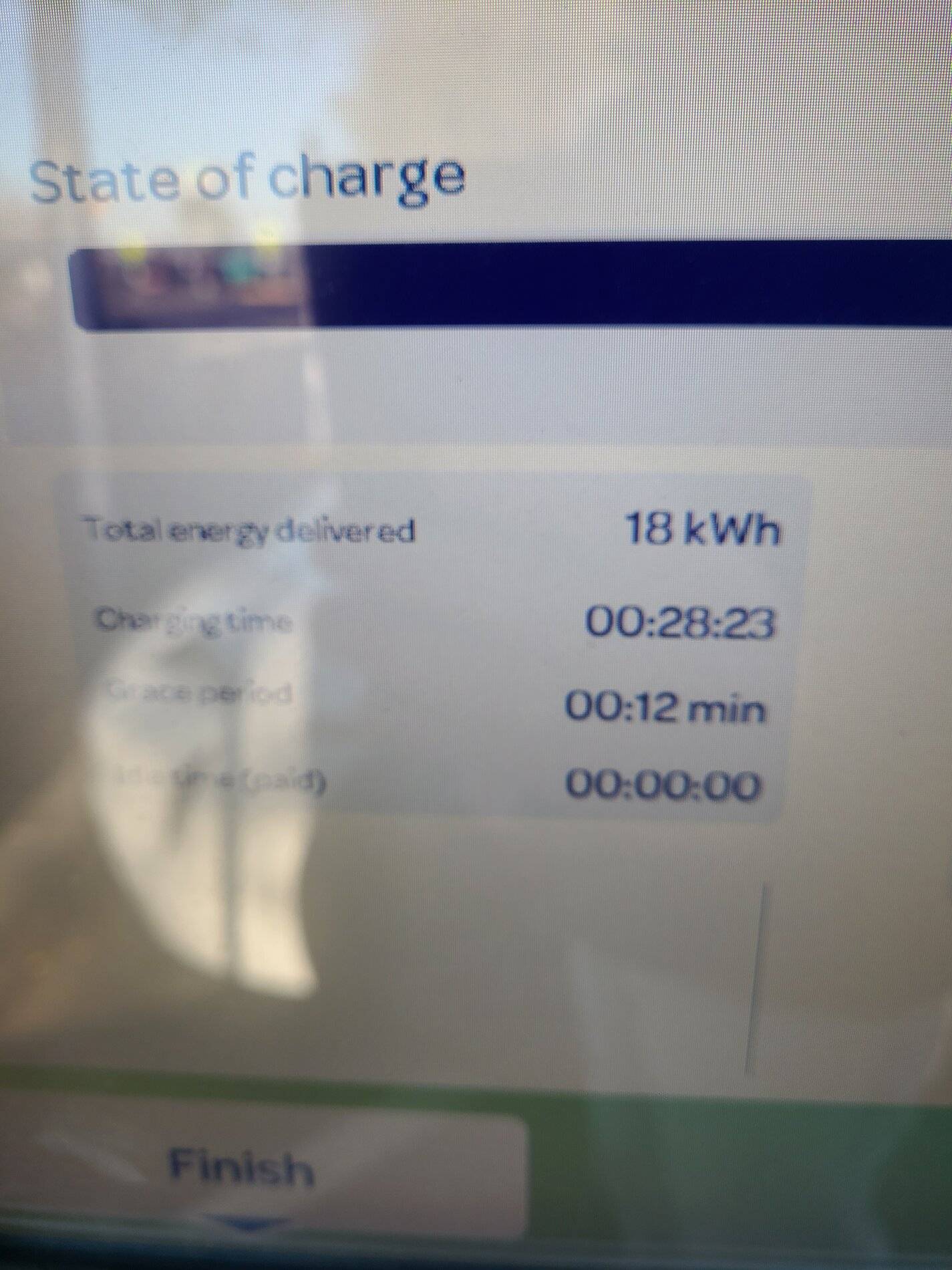

One more data point.
- EA station rated 150kwh. I was the only one charging on site.
- Exterior temperature 10C (50 F). Battery temp 12C at beginning of session and 19C at the end.
- Starting SOC 66% ->SOC 85% in 28 minutes, total 18Kwh added
If you do the math then the average charging rate was (only) 38kwh. I have documented in a previous post that if I use a 50kwh Chargepoint station with same temperature and SOC then I get a steady rate of 50kwh all the way till SOC 85%. So the slow rate is because of the charger.

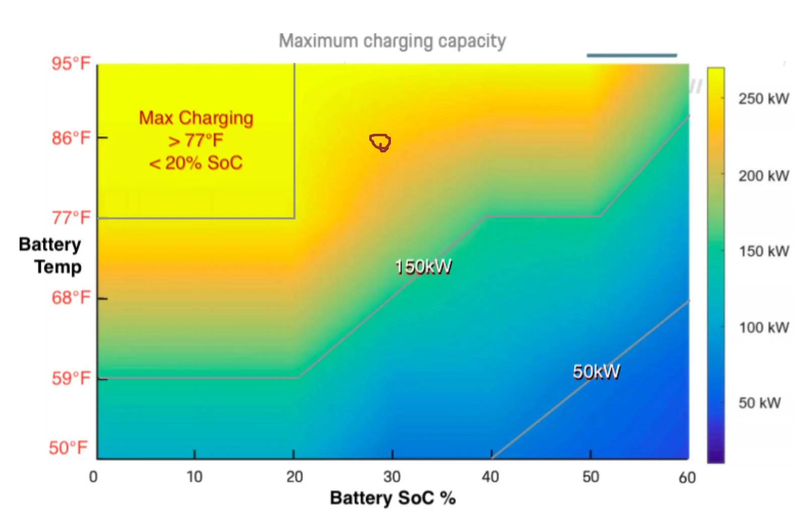

I charged my car yesterday at a 350 kw Electrify America station and got lower than expected charge rate. The conditions were as shown on the chart and I expected up to 150 KW. Instead I got 80-105 max. The car was at 24%, OAT was 28 F and battery temp was 88 F. Does anyone have any ideas as to why it didn't charge at 150kw?
Chuck J
Porsche Taycan I ask and answer: Why won't my Taycan Charge as fast as I want it to? Taycan charging temperature profile2

Sorry, Andrew were you answering my question about why I was only charging at 80kw instead of the expected 150 kw given the circumstances?
Chuck J
160
5,811
8,649
everyone needs to keep in mind that sometimes it’s the external charger that is the limit - even chargers that are “rated” at higher charging rates are sometimes limited during a particular charging session by available power, conditions, recent activity at the charger (depletion of any onsite power storage for example).
as I’ve said a number of times there are a number of conditions that must align to achieve the optimal charging rate…
my guess is that while your battery temperature was “in range” the ambient air temperature of 28F played a role…and the charger may have been running at a reduced rate for reasons we’ll never know.
Chuck J
There are several threads that cover this more extensively, but the short version is that battery temp and initial state of charge are only two of the factors that contribute. There are several smaller factors, such as ambient temperature, that may influence the actual charge rate but most significantly are variables of the equipment themselves. Just because a station may be rated for 350kW doesn't necessarily mean that it has the capacity to deliver it - there may be fluctuations or curtailments on the power delivered to the station itself (some of which is mitigated by local storage at some EA sites) or it may be that there just isn't enough power flowing to the station to maximize delivery. Also, the equipment itself may have limits and throttles due to temperature or other operational factors. Getting a magic 270kW charge rate requires a number of stars to align, not all of which are transparent.
It's worth noting that this isn't unique to EVs; there are wide fluctuations in the rate that a traditional gas pump can deliver fuel, for example. We tend not to notice it as it generally only amounts to a few extra minutes, but the fundamentals still apply: The rate at which a car can receive fuel is only one component in the ultimate rate of fuel delivery.
Chuck J
Great question, I too had experienced low charging sessions when the battery was at a optimal state. I've never been in that cold of conditions though at best was I think 45F and usually 55F.
I would suggest you Electrify America and report the problem, they can track what cars have been charging at at their Chargers and determine if there is a issue with the charger. I have had repeated substandard sessions from a charger in Soledad whereas in Paso Robles I have nearly 100% success rate at full expected power. I have repeatedly submitted problem reports for Soledad in hopes that they will look into it.
That said I do also agree with what Dave said about the ambient temperature affecting the charger.
