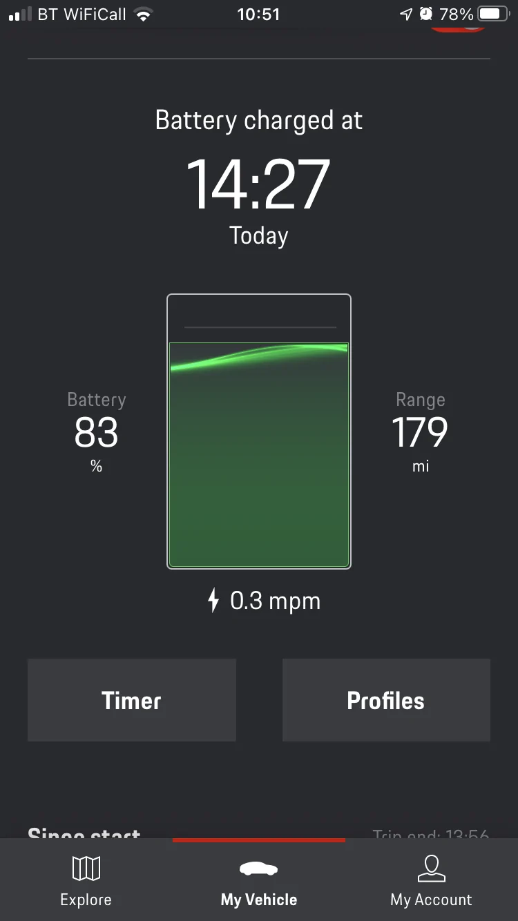

Hi, finally got my Black metallic 4S this week! Tried first home charge via recently installed Anderson (single phase) and I’m currently getting 0.3miles per minute charge at 6.9kw - just after some advice; is this as fast as I can expect / working correctly? Many thanks!

Have you tried tapping on the 0.3 miles/min to see the KWHr charge rating? What charger are you using?
0.3 miles/min, assuming maybe around 2.7 m/KWHr (depending on driving style) implies you are charging around 7KW/hour, so it lines up.
Yes - showed as 6.9kw so does roughly match - thanks for confirming

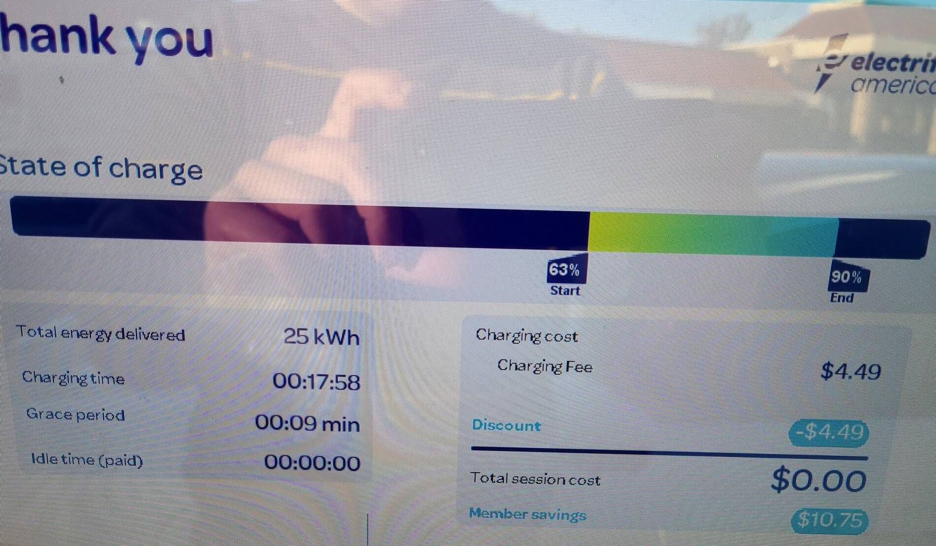

Today I tried a different EA location.
SOC 63->90% by adding 25kw in 18 mins. That is an average of 83kwh.
That is much better than the rate of 38kwh I usually get at the other EA location (see previous post) starting at same SOC.
Btw there was a homeless person sleeping next to the charger. Some EA locations do not feel very safe for parking such a luxury car and staying in it while charging.
Can you please share the location of this EA station? I am in Northern CA (SF Bay Area) and am collecting info about the better stations. BTW, for those in the Bay Area, I had a horrible first charge experience in my 2022 GTS at the 1334 Saratoga Av station where my car would not charge at any of the 150kW stations and I thought there was something wrong with my car (there were other cars that were able to charge) but the stations at Westfield Valley Fair mall worked great.
