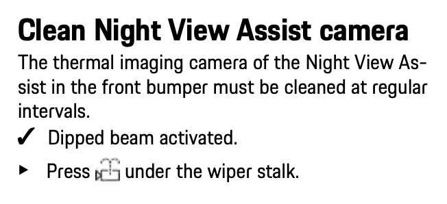

I have a missing feature.
The NVA camera under the bumper has a washer nozzle pointed at it, and in the manual it says there is a button under the wiper stalk.
There isn't a button on the stalk in my car, only the outline of where an opening would be molded for a button.
Anyone with NVA have the cleaning button?
I will have to check the online manual. However, the front camera and NVM camera should be sprayed when you spray the windshield. I will sure try that when I am washing my car but not at this time as I do not want to spray the windshield.

The rear camera on a Turismo gets washed by pushing the windshield wiper stalk forward. Took me a few to figure that out since all the videos are of sedans and they have an on screen button. I didn’t know I could wash the front camera. I’ll try it, that’s a dirty dirty bird.
Query is specific to the optional extra Night View Assist - this is an additional infrared camera located next to the ACC radar dome. Repeated use of the fronts windscreen washer activates it.
I recognized that, are you saying it doesn’t apply for the standard front camera too?

The standard front camera in the windshield is partially washed using the windshield wipers, but the optional front bumper cameras and radar have no washer nozzles.
Front park assist camera is standard (wasn't on MY20 at launch oddly).
