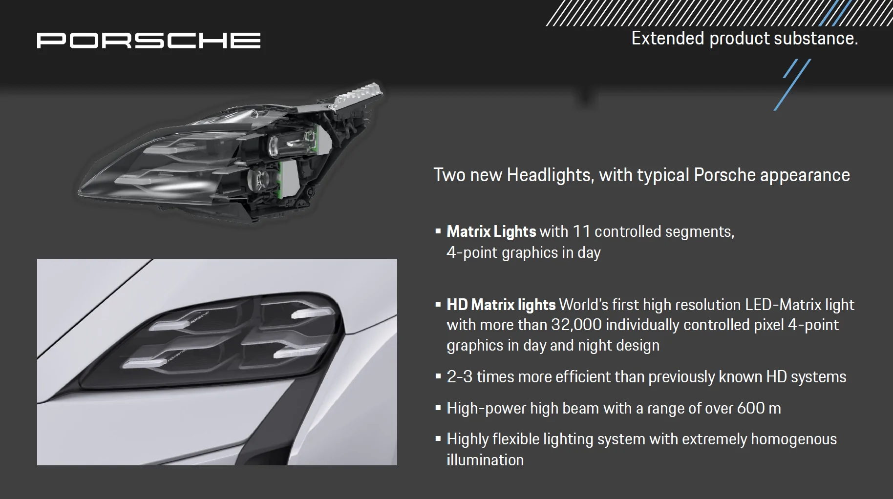

I just want to note, let's not confuse the lights for J1.1 only options were LED and Matrix LED (both having Auto High Beam as standard but Matrix version only having PDLS+), for J1.2 you have Matix and HD Matrix (only HD Matrix has PDLS+ with swivel) - see below. Interesting enough Macan EV is not offered with HD Matrix (32,000 elements), but rather the setup similar to J1.1 Taycan with options being LED and Matrix LED (same 84 elements).
Bottom line: OP has everything matching the build sheet for J1.1 2024 model for Canada: Surround View 2D only and Matrix disabled, although the lights are Matrix LED. Case closed!

Both matrix options are offered on the current J1.2 Taycans - standard are the "Matrix" and optional are "HD Matrix". In each headlight of the HD Matrix option there are 2 x 32K pixels (64K total) - it is impressive but pricey.
Full beam remains on with both matrix options (purpose of PDLS+).
