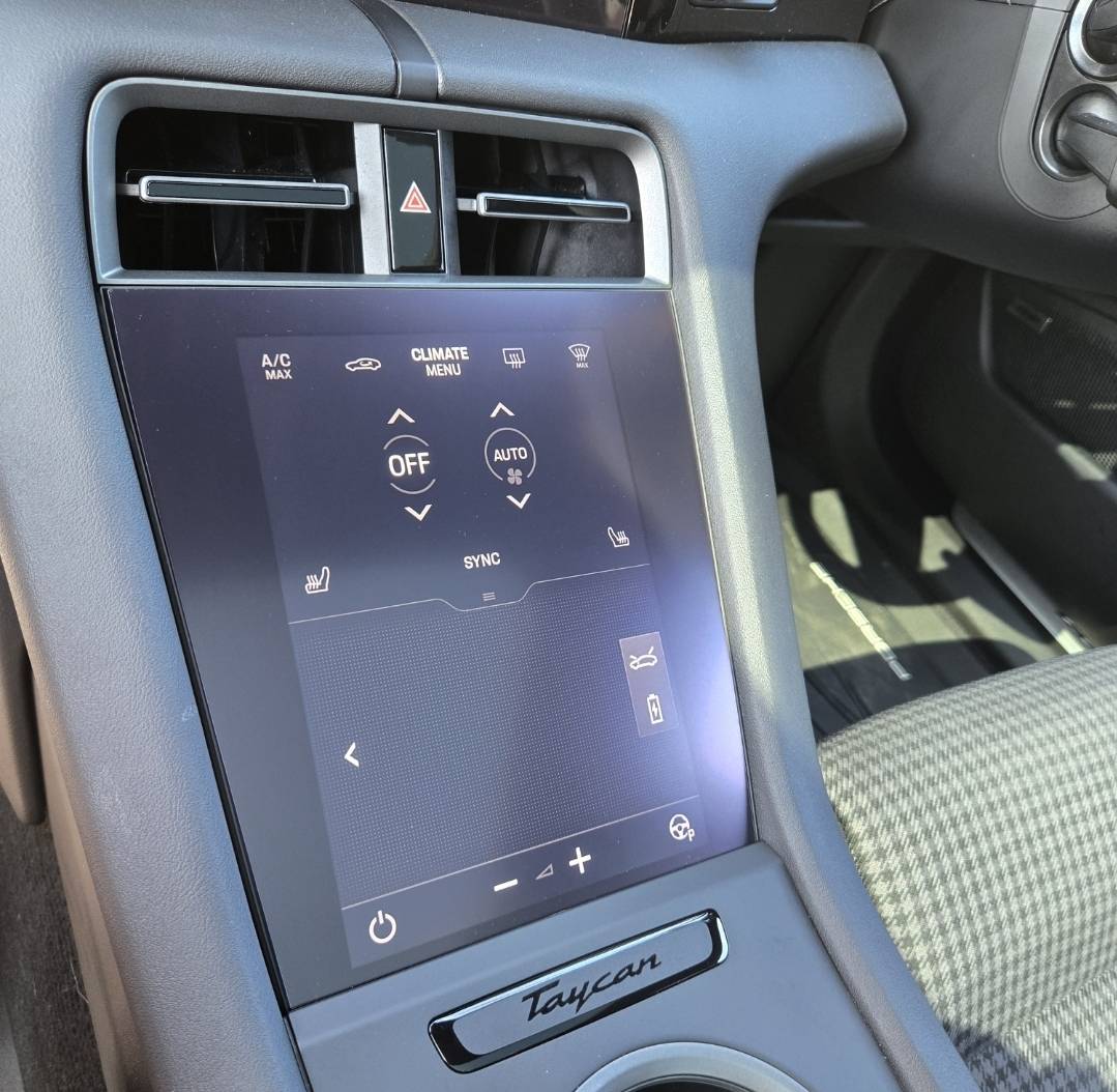

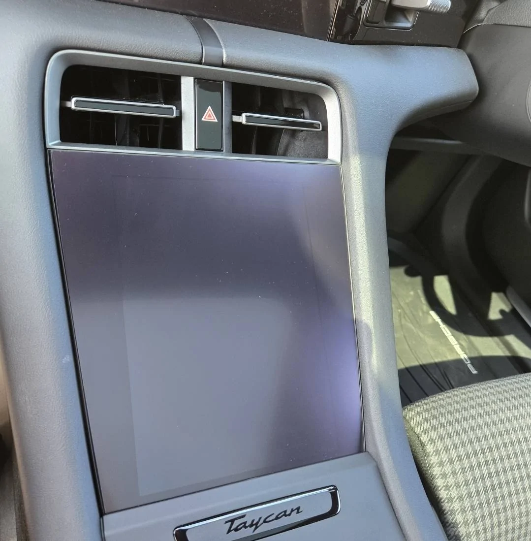

I installed the three-piece Screen Protech last week. Get the anti-glare one it’s almost anti fingerprint. You do need to turn up the screens brightness as films dim the screen a little bit. $78.47 USD total. I say it’s worth it XD

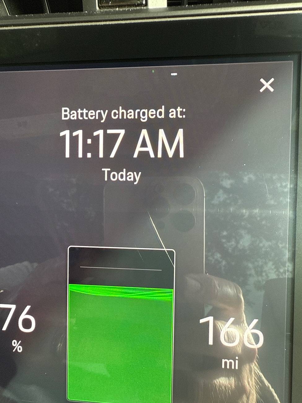

This is deep enough to catch a fingernail.
Is this screen plastic or glass? Do you think it can be polished?

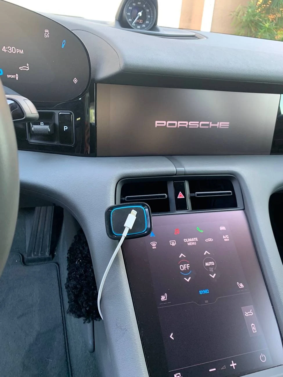

@DerekS - I was trying a magnetic phone holder that mounted to the left side of the screen, but periodically my hand or knee would dislodge it and the iPhone would slide across the screen, and each time made slight scratches. I didn't notice the scratches right away, but when I saw them my heart sank and I took the phone holder off and began researching how to remove scratches from glass.
I found something that worked incredibly well. In fact so well that all my scratches are gone. Here is what I posted at this link and repeated below.

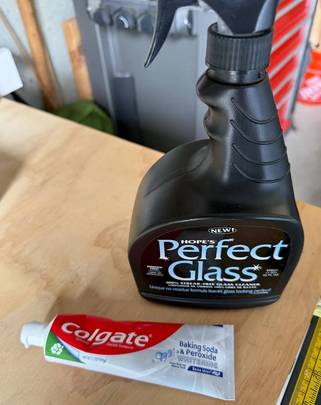

UPDATE #2 -- So I researched how to remove "fine line" scratches from glass, and found this approach --
Toothpaste Method
  • Use plain white toothpaste, preferably one with baking soda or formulated for whitening (avoid gel types).
  • Clean and dry the scratched area.
  • Apply a small amount of toothpaste to a soft, damp cloth.
  • Rub the toothpaste into the scratch using small, circular motions with gentle pressure for about 30 seconds.
  • Wipe away the excess with a clean cloth and check the scratch. Repeat as needed until the scratch diminishes or disappears.
Works like a charm. Here is what I used as toothpaste, and for follow-on cleaning. Also, I worked on the screen from the passenger's seat so as not to cause the screen/car to turn on.
