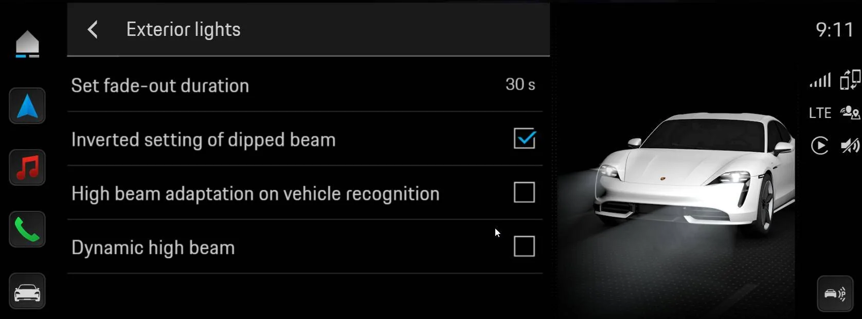

Headlight beam can be redirected

Matrix headlights - jury is out on that one.
