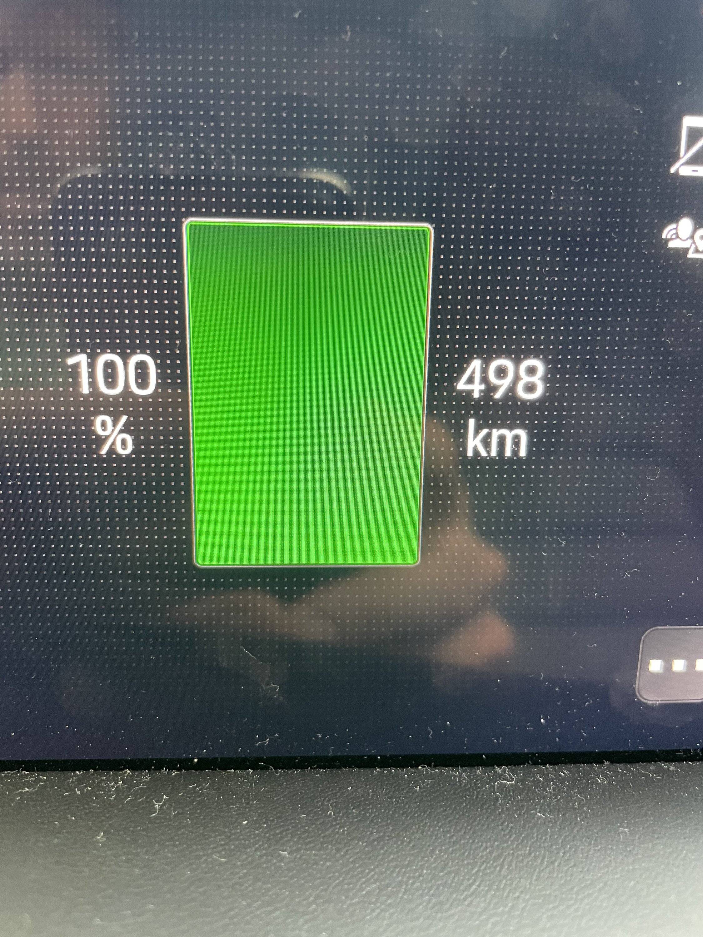

Got a new guess-o-meter record in my car after the update (2022 CT 4, dec 21 build), first charge to 100% in quite a while:
This gives hopium, my update is 9th of Sept. Now approx 400 km.
