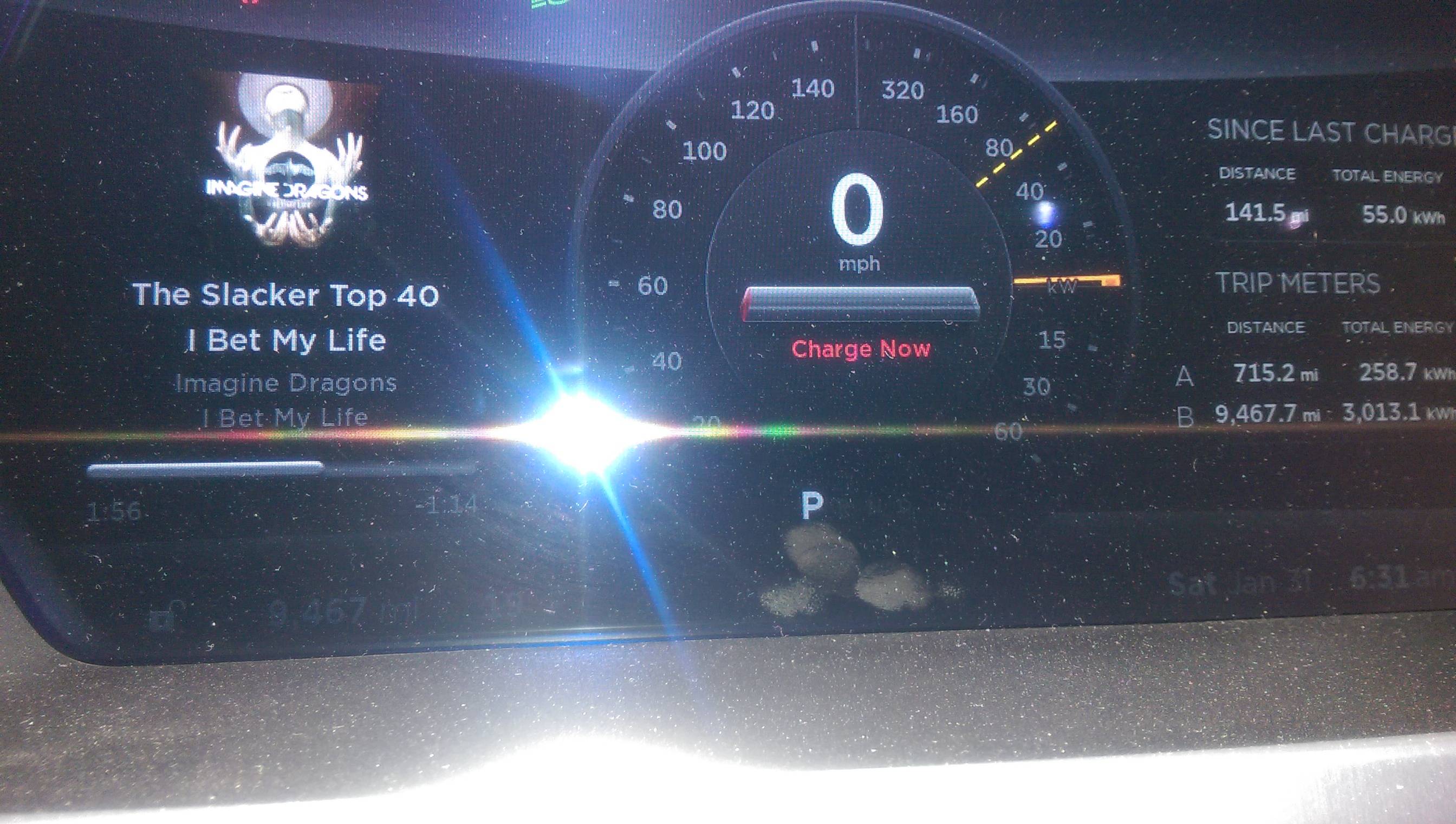

to your point, the first time I encountered cold weather I parked my tesla with about 42 miles of range, ambient temps were about 15F overnight and I awakened to a car with about 18 miles of range and the supercharger was 24+ miles away. fortunately I am an early riser and at 5 am the highway wasn't very busy so I could nurse the car along under 40mph. this is what it reported about a mile from the charger, I did make it to the charger.
