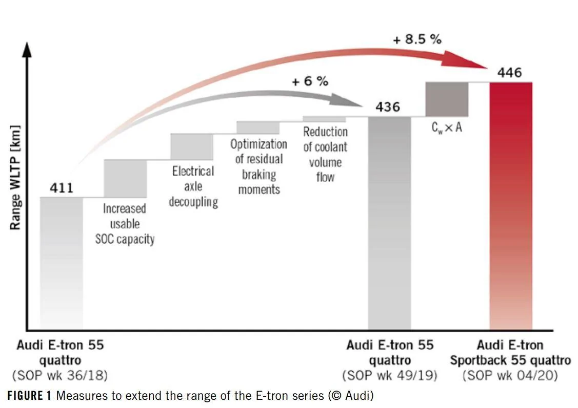

that update is technically based on the changes from MY2020
Porsche Taycan Increased range on older models from big update? 1660131028585
At the end of 2019 the Audi E-tron models were being upgraded in various ways, including by measures to extend its range. The key points are briefly summarized below and in figure1 (values refer to the WLTP).
The battery's usable State Of Charge (SOC) capacity (usable capacity in %) was increased from 88 % to 91 %. Extensive tests have proved the robustness of the battery system. The increase in usable battery capacity is realized in full compliance with high quality and durability demands.
In low-load driving, the front axle drive of the Audi E-tron is now decoupled fully electrically, meaning the power electronics no longer pulses current into the electric motor. The reduced energy consumption improves the efficiency of the vehicle. This measure could be implemented by means of optimized power electronics functions with no loss of comfort or agility when reconnecting the electric axle.
The reduction in residual braking torques on the wheel brakes and the optimization of the brake disk cleaning function deliver benefits in terms of range.
The highly flexible thermal management has been further optimized. This has made it possible to further reduce both the volume flows in the coolant circuit and the power consumption of the coolant pump.
The range of the Audi E-tron SUV is thus increased by approximately 25 km (6 %), compared to the initial launch. In the Sportback variant, the better drag coefficient additionally provides about 10 km more range in the WLTP.
