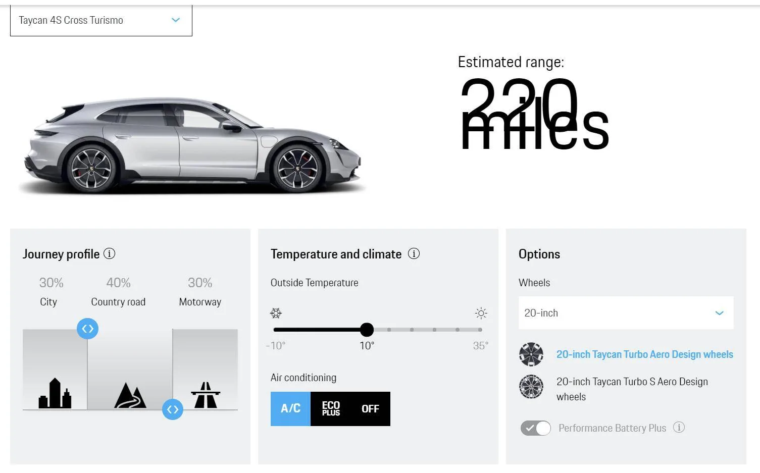

My CT 4s is sat outside ATM with 85% charge on it - range is showing as 186 miles - thats going to equate to 219? My M3P would show 300 miles at 100% but would typically get 265 in reality. The Porsche is miles behind. See attached screenshot from the range calculator. The range on the calculator increases to 240 if you select ECO plus but thats how my car is currently setup and the range is still more like the 220 shown.
