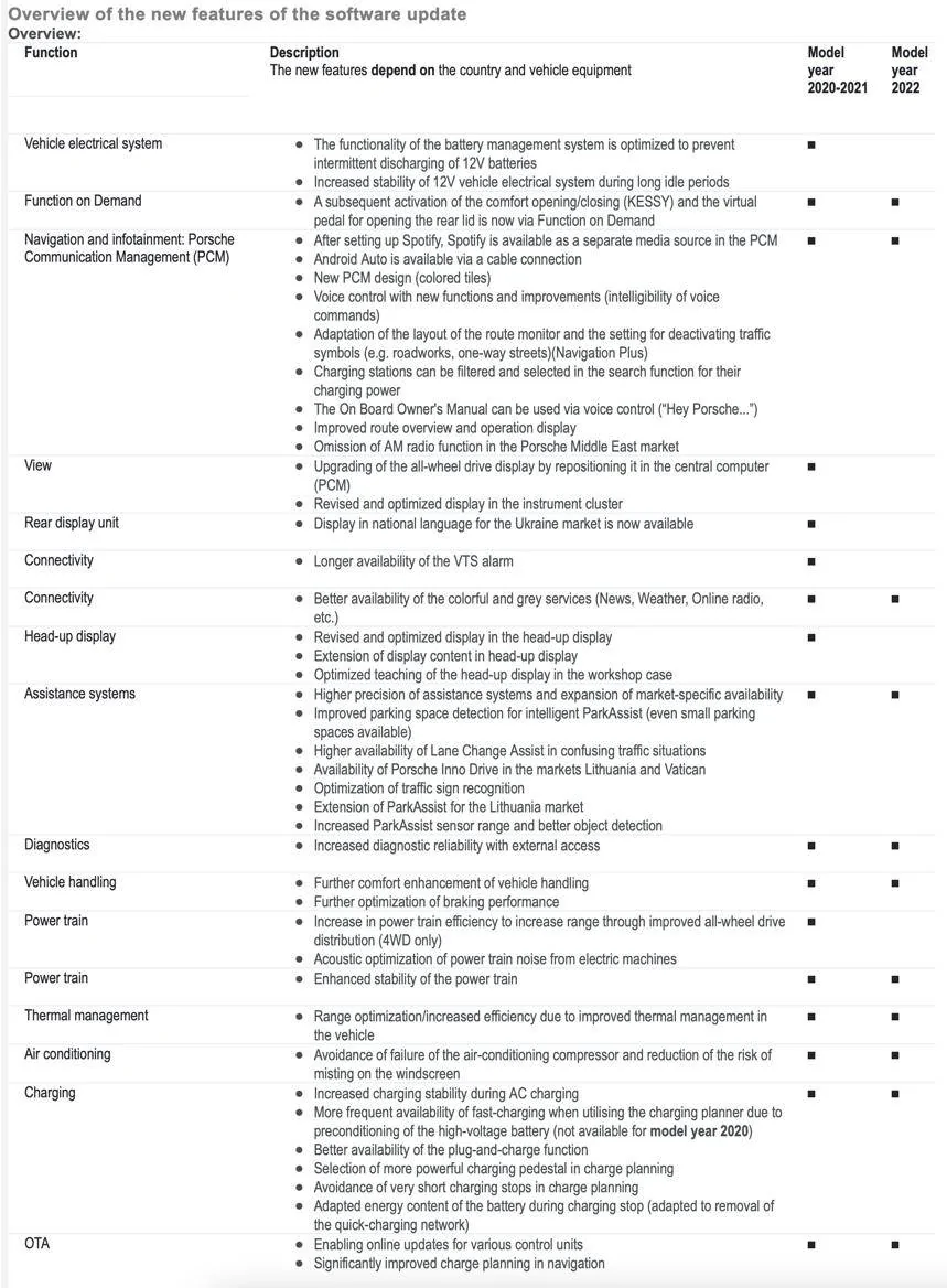

and 2500 kg (weight of Taycan) = 2500kg.
Now… how could (entertainment) software extend range, ie. change kgs or kwhs?
Because the major software update also includes improved battery management software that's supposed to improve battery usage and efficiency for improved max range.
It's more than a simple infotainment update, I don't think you read all the information and only focused on the parts you considered important to you.
I read the whole list, but I’ll wait & see….if there will be any difference.
