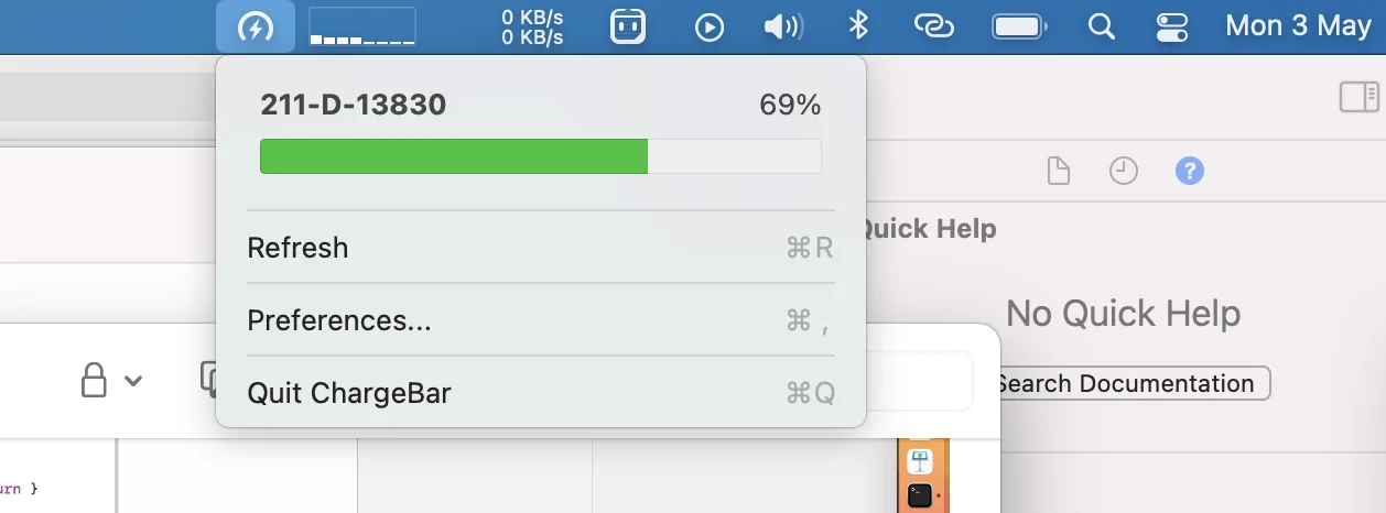

It scratched my own itch – in that I wrote myself a macOS app that I call "ChargeBar" that shows the current battery level of my car on my toolbar:
Porsche Taycan Interested in an unofficial Apple Watch app? No Quick Hel
211-D-13830:
Porsche Taycan Interested in an unofficial Apple Watch app? IMG_0534

If one of them happens to be https://github.com/driven-app/porsche-connect – then do please let me know how you get on with it. I'm struggling to find time to improve it!
