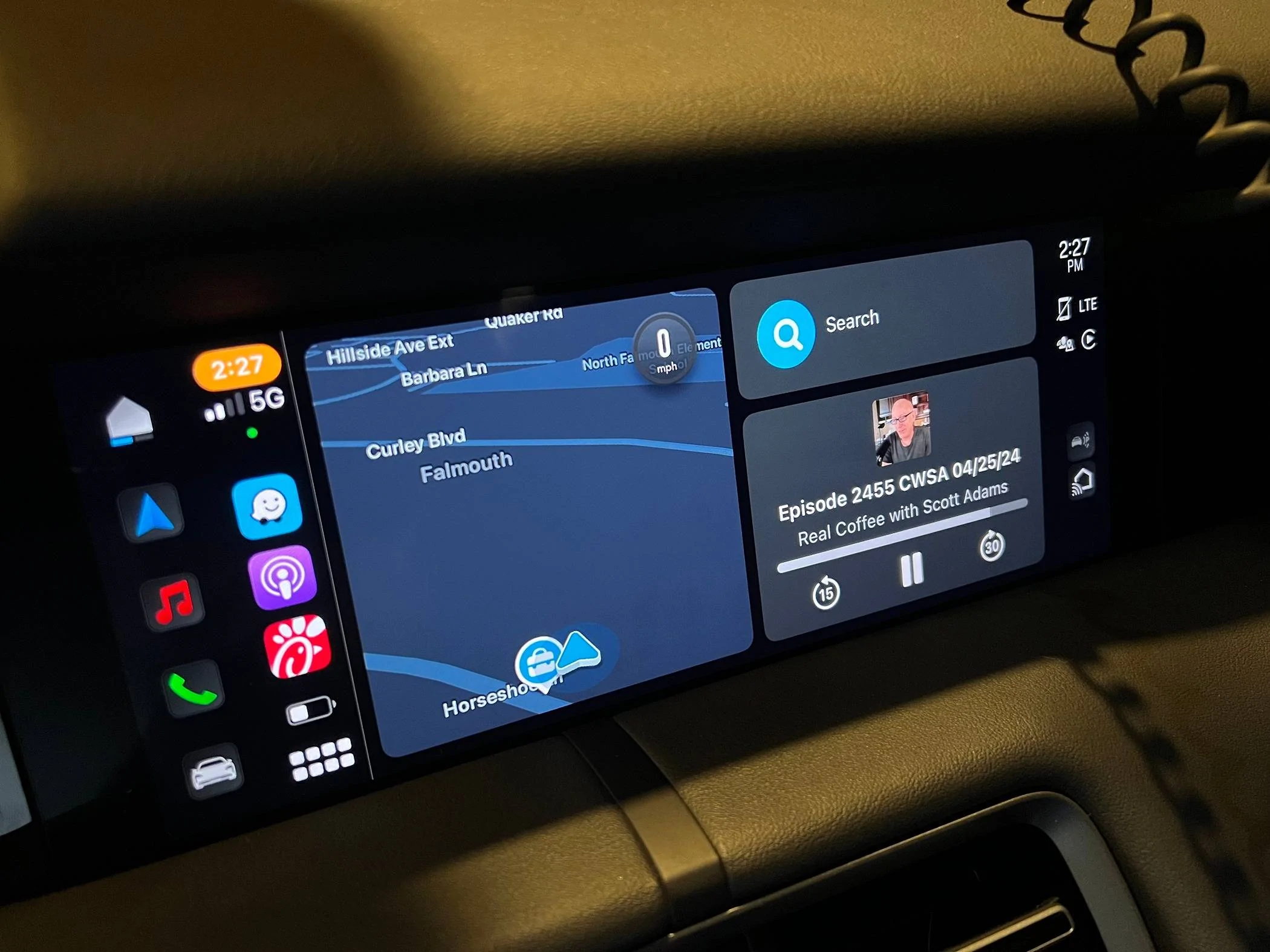

Looking forward to the live CarPlay trip graph.
My screen is already taken by Waze/Podcasts, but if it could do split screen with Waze while Podcasts runs in the background, that would be good.

The Chick-fil-A app isn't live yet unfortunately.
Ah neat, that’s a cool setup. The main issue is that I believe CarPlay only lets you show one navigation app at a time, and I don’t think there’s a way to just show smaller widgets. I’ll poke around though!
