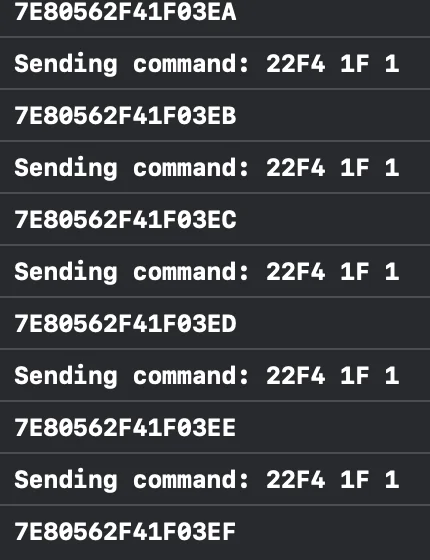

So OBDII has officially nerd-sniped me haha. I'm now about 200 pages deep into ISO specifications and nearly have a basic OBDII library that can read VINs from a BTLE OBDII reader connected to the car :D Feeling pretty promising that I can make something really great for Electric Sidecar with this.

I fell down a deep rabbit hole last night learning about mode 22; have you found any good sources of PID information for the Taycan? I can't seem to find any official bulletins from Porsche and the paid ISO specifications are hit or miss between being electrical diagrams and actual protocol payload definitions.

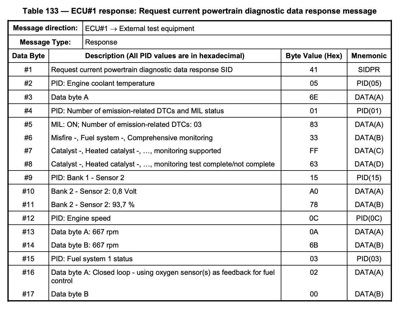

I'm mainly looking for charts like these to help with understanding the data that can be received from the vehicle:
Porsche Taycan Interested in an unofficial Apple Watch app? Screenshot 2024-01-14 at 11.28.02 AM
Charts like these are scattered around the internet and surprisingly difficult to find, even within the paid ISO documents that have poor signal vs noise (/me glances over at ISO 15765-2).
Hear that - was mostly thinking you might ping the CarScanner developer (albeit a potentially competitor situation :)) as suspect likely he has done a ton of legwork by now.

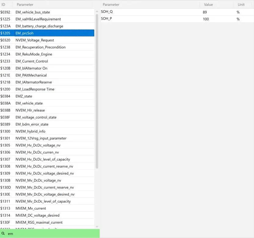

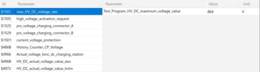

here you go: ECU 8C
Porsche Taycan Interested in an unofficial Apple Watch app? 1705282570629
you want more? specify it and i will search for you. what you need additional is so called calcution formula. i can export all in one shot. lot of data is completly different in just formula output so thats main work - search needed data field and have also the right calc formula for.
ECU C6 Battery Charger
Porsche Taycan Interested in an unofficial Apple Watch app? 1705284232705
in current models the most data is stored in ECU 19 = gateway. here you go, the so called 'holy grail' = SoH

here you go: ECU 8C
Ah I suspect this will definitely come in handy! I'll post back here once I've exhausted what I can poll from the car directly.
