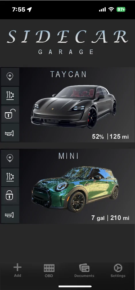

OK I know way off current discussion but it occurred to me as I launched the app a moment ago that it was not at all immediately obvious how to add to or view your garage from the launch page - as the app is clearly now a multi-car ICE/EV app I sketched the following as an alternate app entry page - you'd just tap relevant car to come to it's summary page or swipe left to say delete a car from the garage - have not setup a garage yet in Sidecar, so maybe you already have this?
I like this sort of layout as I can quickly see status/SoC of both cars and tap a quick access button (locate, climatize etc) for either car on one page.
Just musing out loud - you can and prob should totally ignore :)!!

Some solid ideas there! A few of the requests I can see that I’ve pulled in to the Electric Sidecar tracker:
- Being able to register new vehicles from the Garage page.
- Actions on the Garage summary.
- Car imagery.
- Optimize screen real estate use based on the number of cars in the garage.
- Car imagery.
OK - bring slow but just now found the garage under accounts - up to speed!

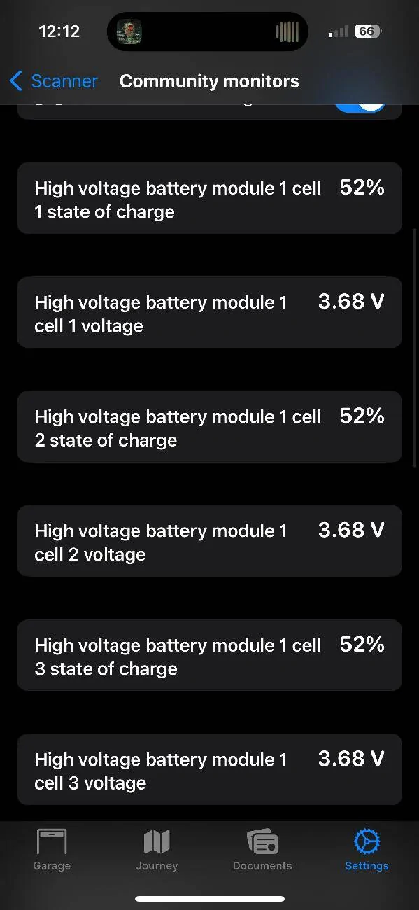

Yessss! First HV battery module now getting decoded from the car:
Porsche Taycan Interested in an unofficial Apple Watch app? IMG_0860
Now to wire up the rest of the modules and then feed this data into a composite card that renders the car's battery pack as a nice visual.
