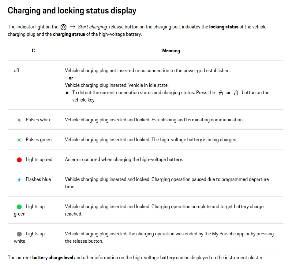

Hard to imagine that replacing the door could effect this. Is it charging properly?
Is it in a strange way blinking? Mine always blinks while charging, slowly and regularly
Speuk
Simon
May 6, 2022
1,161
621
Yep, blinking green shows it is charging.
