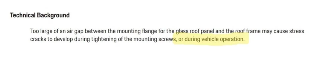

Found a tsb about the crack. The cause is too big of an air gap, whatever that means.
Stress crack tsb
Thanks for finding this but this troubles me even more:
Porsche Taycan Lasted 9 days (Panoramic roof) Screenshot_20230416_201406_Driv
How can large air gap be fixed and this issue can happen during normal vehicle operation even after the replacement?

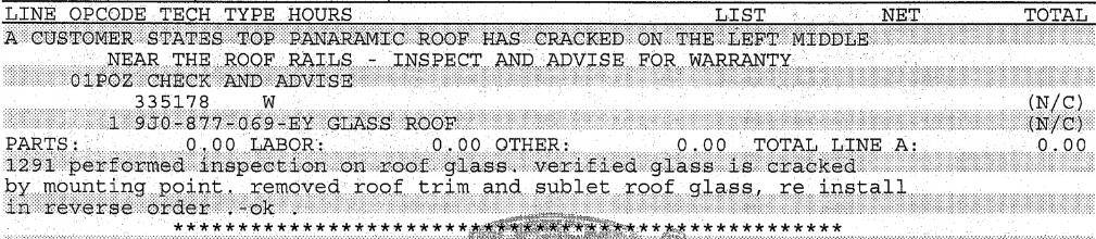

Finally got it back. Took 2 weeks. They said the roof was improperly torqued at the factory. Here's the description of the work order:
Porsche Taycan Lasted 9 days (Panoramic roof) 1682063166994
I took a quick glance at the dealer invoice and the glass roof alone was $5778. Hopefully this is a permanent fix.
Did they replace the windshield?
