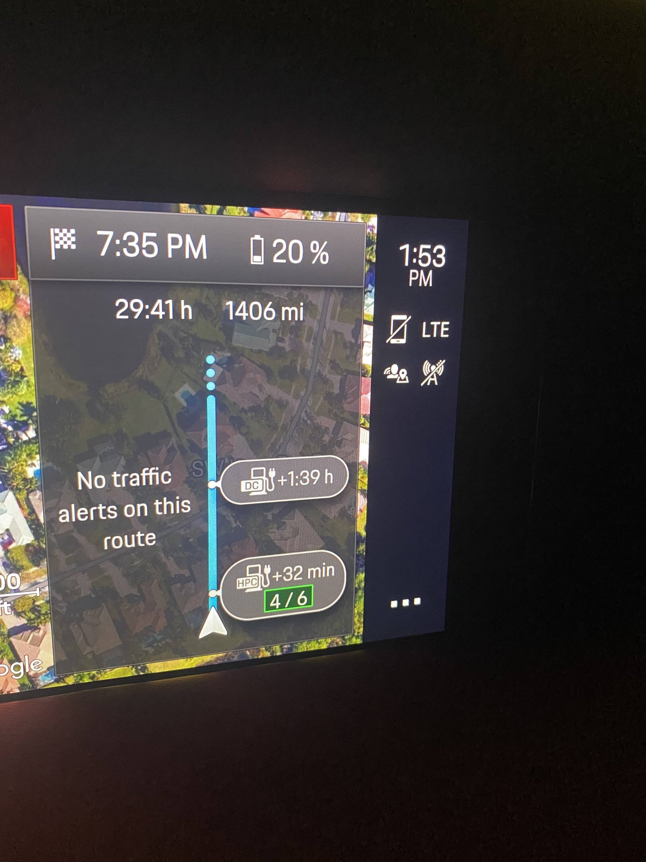

I saw that screenshot posted but for example on my MY2022, where is that button on this navigation screen? I haven't seen that button in the area shown.
Do you have geofence enabled? And are you at your garage door location? Mine only shows up when I am home with geofence.
