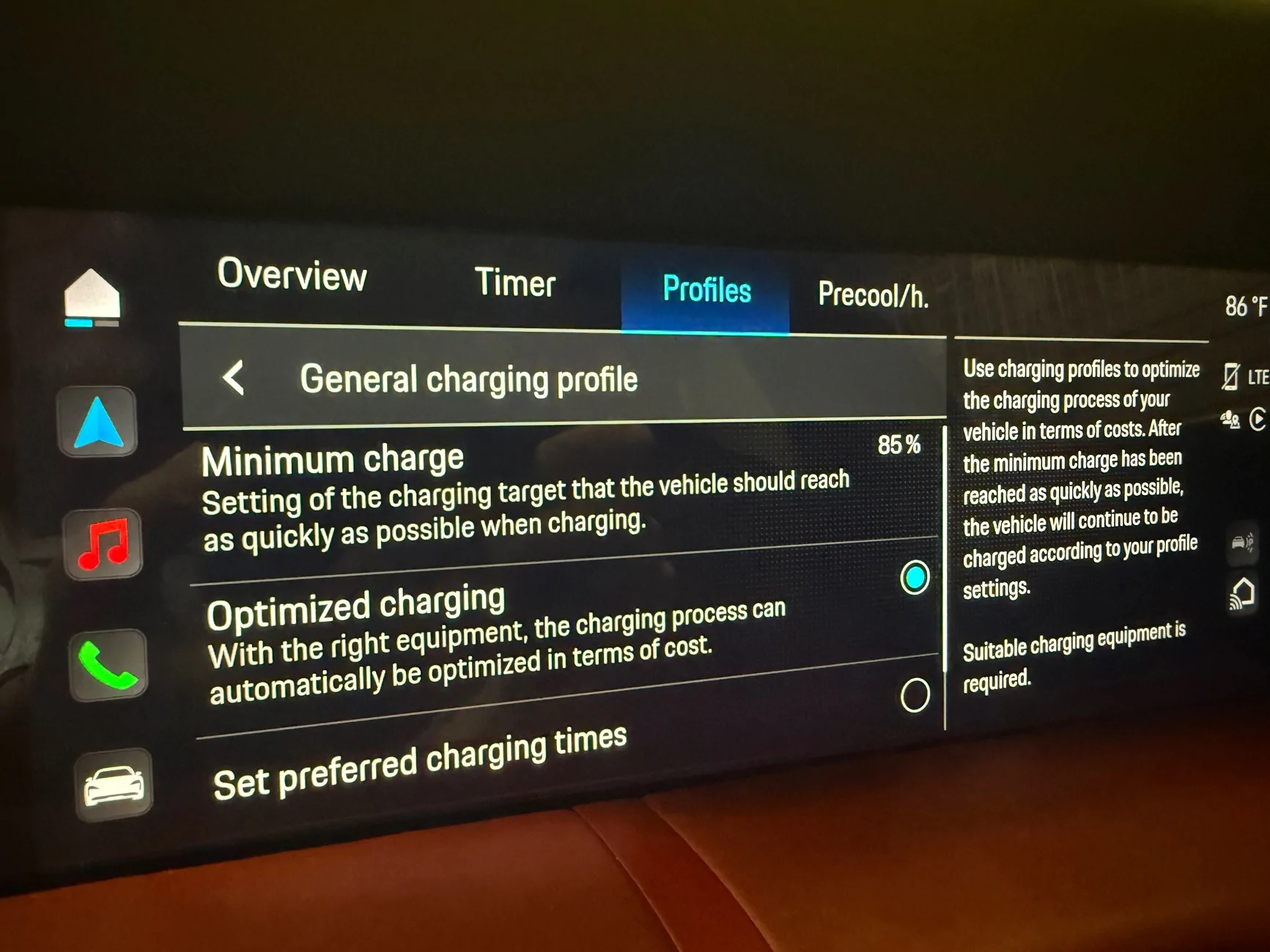

Some of this will be duplication of what others post. Here is my setup, which works very well, and is similar to your requested setup (the times differ a little, but that‘s immaterial).
First, setup your Profiles. The General profile is your “When I’m not home” profile. If you go to a friend’s house and need to plug in, or use a Level 2 charger at a hotel or whatever.
Porsche Taycan Looking for a simple, easy to understand and follow, guide to charge programming J1.1 IMG_4675
Set Minimum charge to 85% and select the Optimize charging radio button. This means, “when I plug in at a non-home location, immediately start charging to 85%.”

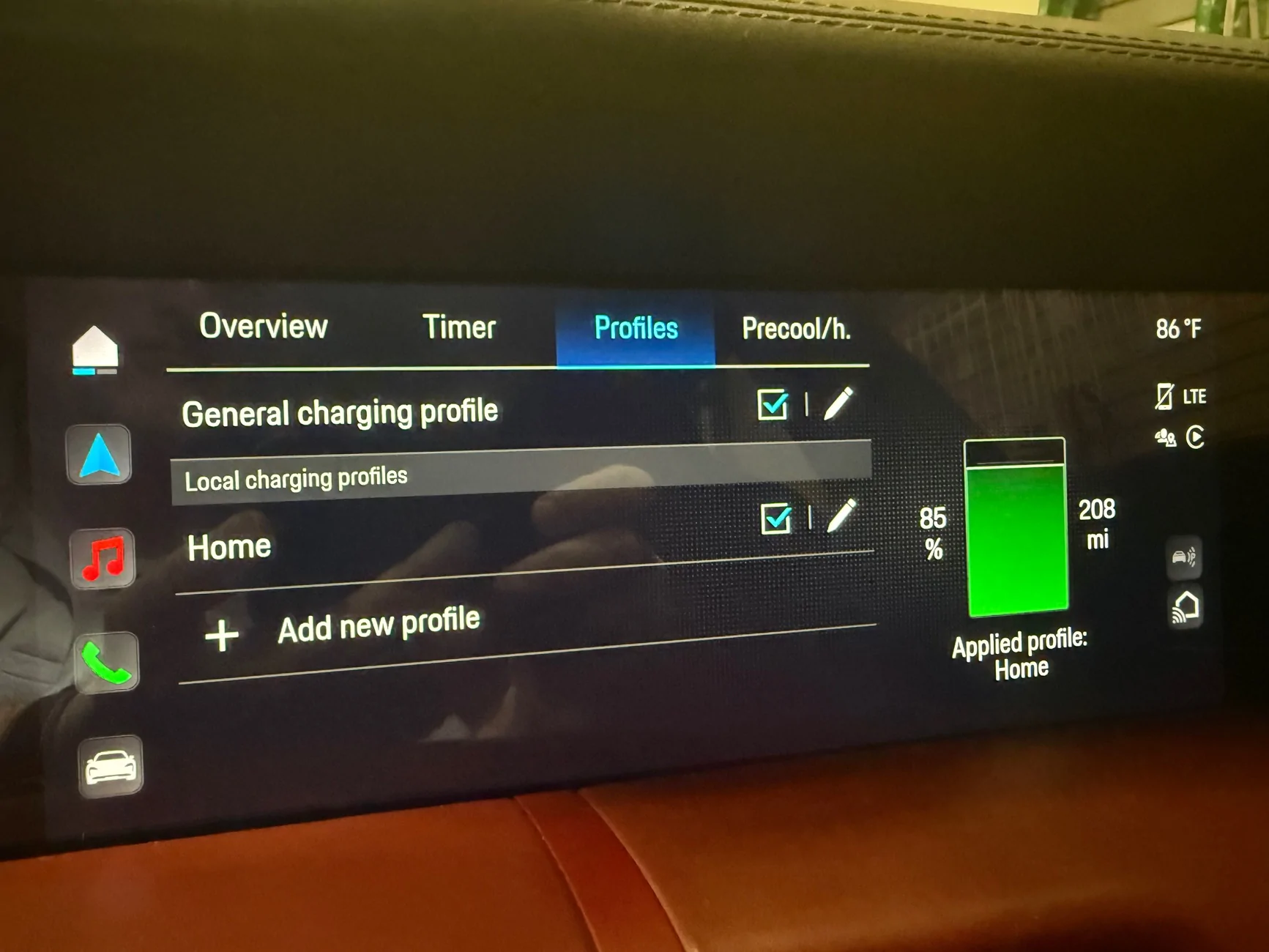

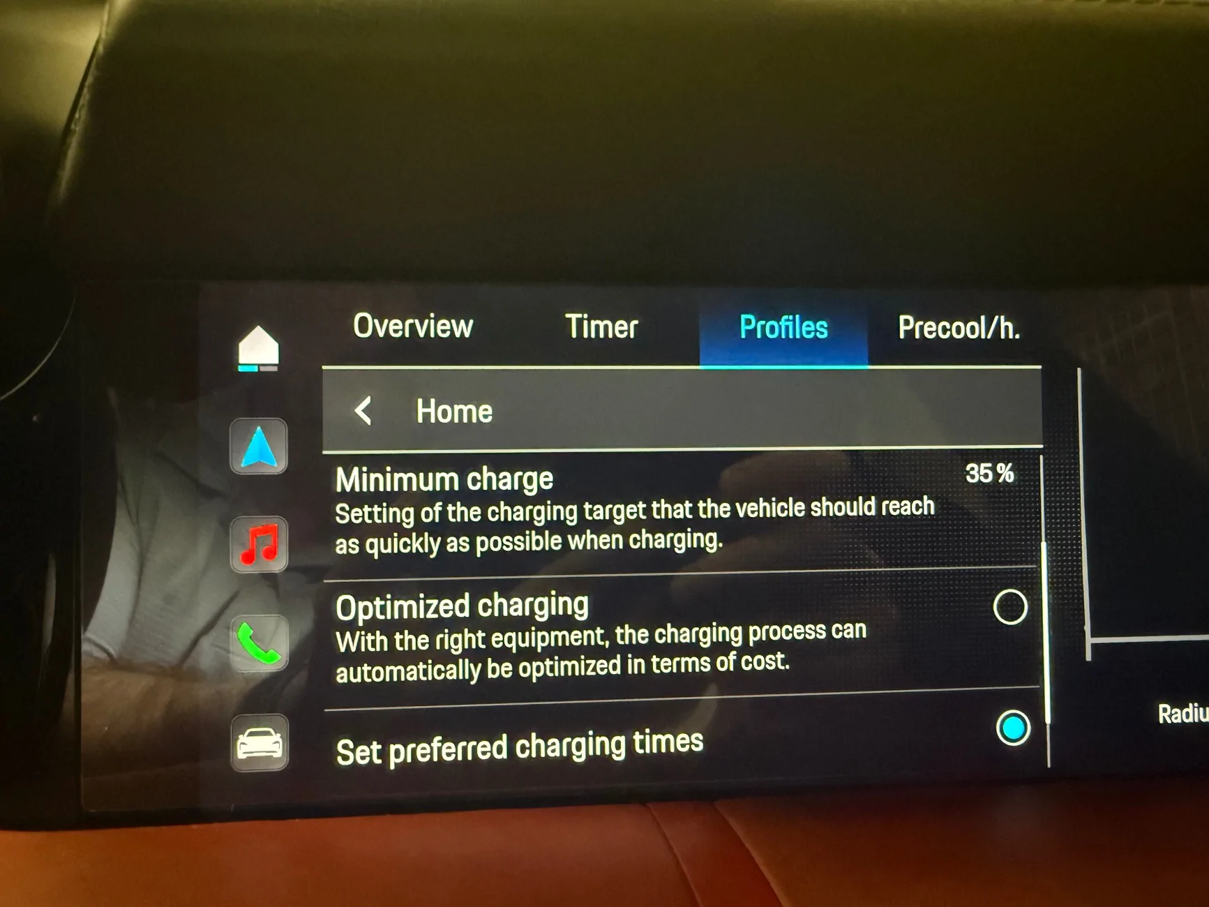

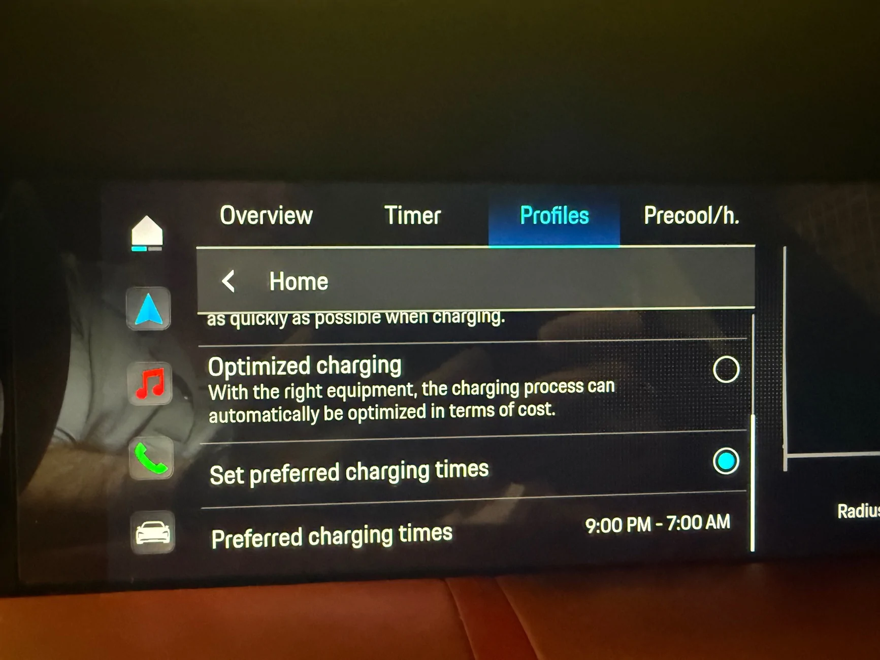

Then create a new “Home” profile for your home charging scenario. The Minimum charge default is 25% - the car will always charge to this minimum amount when you plug in. Select the “Set preferred charging times” radio button and add the times for your lower electricity rate.
Porsche Taycan Looking for a simple, easy to understand and follow, guide to charge programming J1.1 IMG_4676
Porsche Taycan Looking for a simple, easy to understand and follow, guide to charge programming J1.1 IMG_4677

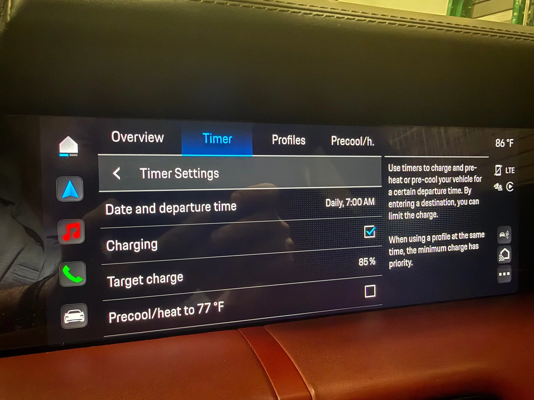

Now go to Timer. Set Date and departure time to the end of your overnight rate, 5:00 AM. Check the Charging checkbox and set the Target charge to 85%.
Porsche Taycan Looking for a simple, easy to understand and follow, guide to charge programming J1.1 IMG_4678
All done! Be sure to set your home charger as a “dummy” charger. Let the car decide when to charge and by home much. Delete any schedules on the charger itself.
