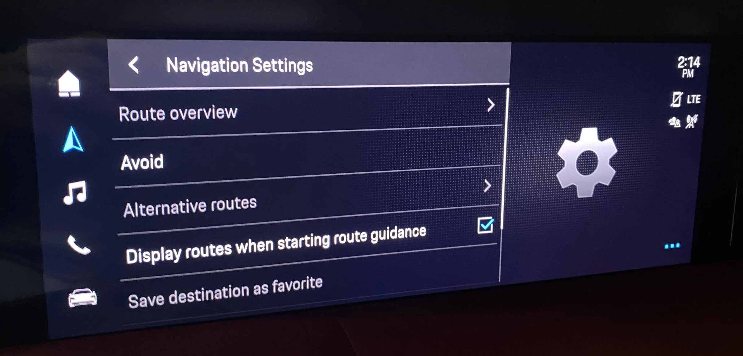

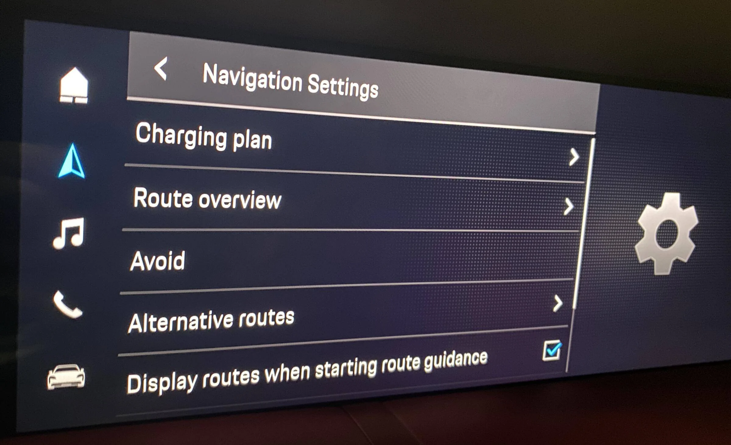

I just noticed something. My menu is the same as yours until I have set a destination set. Once I have a destination set, then I get the options for charging planner and route settings.
No destination:
Porsche Taycan Missing Charging Planner 1650478915077
Destination:
Porsche Taycan Missing Charging Planner 1650479000960

@Pandsw Did you see this previous post of mine? In your example video you don't have a destination set. Can you set a destination and post a new video?
No destination:
Destination:
