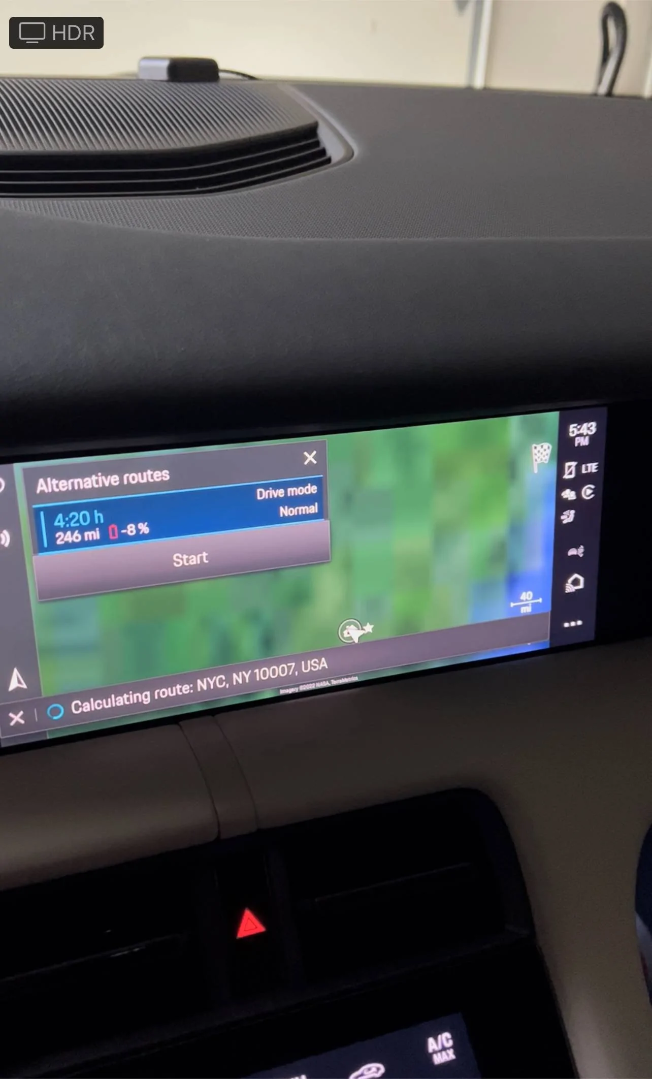

Just picked up our ‘22 CT4 earlier in the week. Built date 2/10. Finished production 2/25. No color icons on PCM. Love the car. One minor issues: native navigation came without a charging planner. If I set my destination, it will not add any charging stations to the route, instead it will show I’ll arrive with a minus battery percentage. Didn't spec PIRM but I thought charging planner is standard. I went through all submenus and I couldn’t find “enable charging planner” anywhere. I called Porsche support, no help so far… any ideas.

connected to primary user, still missing the charging planner. If I navigate beyond the battery capacity, I get a minus battery percentage upon arrival without option to add chargers in between as shown in pictures of my original post.

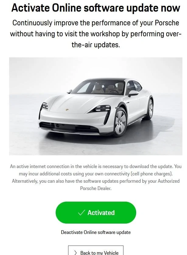

Thank you. On post#3 I took a screen shot from my.porsche.com and showed "online software update: contract term unlimited"
Is the website in the thread you quoted, the same as my.porsche.com or a different website to turn on OTA? What's the address of that portal?

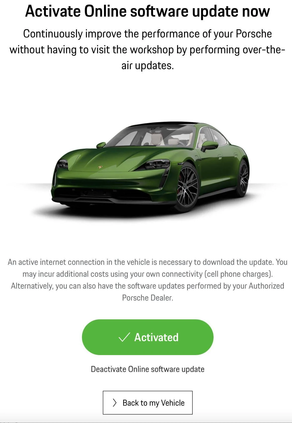

On the my.porsche.com website, click on the tile for Online Software Update (contract term unlimited). You should get this screen where you switch updates on or off.
Porsche Taycan Missing Charging Planner Update setting screenshot

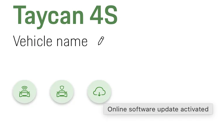

When activated, you should get this green cloud symbol on the About My Vehicle web page:
Porsche Taycan Missing Charging Planner Update activated screenshot
Yes, it's been activated and took a drive, but still missing charging planner.

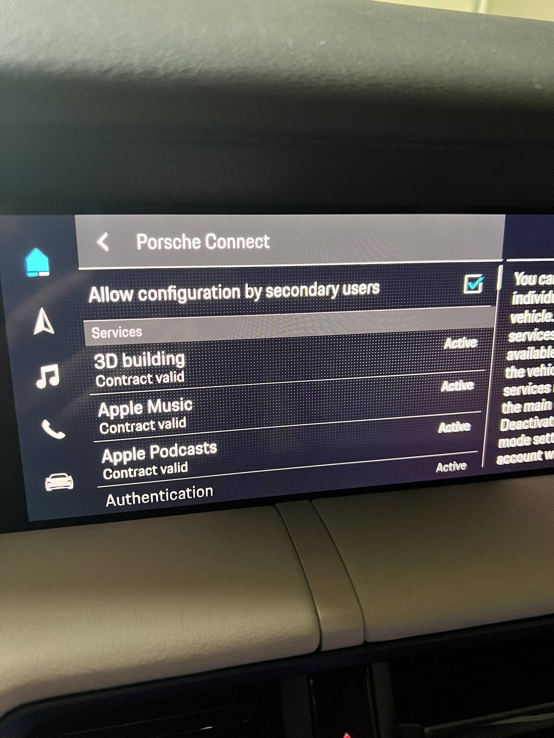

In the PCM under settings, there’s a Porsche Connect services option, select that, it should show you all the services the PCM has loaded. When we first picked up our CT4, the Porsche Connect services could not be displayed on the PCM and Apple Music never showed up. Porsche had to reset everything on the backend to get things working. A bunch of stuff did not work, routing, updates, plig and charge, etc.

Do you mean this? Everything is active except PIRM which I didn’t spec.

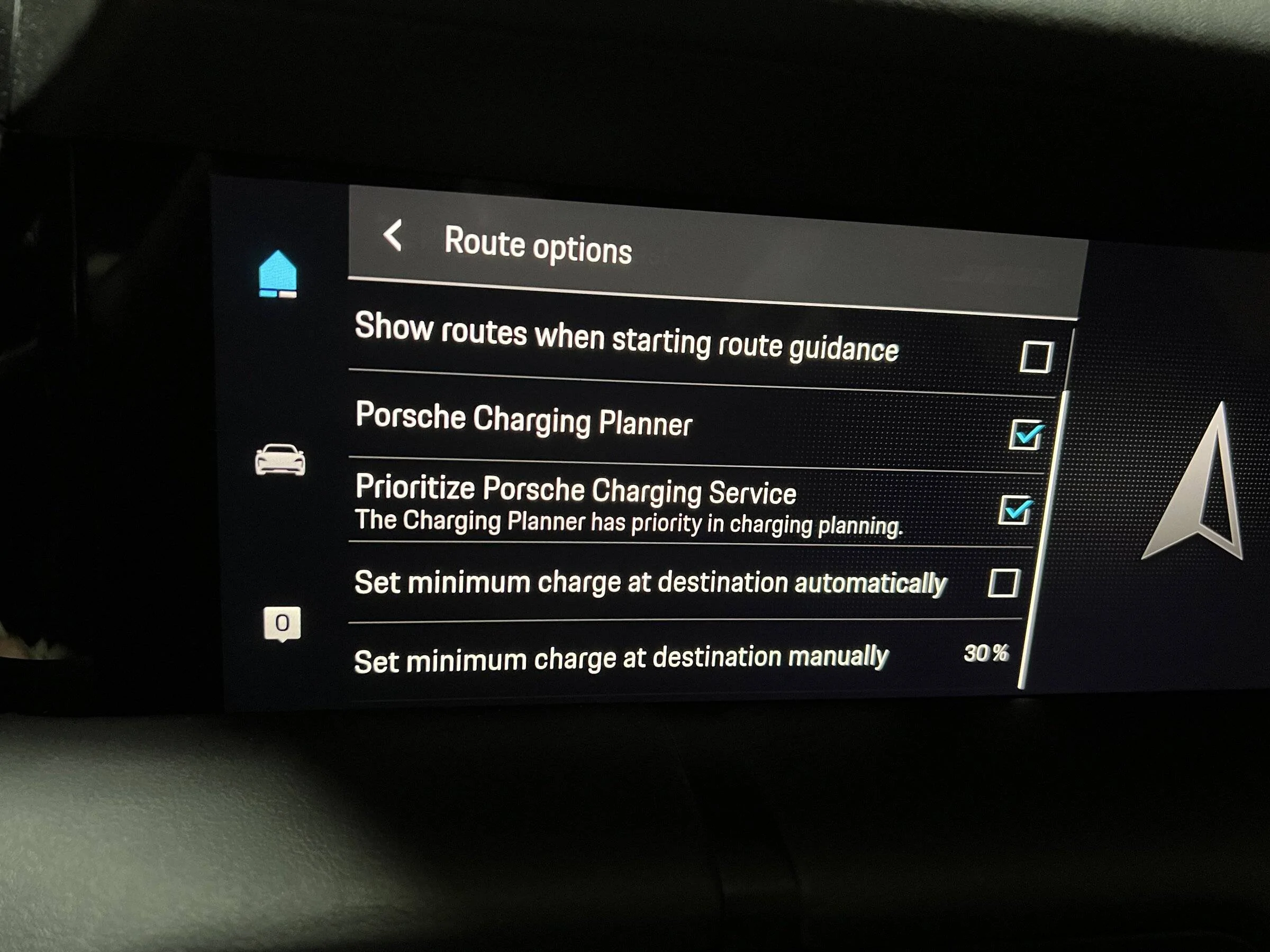

Hang on here. That IS the charge planner, if it's adding chargers to the route.
To change the destination percentage, it's hidden under one of the options on the "..." in the lower right from the Navigation page.

Uncheck "set minimum charge at destination automatically" then tap the option below it to set your end state of charge.

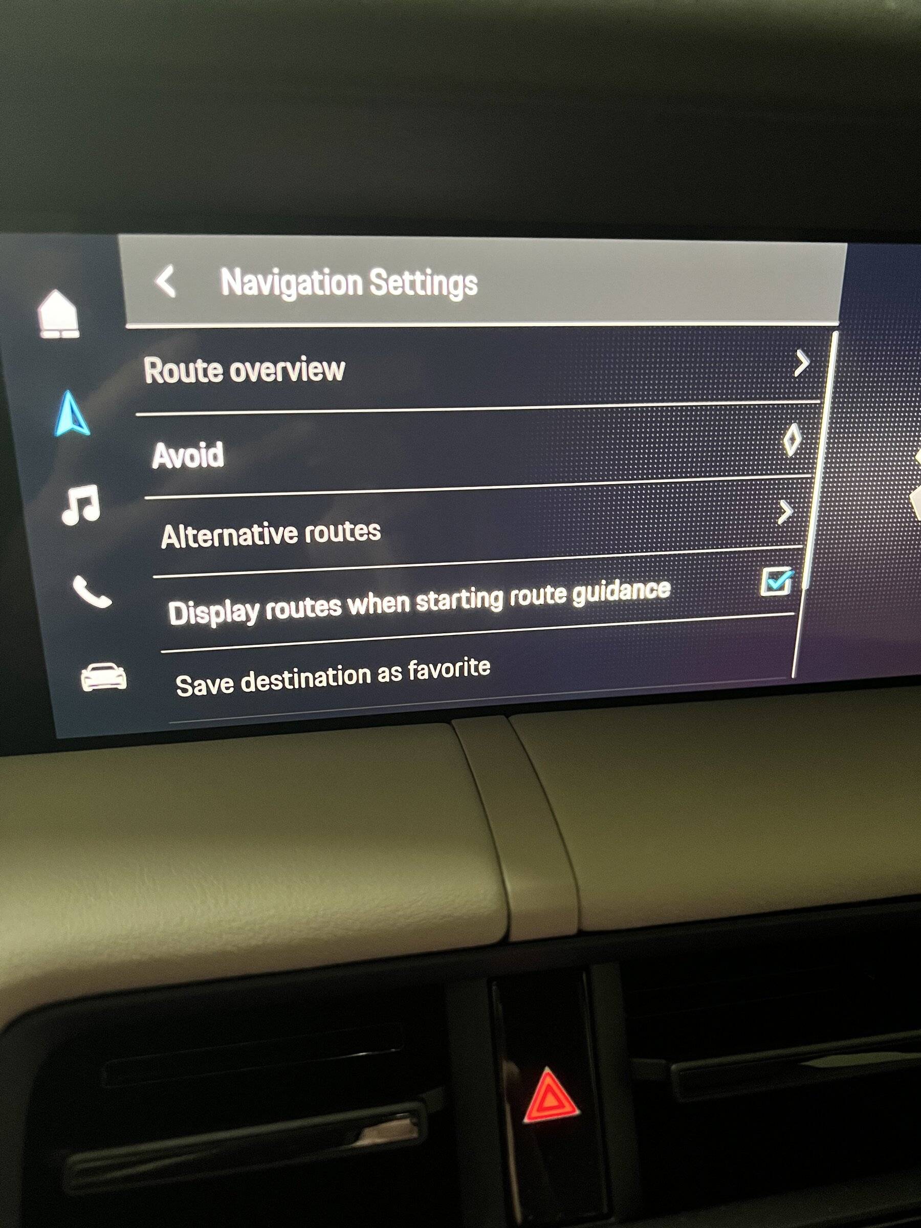

Unfortunately, the problem is my "route options" is missing from PCM. I tried clicking on 3 dots at navigation page and I got "route overview", "avoid", alternative route", etc, but no "route options". very strange...

The my porsche app adds charging stops and allows me to send that to the PCM, but because the charging planner is missing in PCM, I'm not able to set the minimum charging % at destination. It's as if the whole page of "route options" is missing from my PCM.
