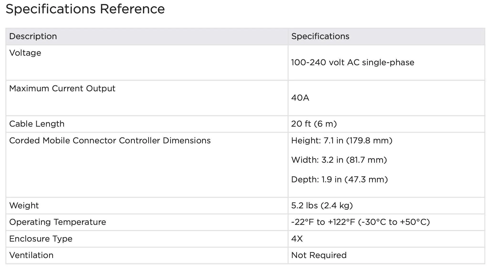

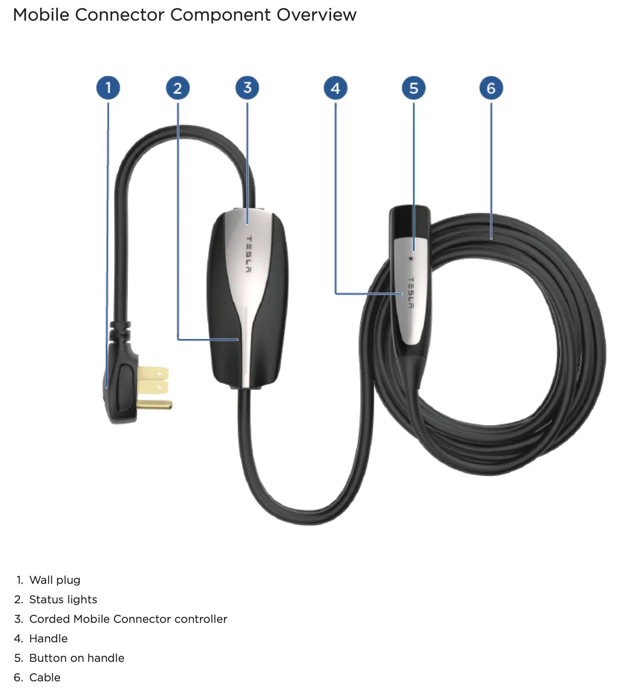

$200 40 amp 9.6 kW charger - but you'll need a TeslaTap (extra) but it's useful to have independent of your home EVSE
it lighter than the PMCC
it's smaller than the PMCC
it's more mobile than the PMCC
it's more rugged than the PMCC
and it won't overheat in normal use
and it's $200 when its in stock on the Tesla Site.
but it's a fixed 14-50 supply cord - and not adjustable amps - it can be made to work with a 6-50 plug if you get the adatper/pig-tail from amazon for $40 or less.
