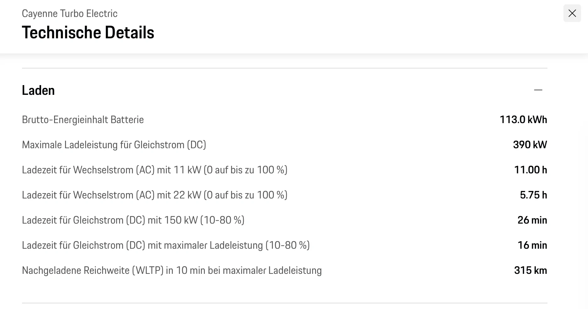

It might not have it there, but it certainly has it here.

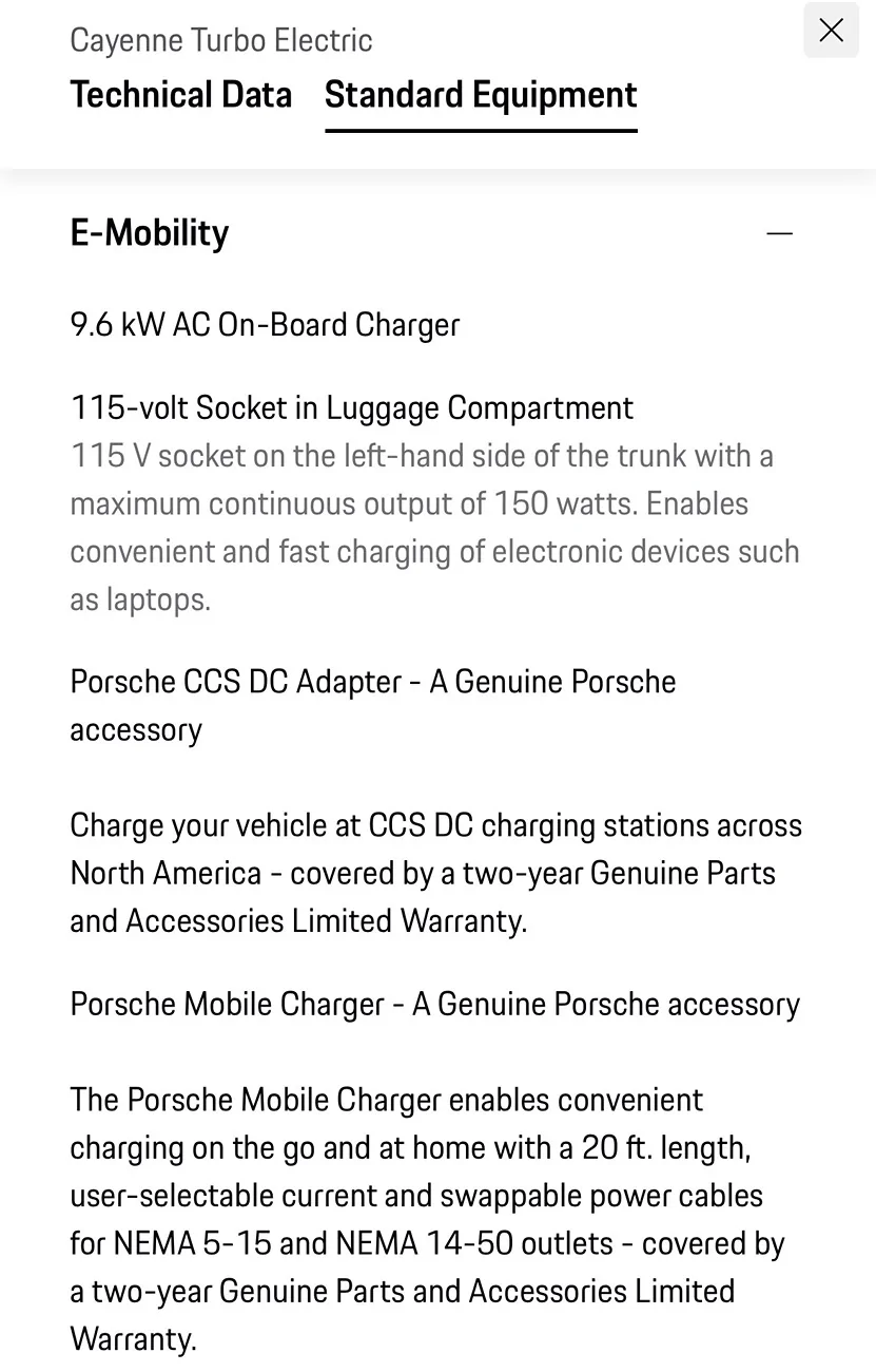

that does not say it has a 22 kw charger - that simply lists the charge time if 22 kw can be provided
you have the technical details section NOT standard equipment - note the heading on my screen shot
show me a stand equipment listing for 22kw or and optional 22 kw OBC from the configurator - otherwise you’ve got nothing
porsches listed the 22 kw charge times for almost a year even after the hardware was no longer an option for the Taycan
check the standard equipment list or options
at the moment there is no 22/19.2 kw charger option or standard equipment that i can find
the tab you have displayed is NOT the equipment on the vehicle - simple documenting times at various charge rates
You are right, I stand corrected.
I have checked again, and indeed, the 11 kw OBC comes as standard, and there seems to be no option for a 22 kw OBC anywhere.
