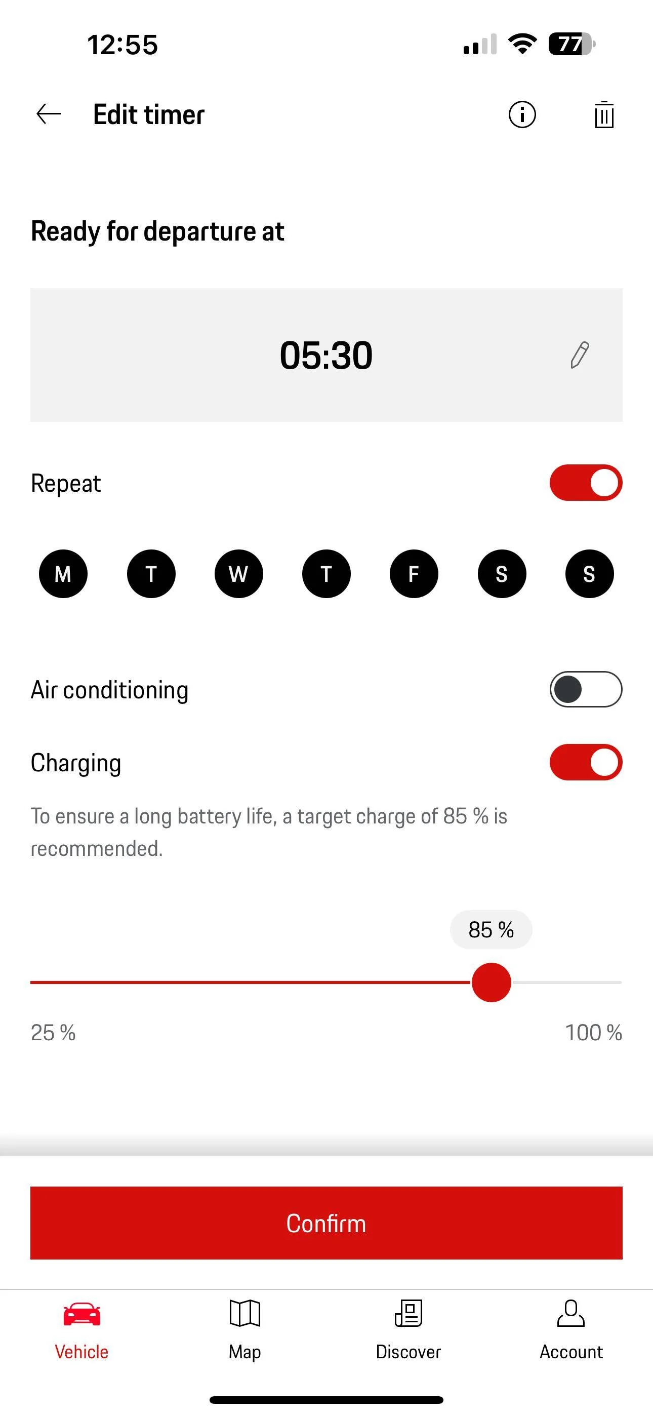

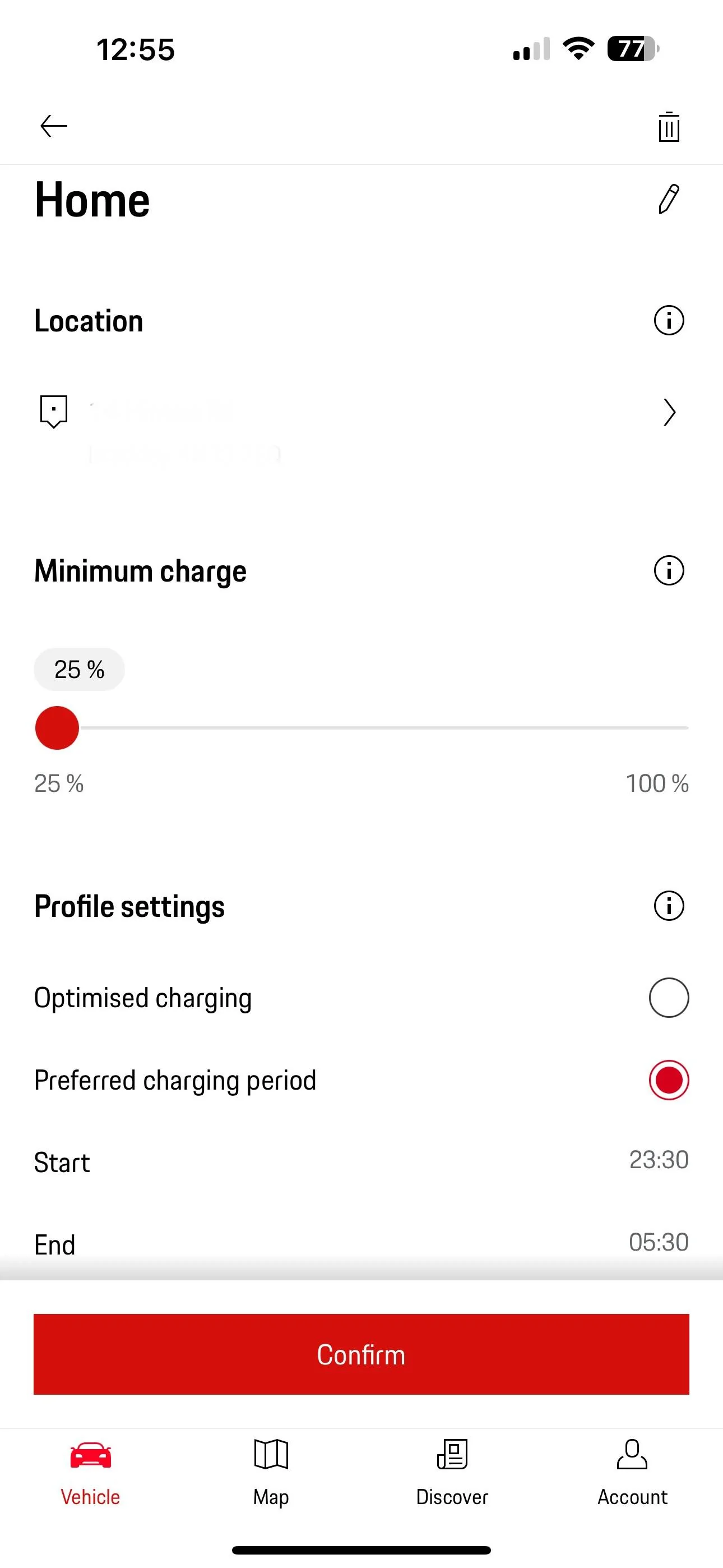

No reason to allow Octopus to control your charging schedule unless you need the extra cheap hours they sometimes provide outside the 23:30 - 05:30 cheap rate window.
I’ve disabled Smart Charging in the Octopus app and just use this profile and timer in the Taycan to charge to 85% every day using cheap energy …
