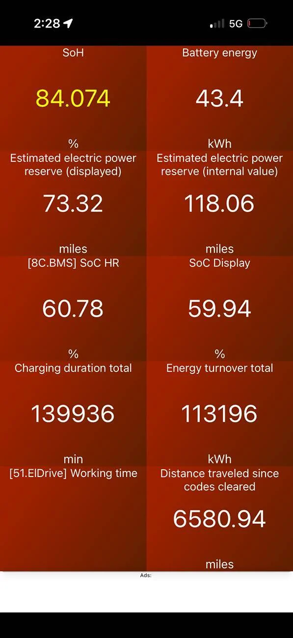

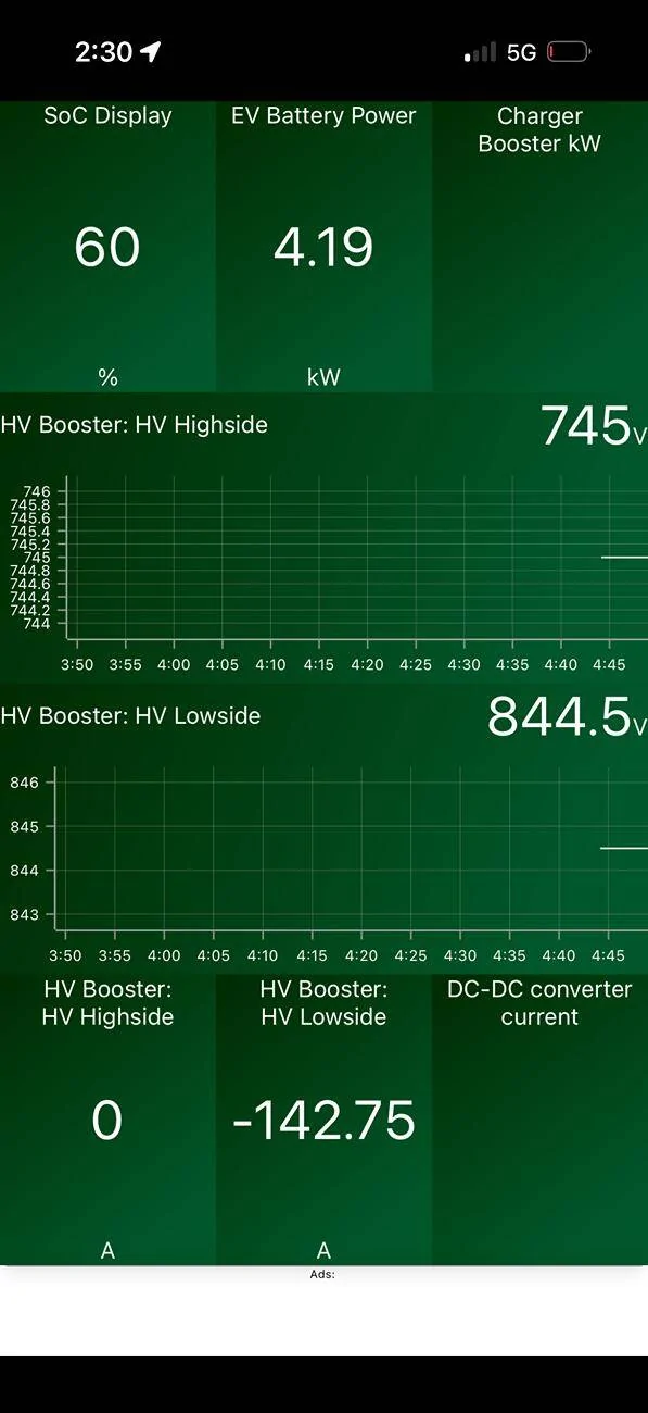

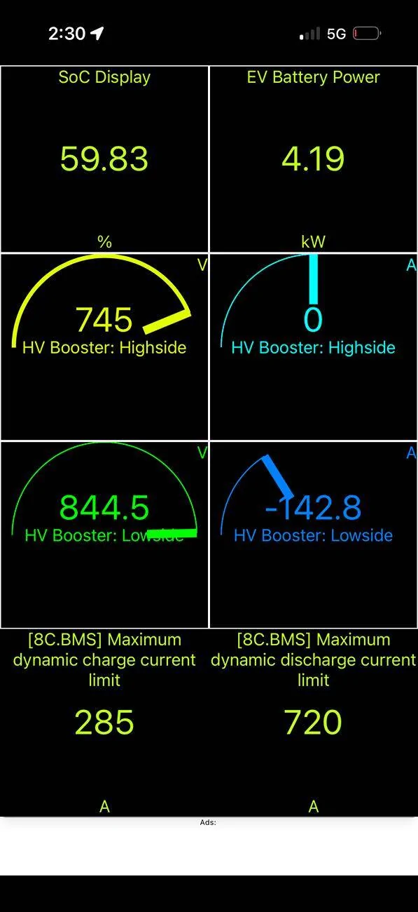

Ok, I ran CarScanner with the OBD module. I got screen captures of all 25 screens and ran the diagnostic check. Which info should I post here?

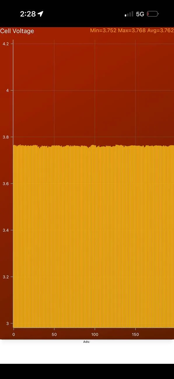

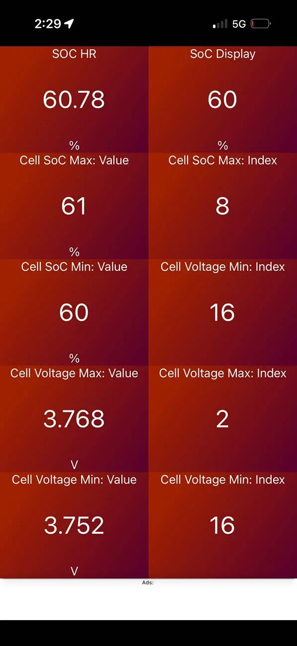

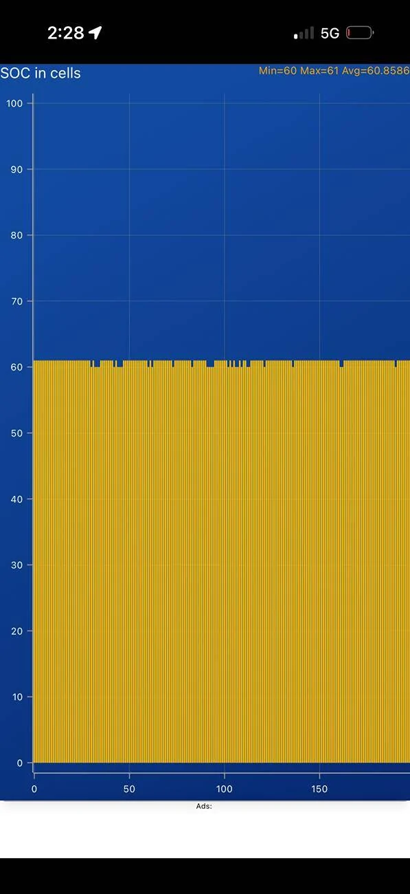

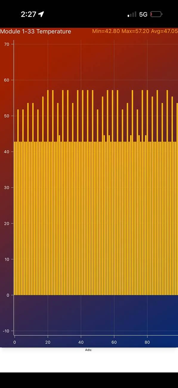

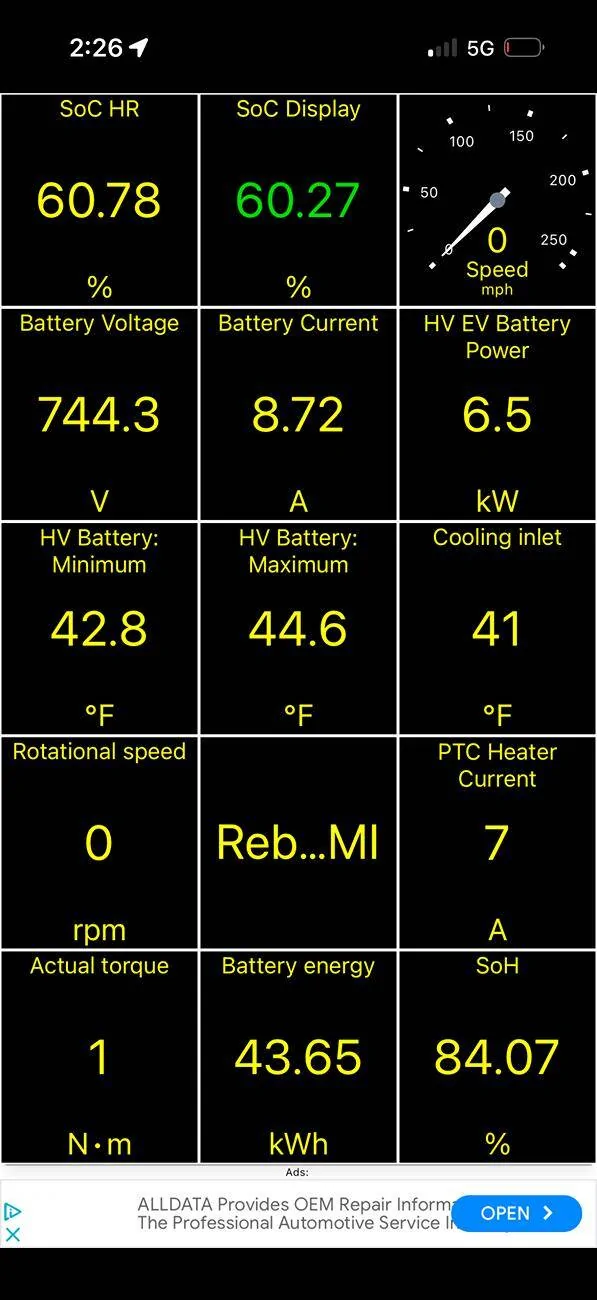

The ones I need should have the following data points and graphs:
From Dashboard
Screens with data points: SoH%, Battery Energy kWh, SoC Display %
Graphs Yellow Bar: Cell Voltage, Cell SoC, Cell Temp.
From Car or App:
Current Miles
Consumption recent history ideally in kWh/100miles
After we do this, recommend a rebalance and read out again. I can help with step by step.
Dave T
Jan 14, 2020
76
743
375
Boston
2020 Taycan Turbo
From Dashboard
Screens with data pointsi: SoH%, Battery Energy kWh, SoC Display %
From Car or App:
Current Miles

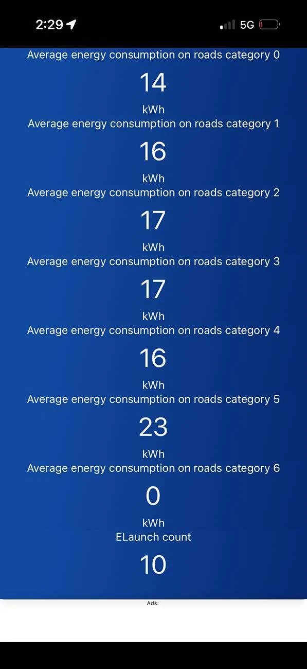

Current miles is 26633.
The average consumption from the "trip" screen in the PCM is 27.6 kWh/100 mi (27 mph average speed).
Here are the screens. Let me know if you need anything else. Thanks again!

86.70kWh - Battery usable energy when new at 100% SoH (a known basis variable)
These calculations are intended to cross check SoH and calculate usable Battery Energy:
43.65kWh current battery energy / 59.94% SoC Display = 72.82kWh usable battery energy
72.82kWh usable battery energy / 86.70kWh =83.99% calculated SoH vs. 84.07% reported
84.07% SoH is low in my opinion for a car with 27k miles but not drastically so since it is 4+ years old and a key contributing factor on range.
72.82kWh is usable battery energy after degradation meaning that for you to have 200-mile range, the consumption should be averaging 36kWh/100miles when you are driving for at least an hour to let it stabilize.
Cell Graphs all look normal with no cell outliers that would indicate cells going bad.
The next thing to do is rebalance expecting to gain SoH at least 2% if you have not done it before.
Rebalancing Protocol:
Run down SoC to 2%.
Leave the car locked and undisturbed (key far away, no app access) for 6.5 hours min (overnight)
Recharge at slower than usual rate at home on AC 40Amp/9.6kW or lower to 100%
Recapture all parameters above including Cell graphs
After the Rebalance:
Bad cells may come forward
SoH should increase by at least 2% from current 84% to 86% resulting in more range

Not correct. I have exact data.
93.4kWh is gross published spec
83.7kWh is net published spec
86.7kWh is actual at 100% SoH we know from data (Porsche always underestimates its published values)
72.82kWh is what your car actually has to use after degradation at 84% SoH
See my full analysis above. 100% accurate.

I am just going by the data that the car is reporting.
I do not know if age is a factor or not but your SoH at the age and mileage looks on the low side.
Rebalancing will not hurt anything as this is per official Porsche TSB.
Rebalancing benefit is to see if any bad cells come forward as preemptive move.
100% for overnight should not be a big deal, but that allows the battery to rebalance properly resulting more accurate reporting of the data.
The data shows that you only have rounding down 72kWh for the car to use at 100% SoC.
I agree with others that your 27kWh/100miles does not make a lot of sense as it is way too efficient, but I do not know your ambient conditions. The best I am getting is around 38kWh/100 miles on an hour local city drive in near 32F weather.
