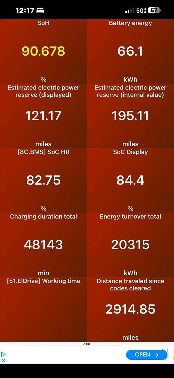

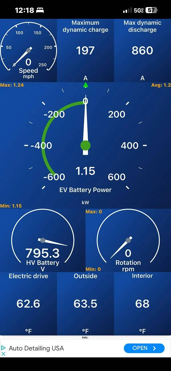

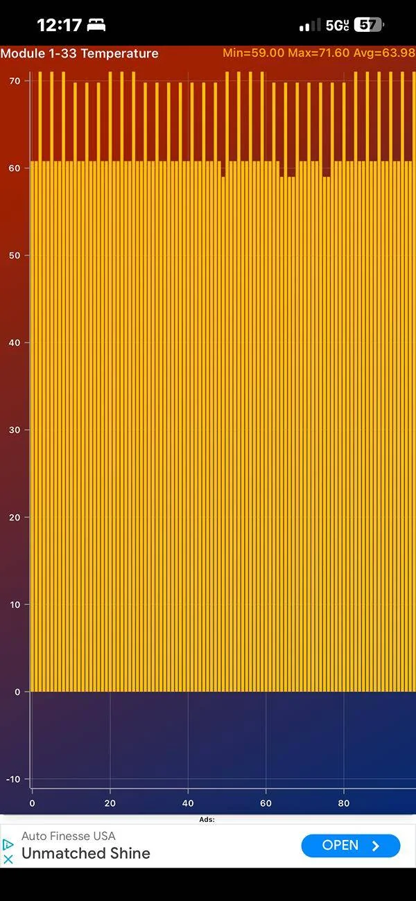

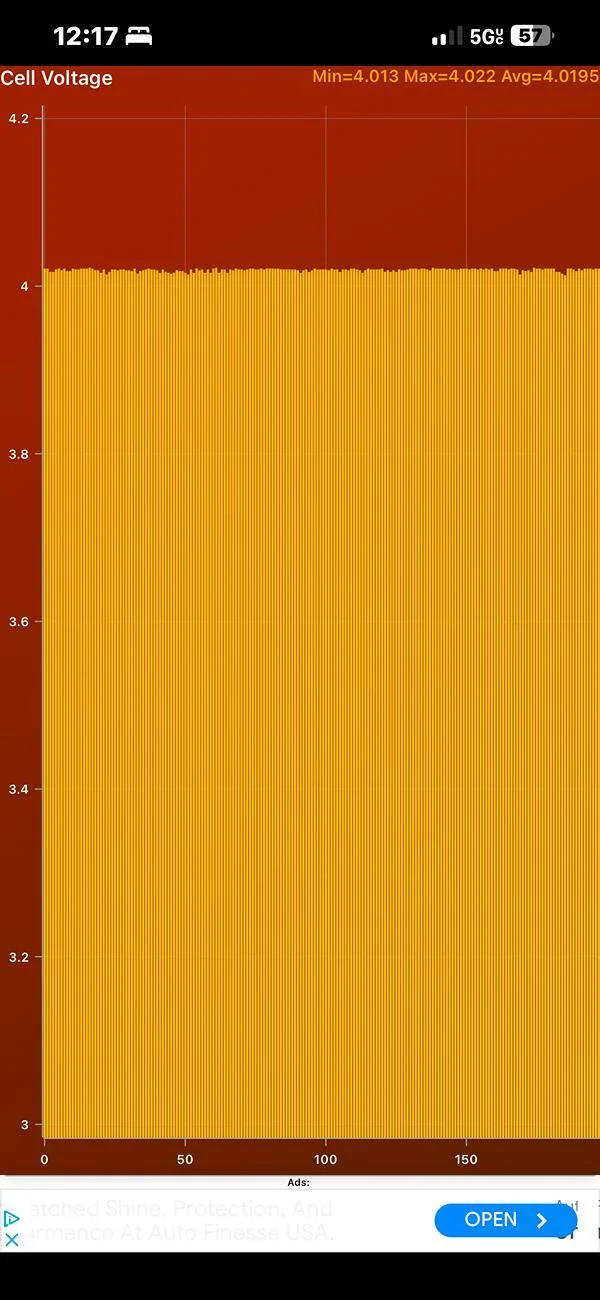

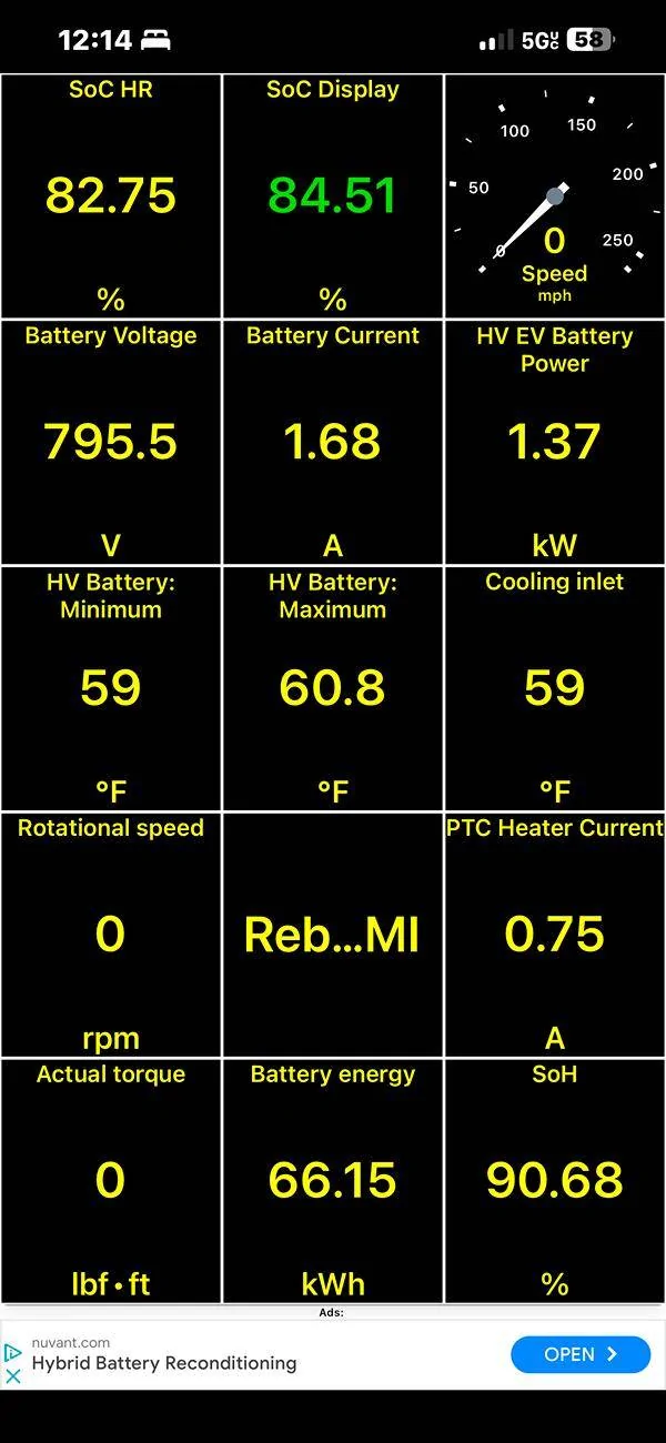

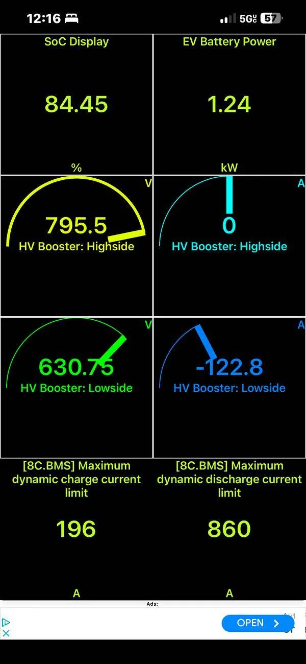

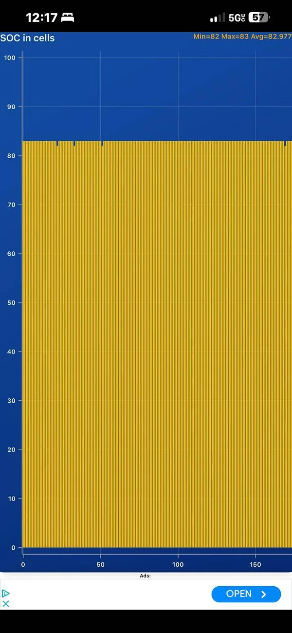

Attached is my data from the OBD Scanner. The scanner requested that I enable optimized mode, resulting in the HIGH - Voltage System Enabled message being displayed while connected. The message cleared when I disconnected.
There are 25 pages, I only uploaded 9. SergeyIndy Thanks!

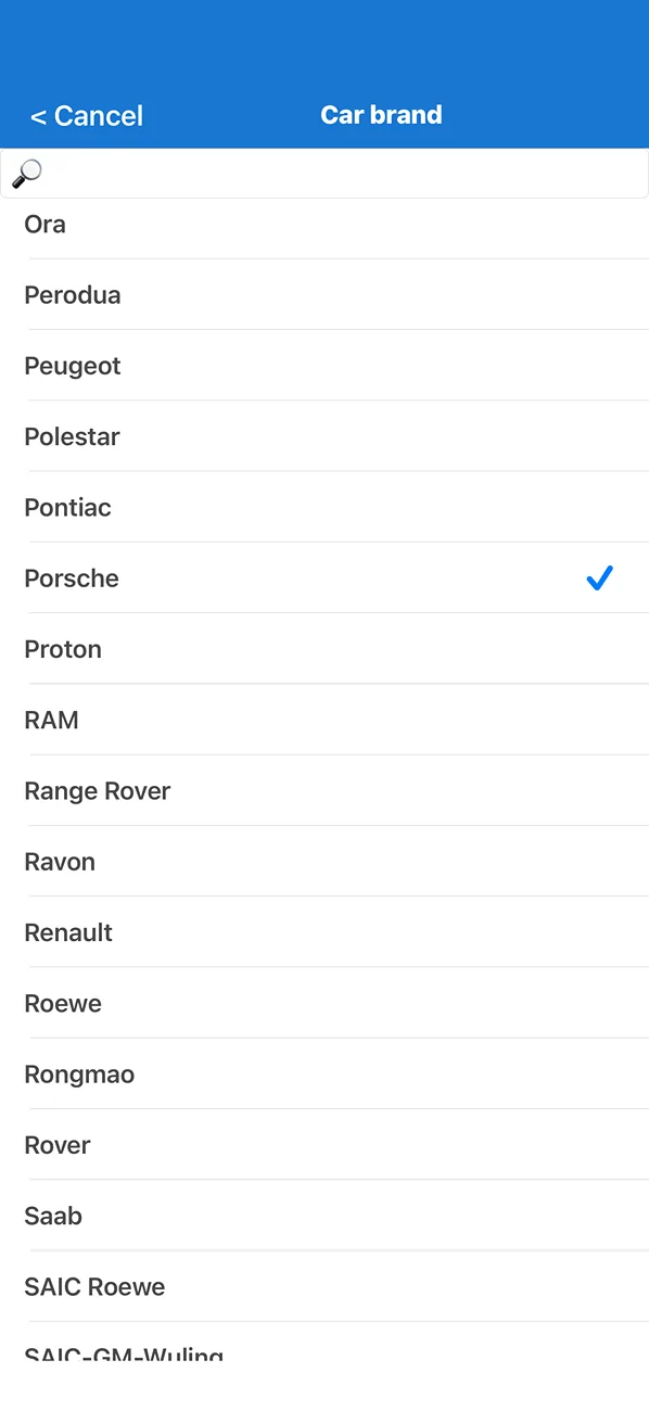

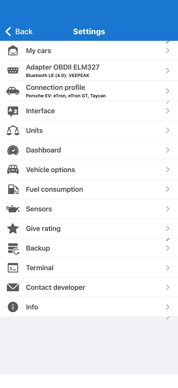

I'm getting the "high-voltage system enabled" warning when plugging in my OBD2 reader. It disconnects my reader every 5-10 seconds or so, I can't get any data. What did you do to stop the warning from happening? Thanks!
M3Taycan
Mar 3, 2024
115
111
Virgina
BMW X2, 2023 Taycan 4S

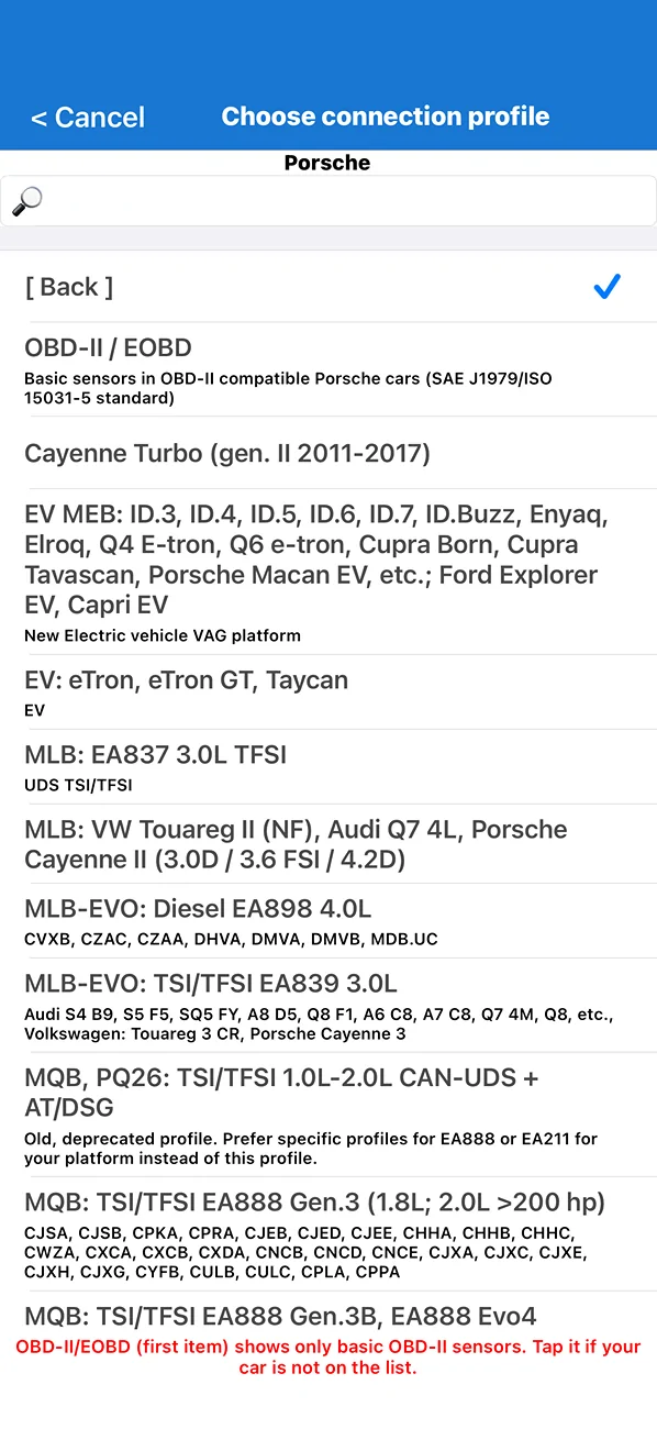

The warming message remains active when the OBD2 connects. Make sure the profile is set up correctly. See the screens below.
