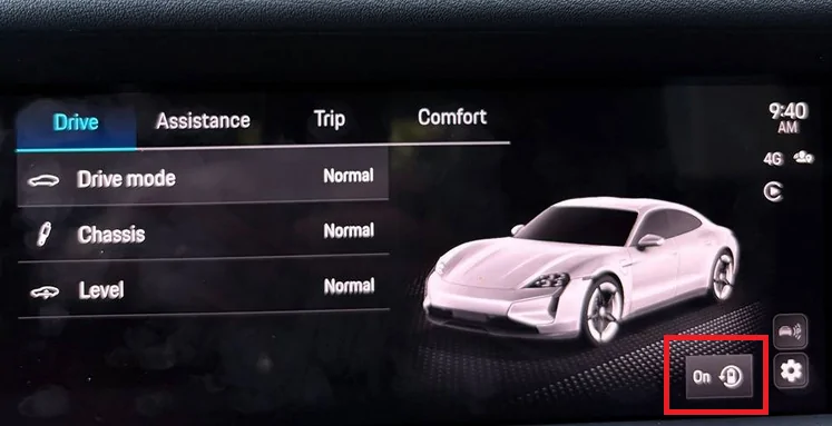

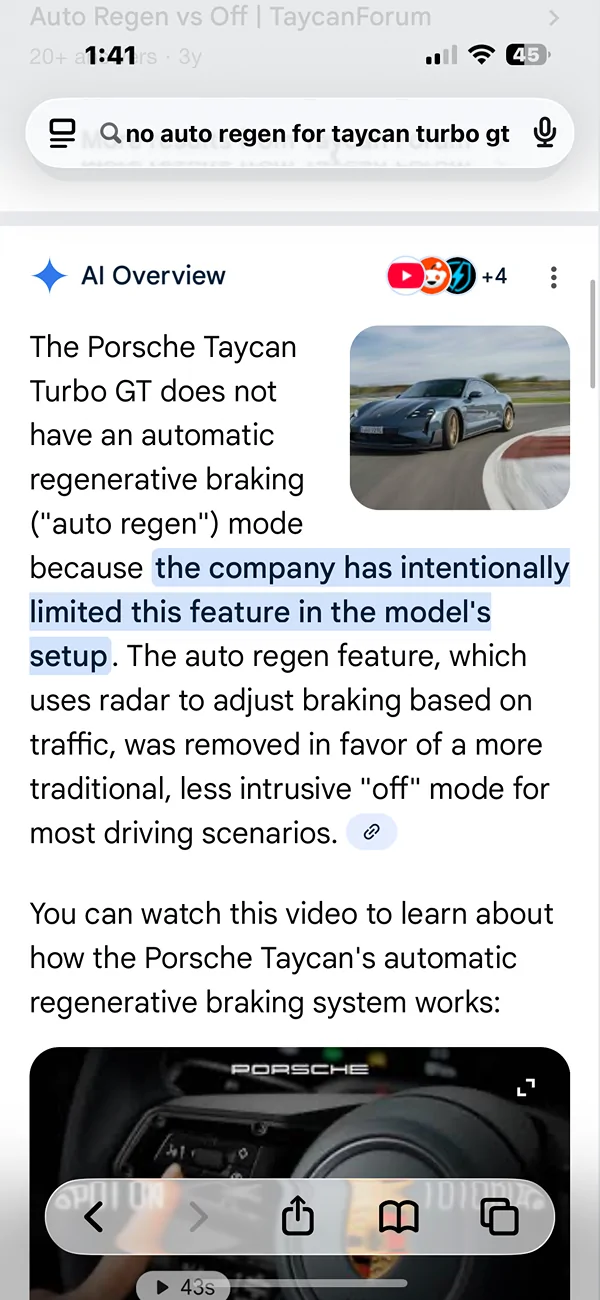

I looked in the pcm, could not find a setting for “auto” regen. Only on and off.
Also found this.
Where exactly did you look? Most people miss the lower right corner setting, it is unintuitive on the J1.2.
And please don't use LLM's to do research, it's not good for these things - the LLM hallucinates and it linked you a J1.1 video.
It's here on the newest software:
