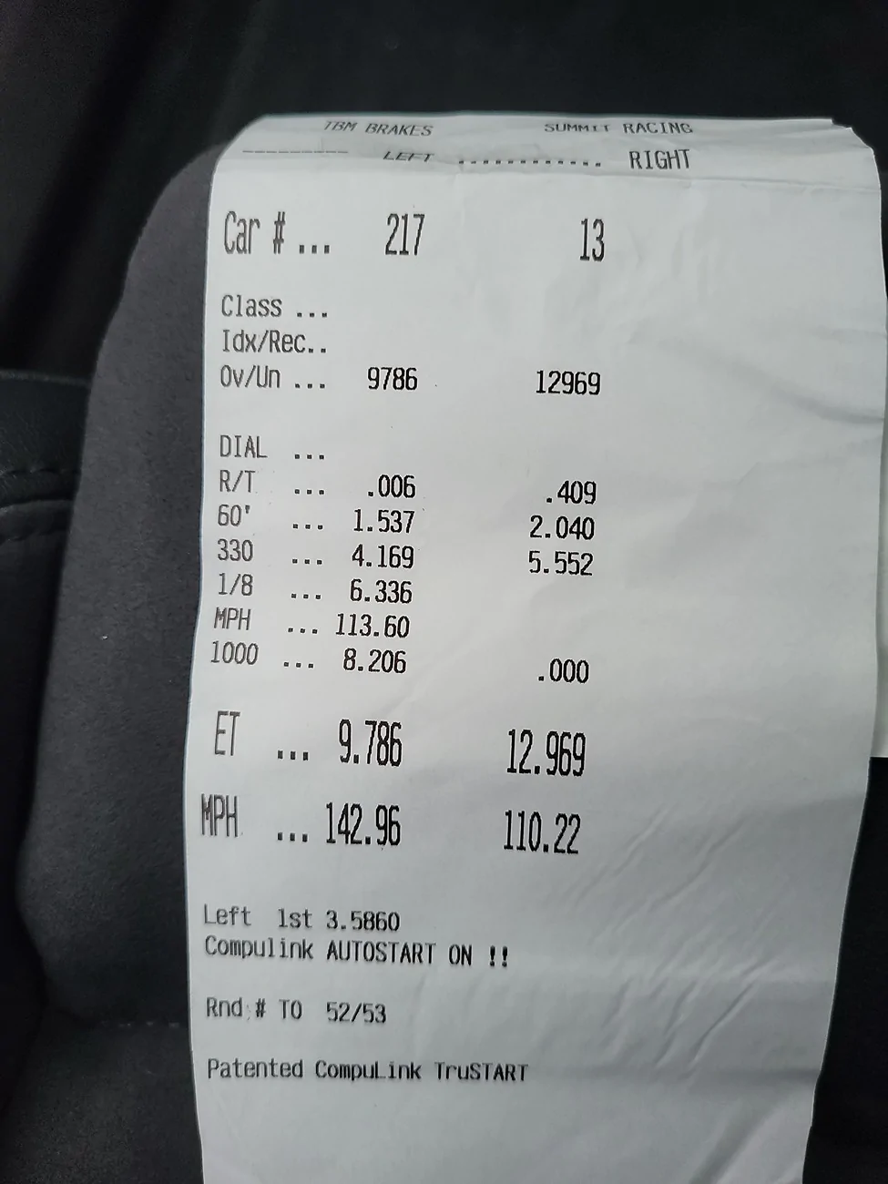

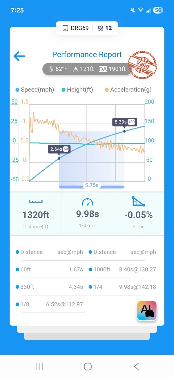

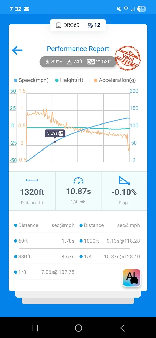

Another happy Mapev customer here. 2025 S e-tron GT without tune 10.87 at 128.40 mph quarter mile.
With tune, [email protected] mph. These times were on an asphalt stretch of road.
At the drag strip, [email protected] mph. Car is stock other than the tune.
Man that is an awesome time and massive improvement. Any tire spin or is it hooking strong on launch ?
stmang
Steve
Nov 5, 2025
Tallahassee, FL
2025 S e-tron GT
Good point, didn't think about how to enter the parameter.
It hooks perfect. Foot on the brake, then accelerator to the floor. I'm amazed how well launch control works. Stock 20 inch wheels and tires at 42 psi. I don't think drag radials would hook any better. You can't do a proper burnout to get any heat into the tires.
Anyway, I got exactly what I wanted with the tune which is a sub 10 second quarter mile.
