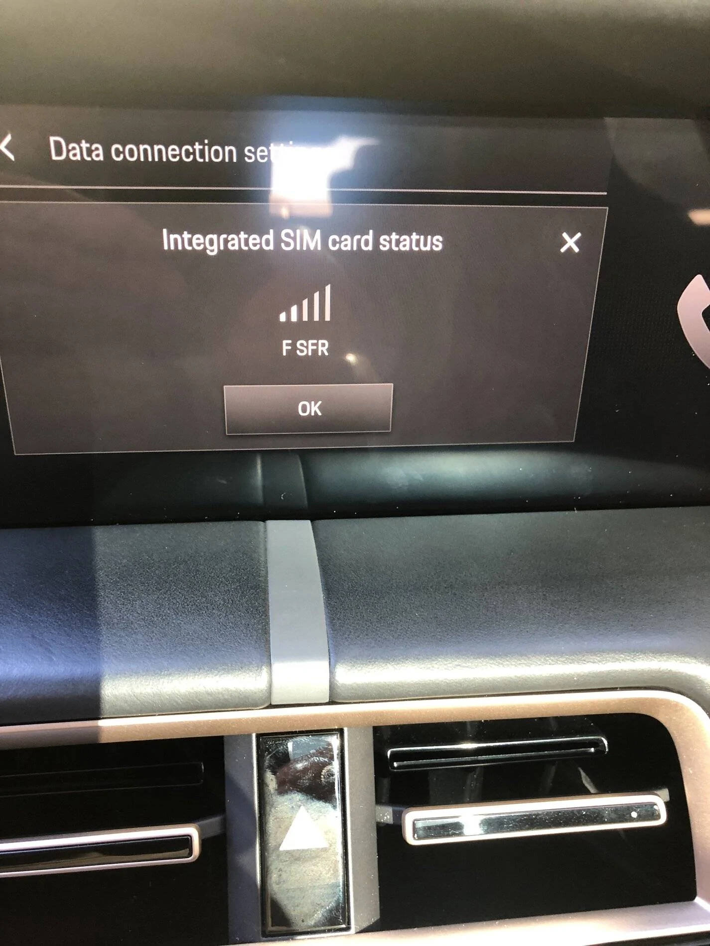

PCM shows connection to Verizon with strong signal (Devices > ... > Data connection settings > Integrated SIM card status), but data connection does not actually work.
Have you tried accessing the Weather app or the News app from the PCM? Or streaming through the factory installed Apple Music app (not through CarPlay)? If none of those work then I agree your data connection is the problem and the module likely needs to be replaced. If they work (as mine did) then it’s more likely a Porsche server side issue. If the PCM data apps are working have you tried using the second key fob to attempt to force it to reconnect that way?

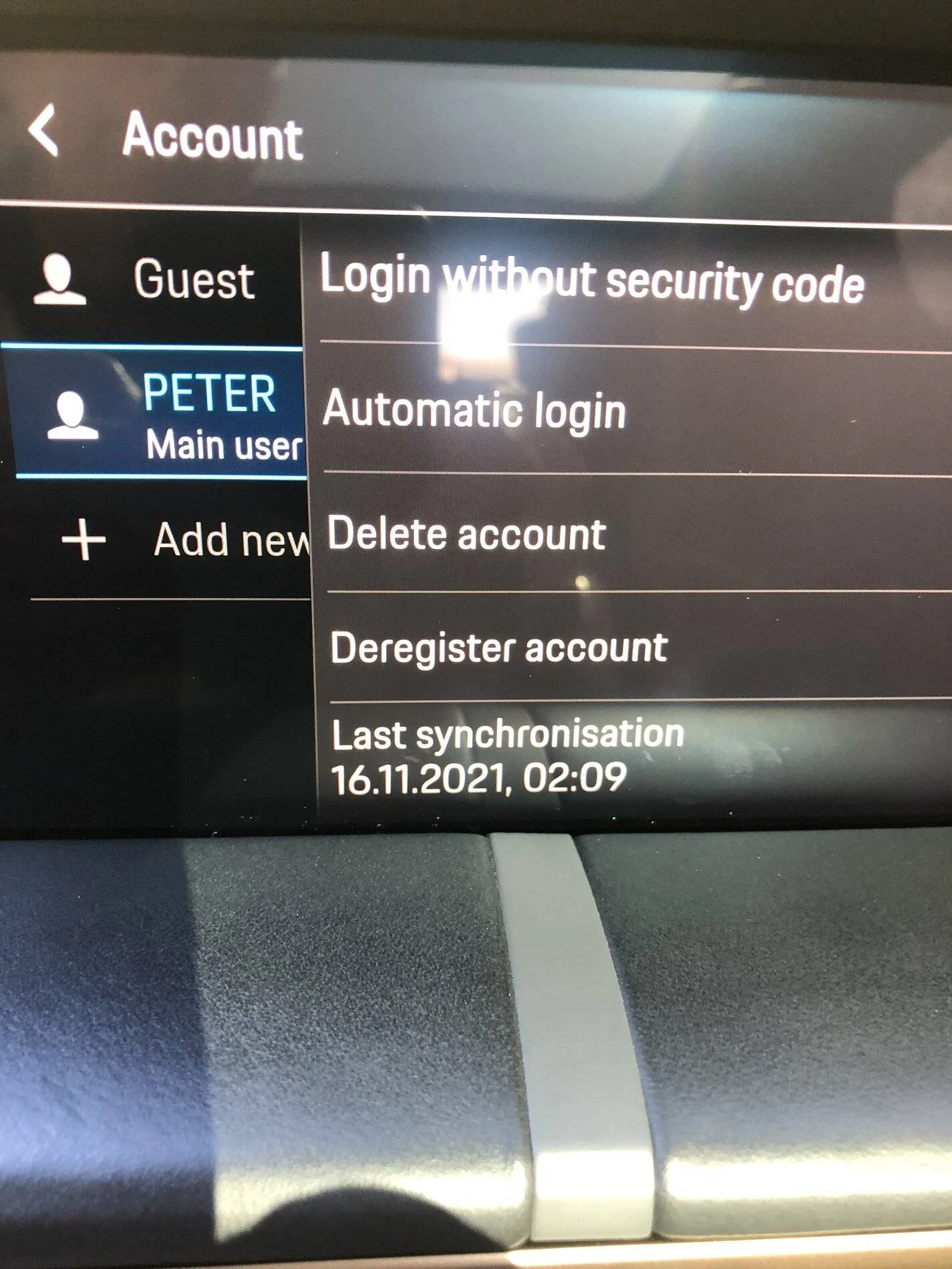

Yes check privacy and as a last resort before going to dealer have you:
- tried to log out of your profile (delete profile from PCM) and back in?
- if you don't have/find news or weather, been notified of any recent map update (check notification tab in PCM)?
- tried to reboot PCM via "engineering mode" (quick two finger tap on top right corner of central display)?
I had the same/similar issue - data transmission was ok (checked with one of above methods) and all services came back days after when Porsche finally fixed their servers
Porsche is not only risible at UX/UI dev (like for most car manufacturers, PCM is a joke when compared to Apple/Android best OS and apps experiences), but also did not even issue an email or a notification in their f-ugly connect web portal acknowledging their network was down...

Just thought I‘d update this thread with my status. Had no connection with the Porsche servers since November 11th. Tried all the log out/in, privacy on/off, reboot etc. This Monday I emailed my local dealer and asked them if they had any suggestions. Got a call 5 minutes later - appreciate that. Tech said to try the log out/in and possibly delete profile in car. So tried the first bit again, and lo and behold - things gradually started to work again. After a few more rounds of stop/lock/open/start car - all functions are alive and well again.
Now this all had me a bit intrigued. Quite the coincidence that this happened minutes after contacting the dealer? In my line of work, there very seldom are such coincidences…. I would almost say that it appeared like the dealer was able to ”upgrade/patch” my online profile in such a way that communication with the car was restored. But who knows….

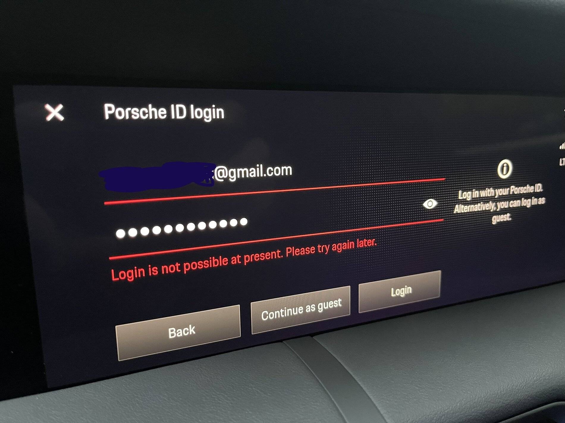

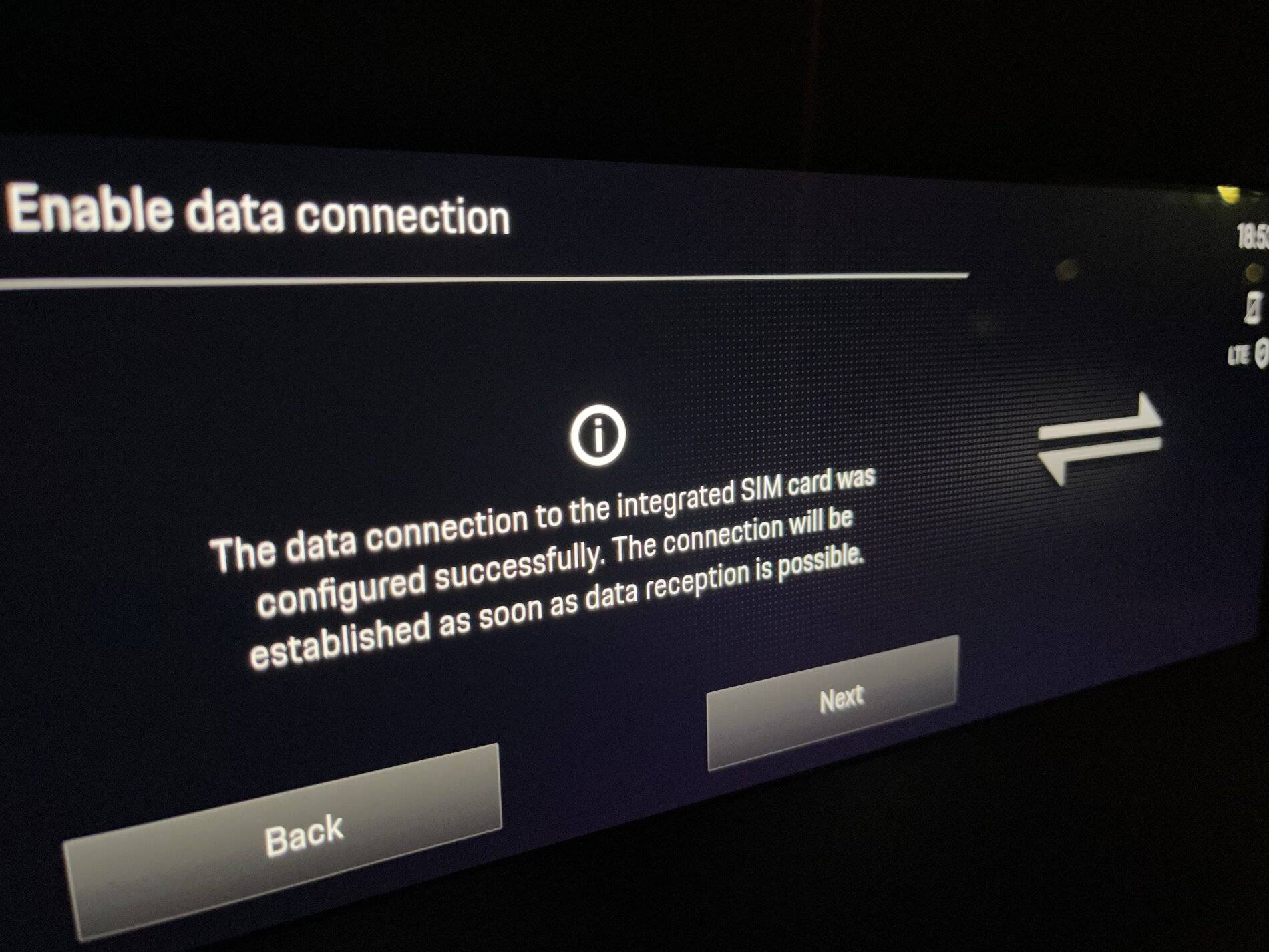

My CT4 stopped communicating with the servers about 4 or 5 days ago, shortly after a "Map" update was installed. I noticed the LTE icon disappeared from the right side of the screen and an icon with two arrows with a slash had appeared in its place.
Tried rebooting the pcm, didn't work.
Tried deleting my Porsche id, didn't work. In fact made it worse because i could not log back in and was forced to use guest mode.
Tried calling Porsche support, they didn't have any remedies that would work.
Tried deleting the app from my phone, didn't work.
Finally determined that the OTA/LTE sim unit was stuck and was pretty much out of luck. Decided to disconnect the 12v battery for about 7 minutes. Came back, reattached the negative battery lead, brought the car back online.
Success! LTE was now showing in the right hand side.
Tried entering my Porsche Login ID, but still would not take.
Noticed that the system was indicating that some updates were available, so I proceeded with the updates.
Once the updates finished, I was able to log my Porsche ID in and all is back to normal.
