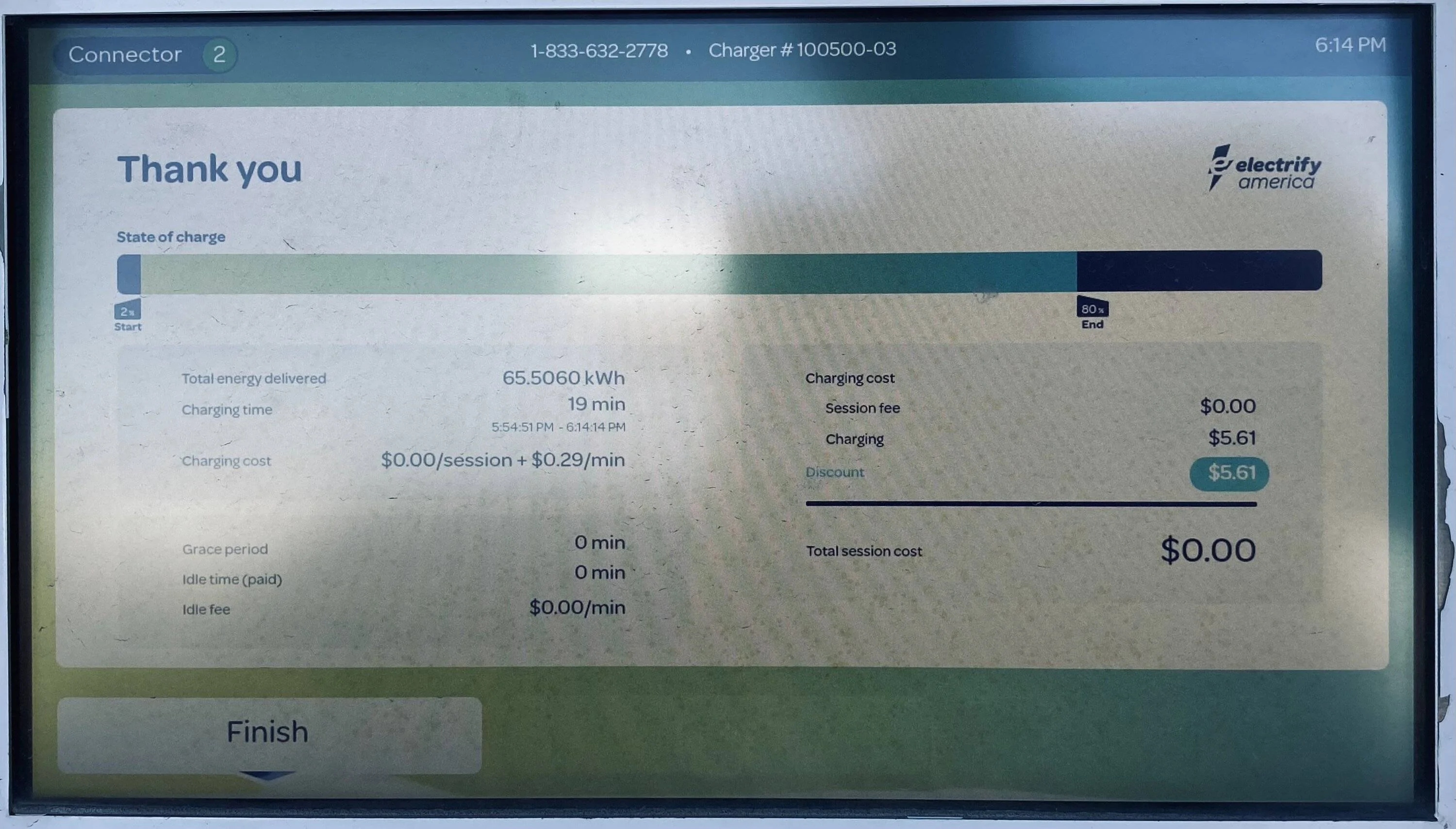

Electrify America: 1415kWh, 10.5hr, 36 sessions, Avg 17.5min, (135kW avg) $0.00 (less than 30min sessions)

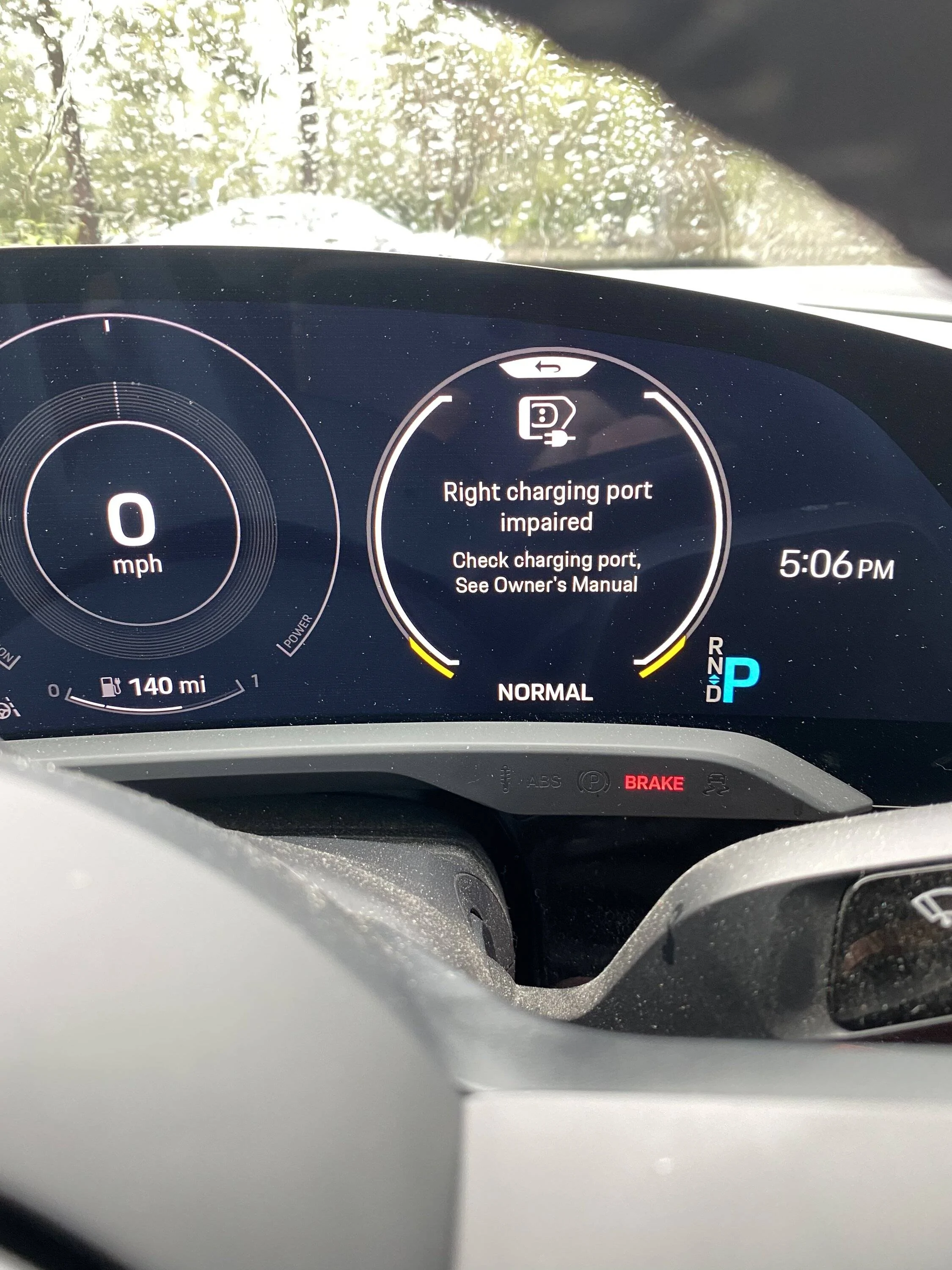

Latest update, car has been charging great after the second time for a fix. Now up to 53.3k miles. Battery health is 90.55% according to an OBD II scan.
See thread https://www.taycanforum.com/forum/threads/baseline-for-hv-battery-soh-performance.12815/
“Right charging port impaired”
However my right charging port door won’t open after a L2 charge last night. Error message attached, took it to service this morning. Porsche Stevens Creek was great at getting me in as I have an emergency trip coming up and can’t deal with not being able to access the DCFC port.

Curious if after your L2 charge did you have any issues closing the LHS AC_only charge port door?
I ask as the only time I've had this RHS charge port door error in the Dash was when for some as yet TBD (faulty door motor or sensor etc. ?) reason my LHS door failed to close after AC charging at home - the door repeatedly attempted to close but bounced back as though there was an obstruction (which there was not). When this happens the RHS charge door error pops-up in the Dash because obviously if the LHS stays open the RHS cannot open i.e. and indirect effect.
I resolved my issue by some manipulation of the LHS door until it closed (had to do this twice in my ownership to date and despite recording the dash error my service dept. considered it as never happening as they could not repeat!). Clearly I will take a video if it ever occurs again :)
I have manual charging doors. But no I had no issues with left hand door opening out re-latching. Also I could open the right side if I tried within 1 second of unlocking the car. But the port has a red light and would not charge.
Ah - answers that! But this now sounds like it could be quite serious in respect if not a sw issue then possibly a DC hardware issue - hopefully not!

Well I should be EV getting my car back from service tomorrow after 8 days.
I am hoping all is fixed as I have over a thousand miles planned in the next 7 days.
They had ordered a door latch/lock which I assume has sensors in it also.
The car is quite complex and has so many interlocks for safety. Thus many points of failure it seems too.:rolleyes:

Picked up on Thursday and added 700 miles by Friday evening. Charging port is back in business. They were also able to address my intermittent problems with the parking cameras. 500 miles to add tomorrow and many more to go.
The Taycan is charging like a boss, at Bjørn would say.

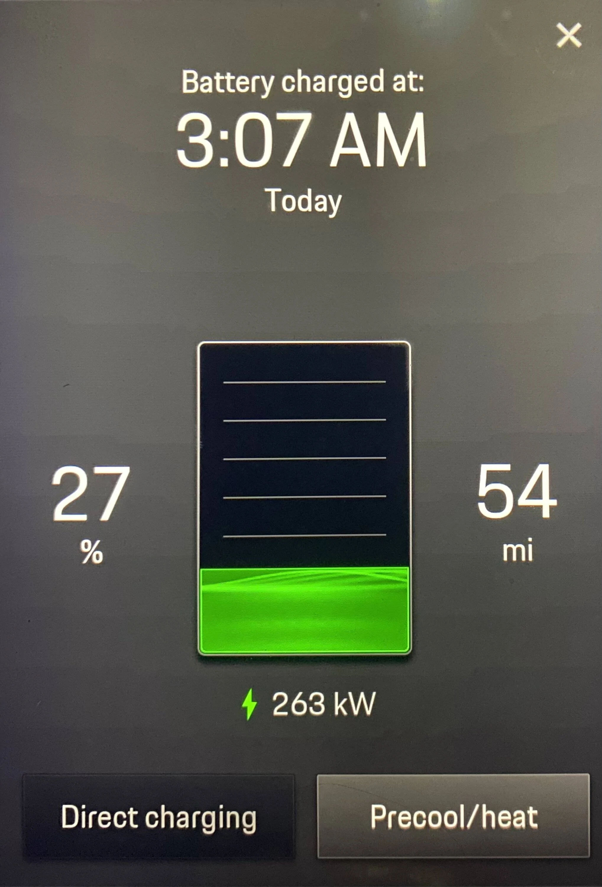

    • Cheyenne, WY 15min 18-85% 239kW Avg
    • So-so session in Rawlins, WY 37min only ~108kW avg to 21-96% to get thru dead-zone
    • Evanston, WY 08min 14-42% 173kW Avg
    • Salt Lake City, UT 13min 13-72% 237kW Avg
    • West Wendover, NV 10min 14-61% 239kW Avg

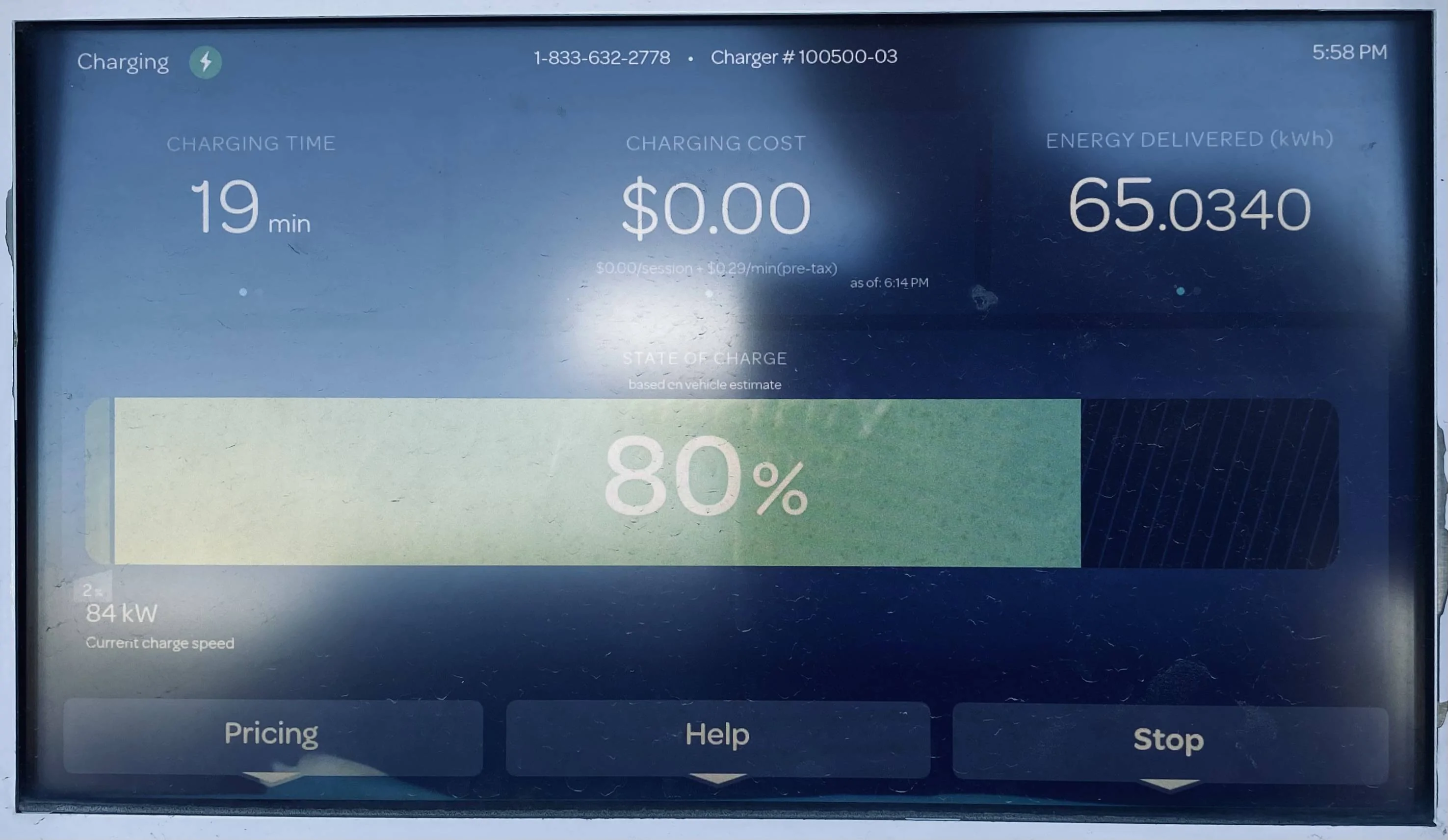

    • Waukee, IA 52min 12-94% 82kW Avg
      (tried multiple as I was limited to 78kW at 12% SoC and warm battery, reported to EA)

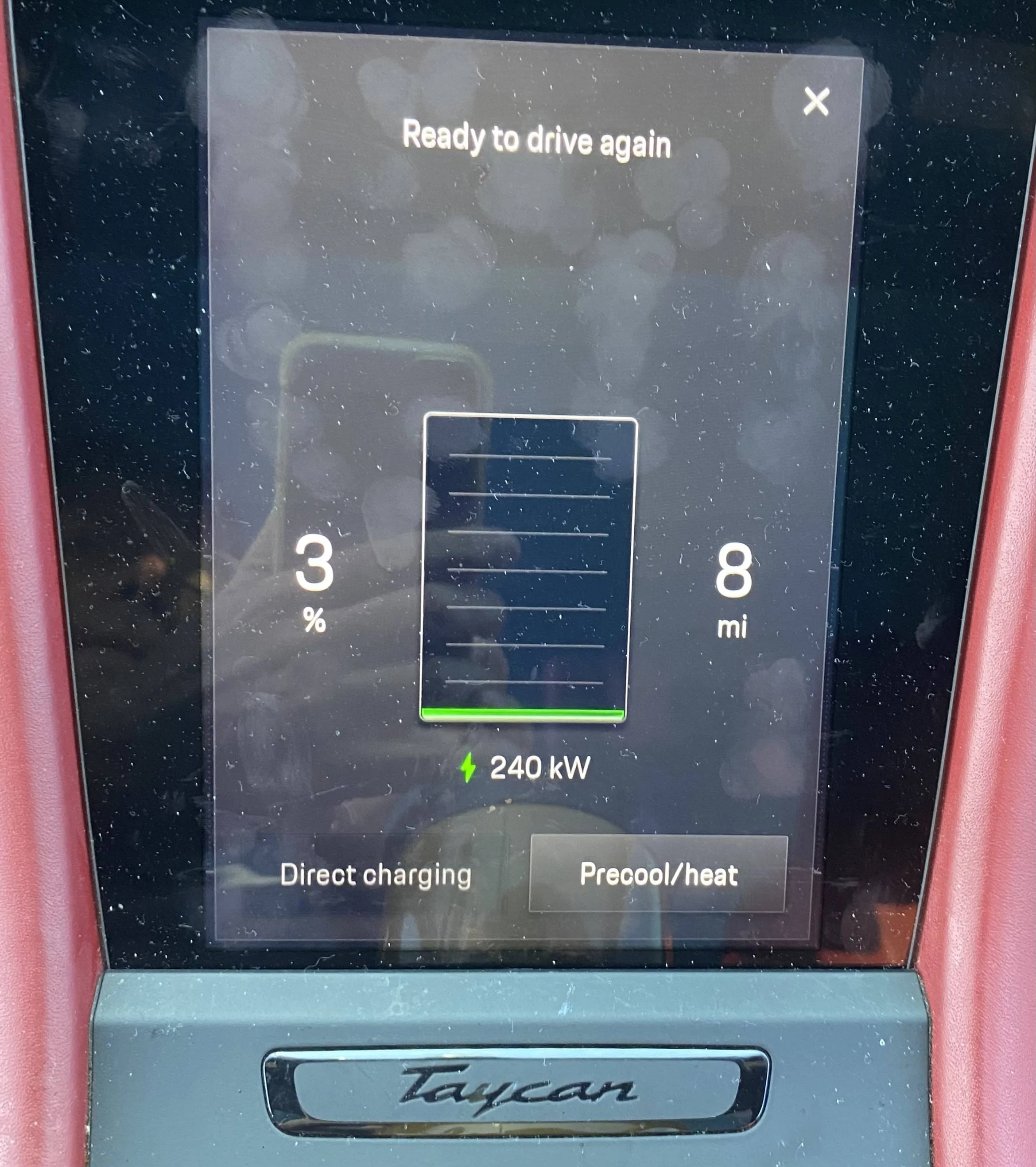

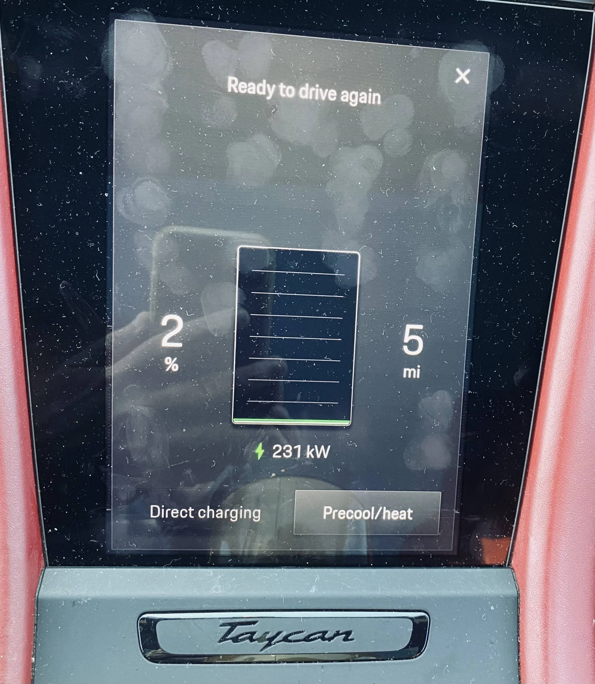

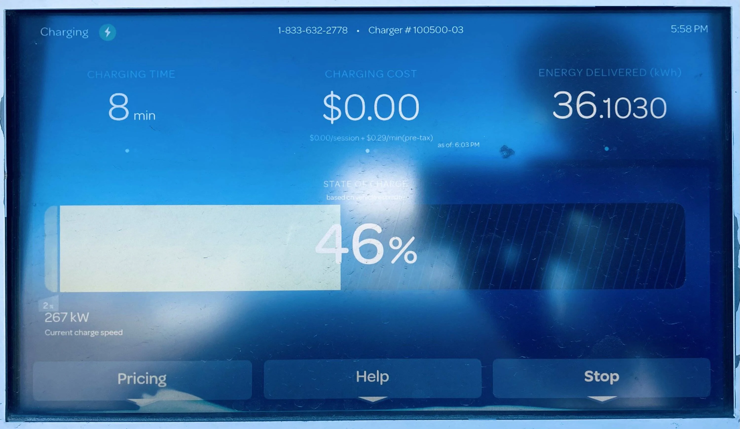

One charging stop with anxiety, I was originally routed to North Platte, Nebraska but when I was only about 20 minutes away, it disappeared from the Navigation. Then I got a message, saying I was not able to reach a Charger. This was on September 26 which appears to be the day that ABB had a major outage on their Charger status. Though I heard this should not have affected Electrify America. It certainly did affect the Porsche navigation.
I was looking ahead and found Ogallala Nebraska as an alternative with a 2-3% arrival. it dropped to 2% at times, I had to slow down to near the speed limit, which was quite disappointing not to mention embarrassing. But the car performed fine and my actual arrival was 2% with 3 miles of range.
with all this anxiety, my fears were relieved finding this station completely open and the 350 Charger provided me 231kW instantly and 240 kW within a first few seconds ramping up to 267 kW at 46%. A 19 minute charge from 2% to 80% is a beautiful thing on a road trip.
