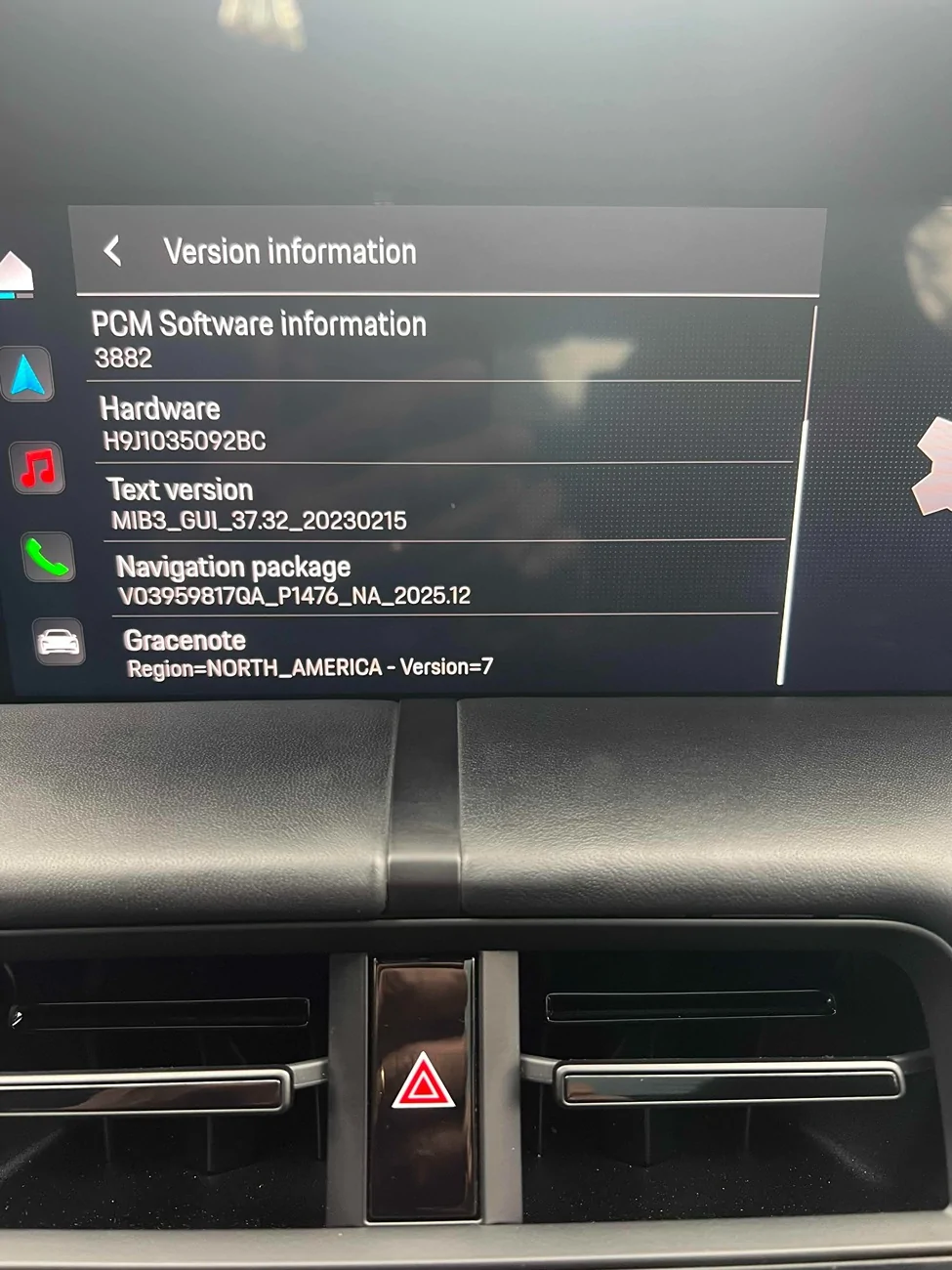

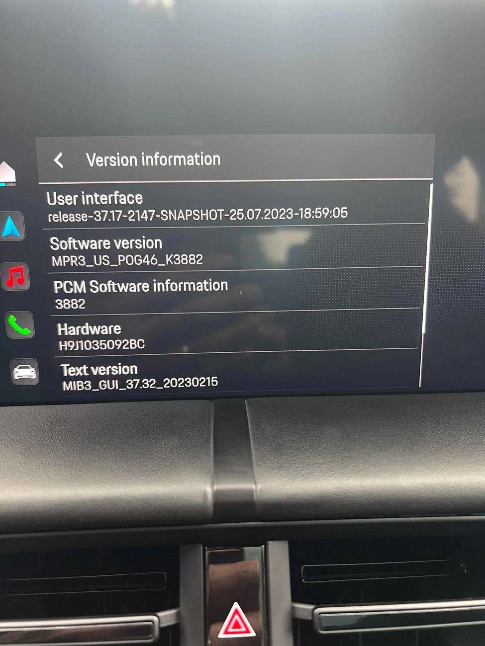

What version of PCM software is in your Taycan?
Here is my version from a recent 20K service on January 5, 2026.
Porsche Taycan Porsche App not connecting after 12V failure IMG_9873
Porsche Taycan Porsche App not connecting after 12V failure IMG_9874

The PCM version has absolutely nothing to do with the 12V battery.
My brand new J1.2 also has the 12V battery sensor recall btw.
OK. Thanks!
Is this 12V battery sensor recall for only J1.2?
