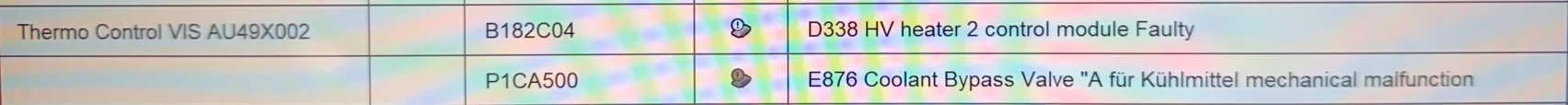

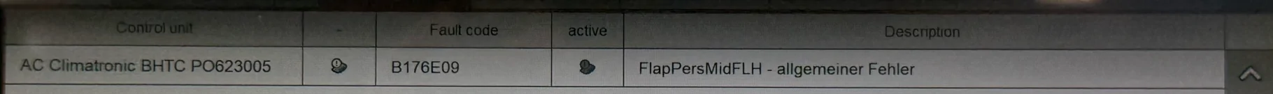

I am quite sure you will find an issue with the servomotors of the AC system. I had the same issues as you until finally there was only cold air coming out of a couple vents.
Two AC servomotors later it was fixed. Not a very big job.

Thanks for the advice. I haven't ran your tool yet (real busy, all car projects on hold since the summer), but I have been meaning to check it out. That said, I did a quick scan with PIWIS3 and here are the errors that I thought were relevant:
Porsche Taycan Porsche unable to engineer a reliable heater? 1761812040892-
Porsche Taycan Porsche unable to engineer a reliable heater? 1761812052437-wz
Maybe you can help interpret. Given the history of HV heater, I presumed my heater died based on the first error, though the last one is more consistent with your theory. What do you think?
