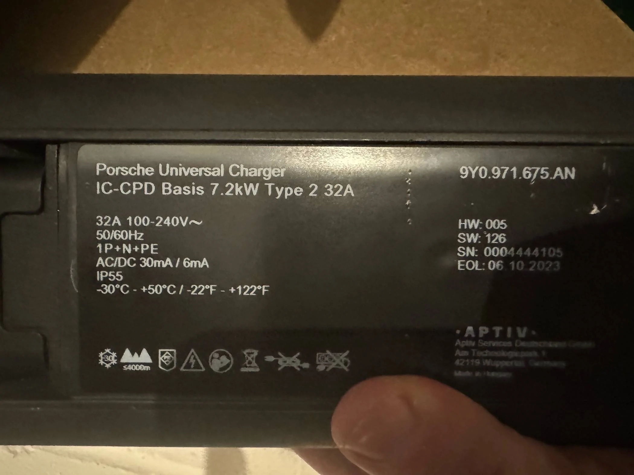

Can somone please explain to me the difference between Porsche Mobile Charger, Mobile Charger Plus and Universal Charger?
With my taycan 4s My24, I got the Unversal Charger...is this a new, old, base version of the others?
thx as usual

Universal is 7.2kW (1 phase)
Mobile charger is 11kW (3 phases)
Mobile Charger Connect is 22kW (3 Phases)

I think the mobile charger was replaced with the universal charger. I doubt it means much difference for most people as I doubt whether many people got the tail for it that allowed 3 phase charging on the original mobile charger. The cable on the universal charger is slightly thinner and more flexible

You have the latest standard offering.
All are "mobile" and only differ with maximum power output.
Historically, PMC (old) offered 3.6kW (16A) or 9.6kW (32A /40A).. PMC+ offered 9.6 kW (32A /40A). For single phase home electric supplies PMC+ was preferred as it offered more power and therefore faster to charge the car. PMC+ replaced the PMC if it was ever offered on the Taycan. Base PMC would have been shipped with Porsche hybrids.
Porsche Mobile Charger Connect (PMCC) also features and could deliver 11kW to 22kW (19.6 kW) if you had a 3 phase electric supply to feed it. Taycan has a standard 11kW AC charger on-board which could optionally be upgraded to 22kW (19.6kW) at considerable cost.
Perfect home AC charging would therefore be 3 phase supply, 22kW (19.6kW) onboard AC charger plus the PMCC to deliver the fastest home charging setup.
The Universal Charger (UC) is now the new entry point and perfect for home overnight charging - 32A supply to support 7.2kW.
Note that it is essential to have a 32A supply otherwise the available charging power will be halved. Cables also matter as do the connectors but I think the UC comes with the complete 32A setup.

Thank you so much, all clear!
