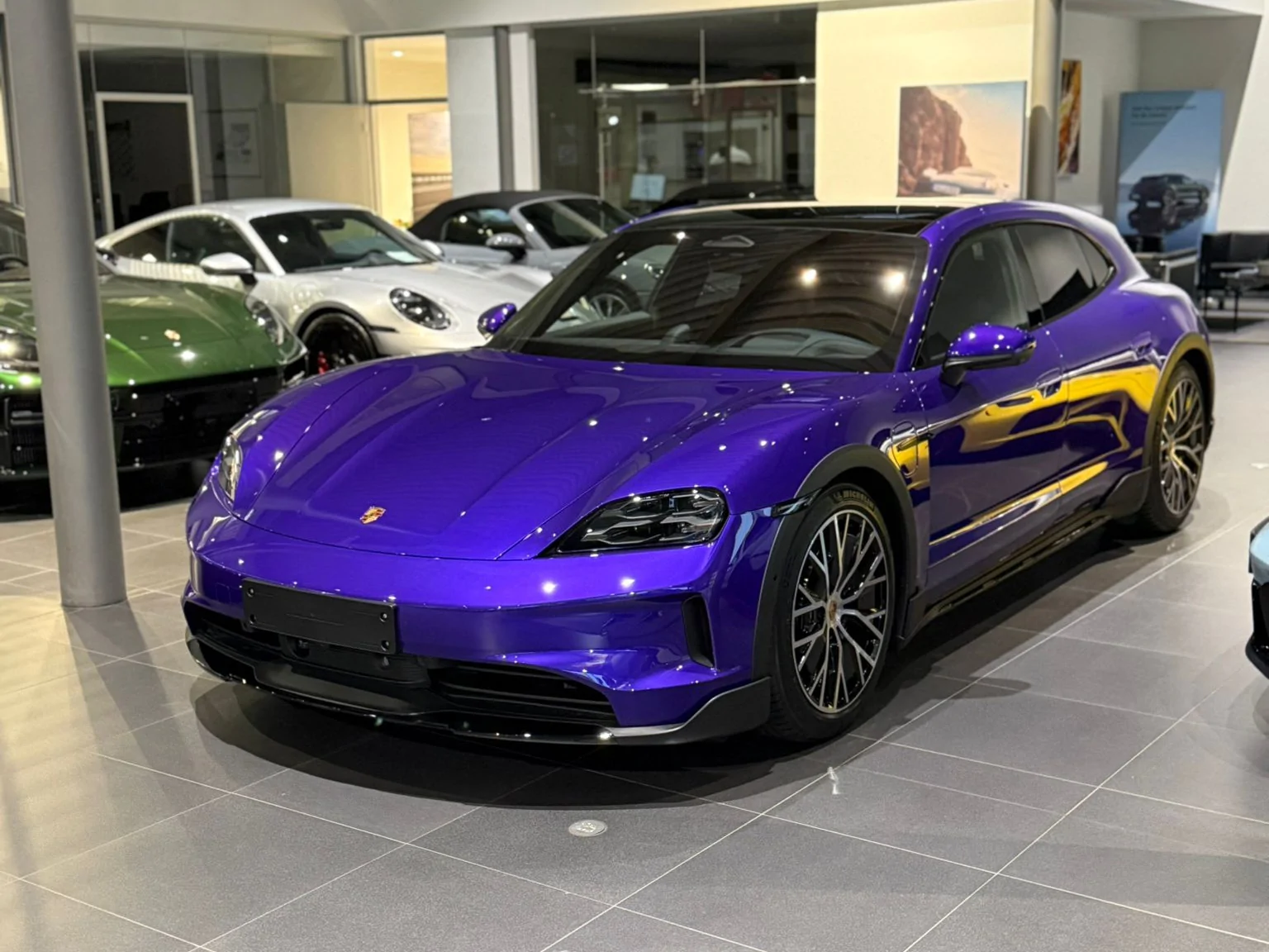

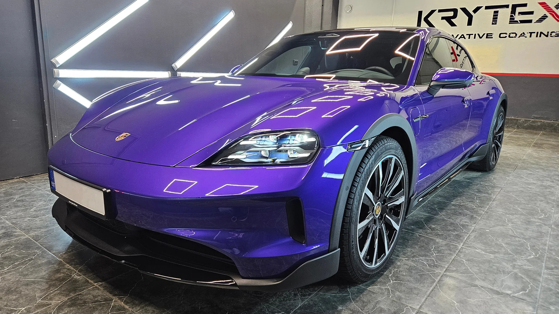

Spacers - interesting - what's the good and the bad about them?
It just looks less ugly with the 20" wheels. With the 21" you don't really need them.
See here, before and after (different wheels, but same size):
Porsche Taycan Project Purple - MY2026 Taycan CT4 pz3
Porsche Taycan Project Purple - MY2026 Taycan CT4 20260207_104557_mod
You can see how much more inside the front wheel is in the first photo. Looks ugly IMO.
On 21" you have the tyre 20mm wider and the wheel 12.7mm wider, and the offset is increased by half, so it looks good already, like you would have 7-10mm spacers built in when compared to the 20".

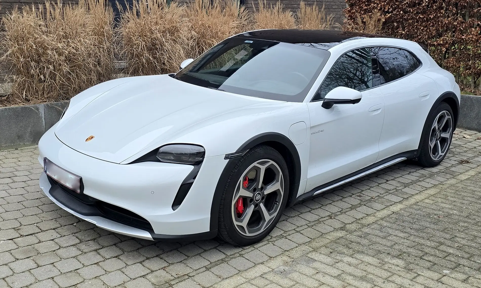

Maybe it's just me, but those are the least favorite wheels for me on the CT.
I love them, don't ask me why ;-)
For me it suits perfectly the "offroad" look of the CT.
For sure, I would not put them on a ST
Porsche Taycan Project Purple - MY2026 Taycan CT4 1770646225294-t7
