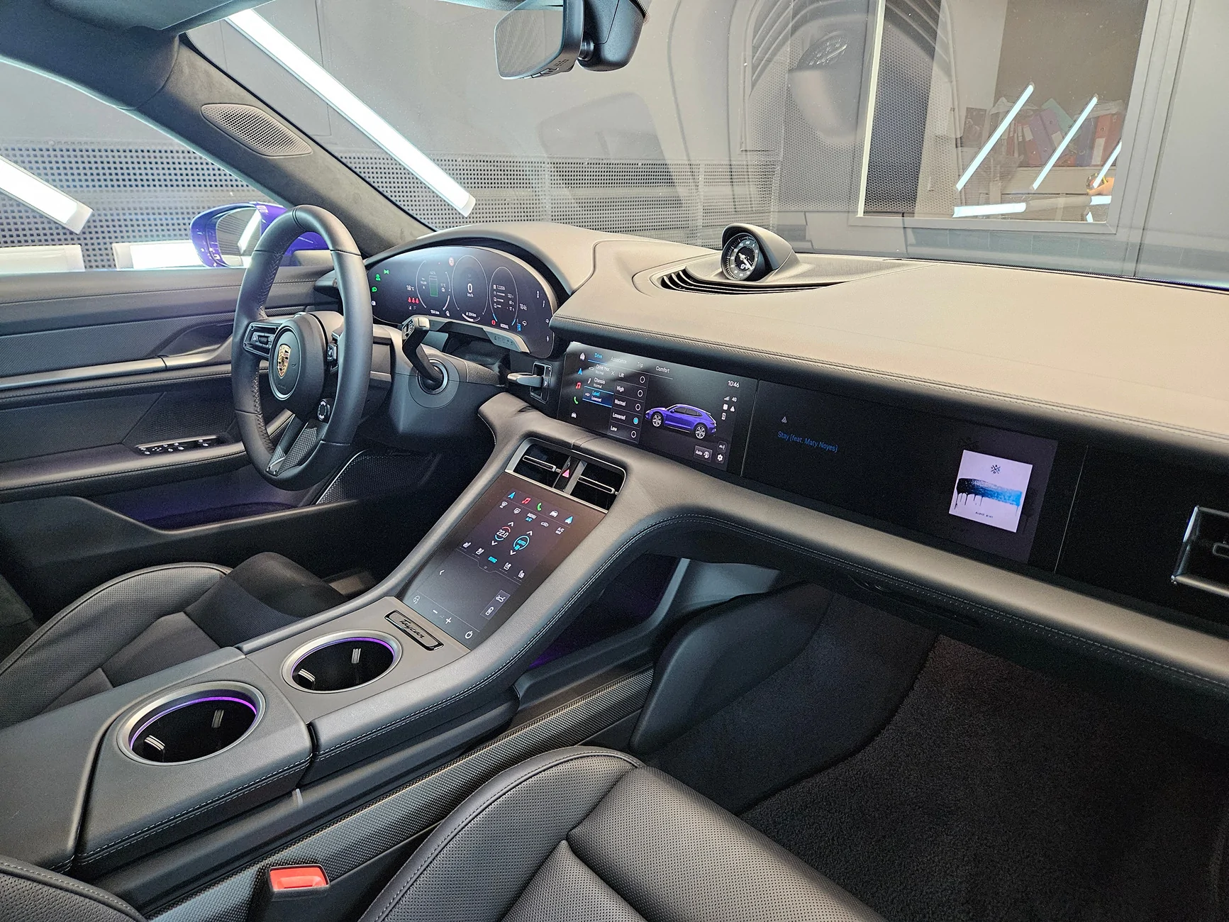

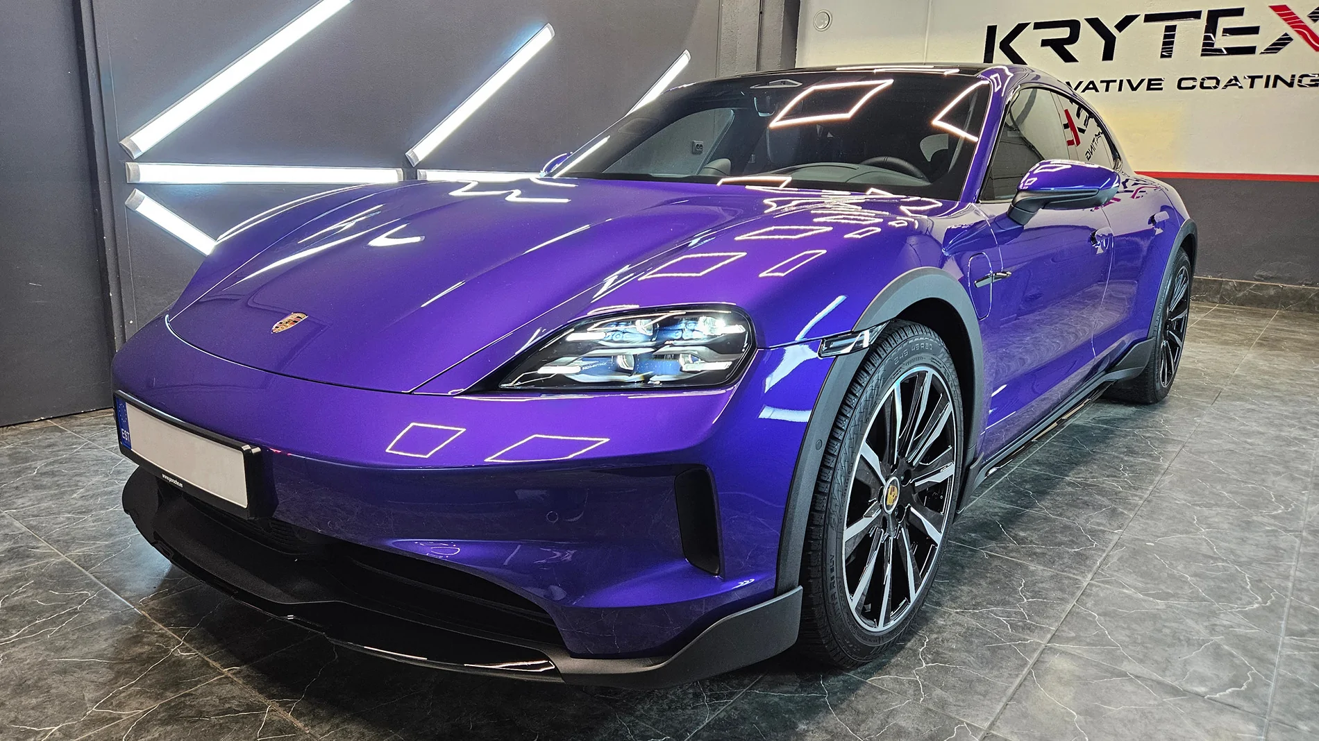

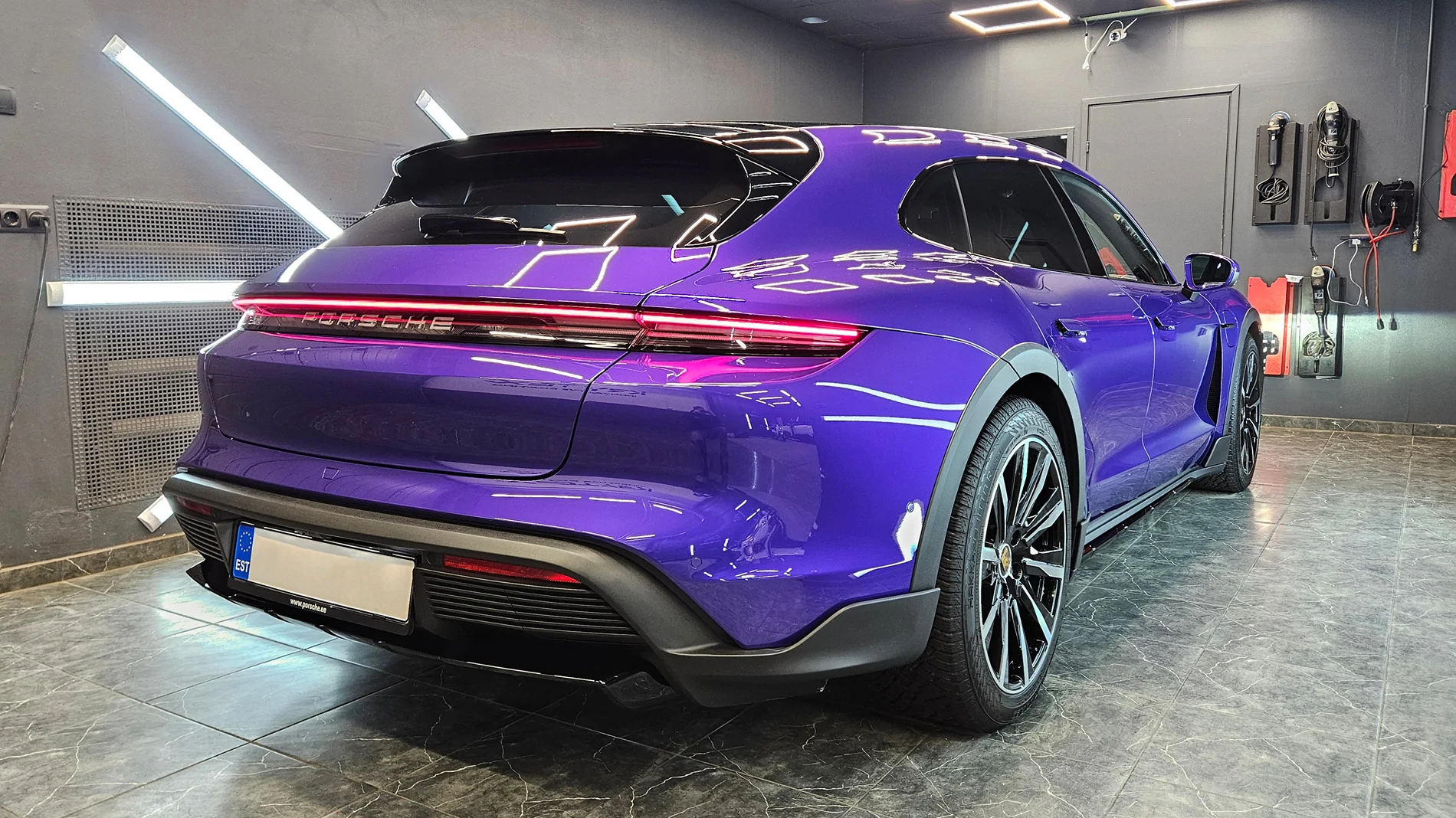

Got the car detailed:
Porsche Taycan Project Purple - MY2026 Taycan CT4 20260207_104557_mod
Porsche Taycan Project Purple - MY2026 Taycan CT4 20260207_104533_mod
PPF on front end, mirrors, under and over door handles and under the trunk cover. Ceramic coat for the rest.
They also did matte PPF on all the interior screens. I am not sure if I like the matte or if I should do it in gloss. The matte does almost completely remove fingerprint issues, but it changes the aesthetic somewhat.
It is less apparent when looking head on from the drivers side.
What do you think?
What do you think?
I'd take matte over finger prints any day, especially if you plan to take kids in the car.
What do you think?
It came out nice.
I chose full gloss because Stek is high gloss and it has ceramic coating on it. It makes it easy to work off any fingerprints.
It keeps the looks consistent with the outer edges

It came out nice.
They PPF-ed all the glossy surfaces with the matte, so not just the screens, but the entire front panel from edge to edge, and also all the buttons. But of course because there are borders/gaps between the screens you see the edges a tiny bit.

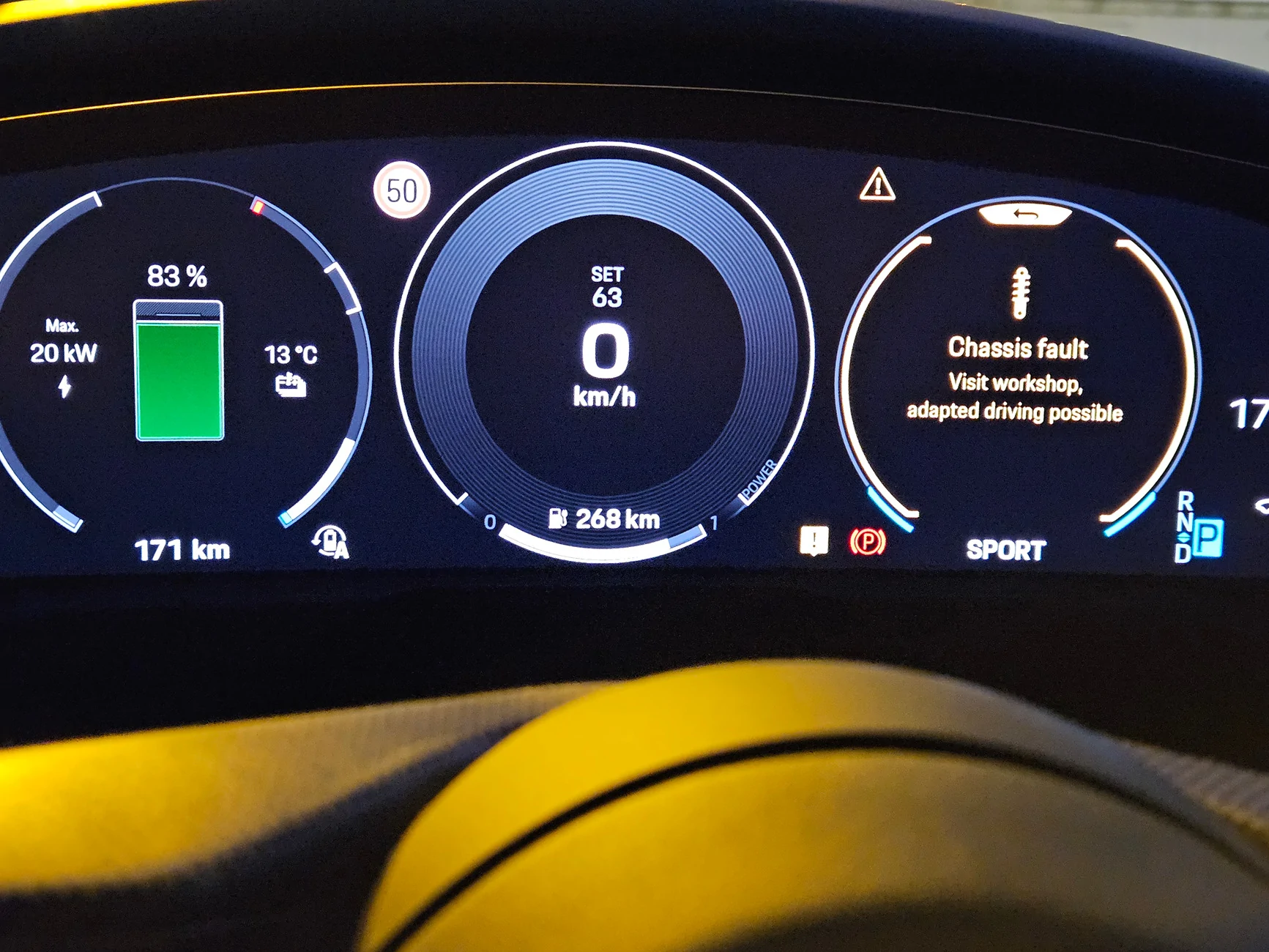

Well that didn't take long:
Not a single occurrence, had it twice already. Car has 171km on the clock.
Setting it into jacking mode, cycling ignition gets rid of the fault. Fault codes are pretty cryptic too, I'm none the wiser looking at them.
Mr.Smith
PaulS
Mar 1, 2020
2,244
2,217
Southern California
It seems issue happens early or not at all?
prj
prj
Jan 14, 2025
1,772
2,351
Estonia
www.mapev.net
Taycan CT 4 - 2026
No it happens during driving.
Seems like it's related to RAS:
Code:
System name:         CB - Rear Axle Steering
Workshop ID:         ----
Software number:     976501605G
Software version:    1200
Hardware number:     976501605G
Hardware version:    H01
ASAM ID:             EV_RearAxleSteerZFPO633
ASAM version:        003
FAZIT:               ZFL-14601.12.2504509083
VIN:                 WP0ZZZY18TSA44306
1 DTC entry:
              372    Rear axle steering
          C11D196    internal malfunction
         00001000    not active
                     confirmed
                     MIL off
Chassis control just has the statement that the function is restricted:
Code:
System name:         74 - Chassis Control
Workshop ID:         2V2K
Software number:     9J1907715AN
Software version:    1112
Hardware number:     9J1907715G
Hardware version:    H04
ASAM ID:             EV_ChassContrContiPO633
ASAM version:        005
FAZIT:               TSR-K7405.09.2509260657
5 DTC entries:
        11867220    Damper
         C13B6FF    Forced activation of stability control (ESP)
        00001000    not active
                    confirmed
                    MIL off
        11866401    Damper control active
         C13F0F0    Function restriction
        00001000    not active
                    confirmed
                    MIL off
         3211314    Function restriction
         C10C200    not active
        00001000    confirmed
                    MIL off
        11867218    Indicator lamp for chassis control
         B19F3F0    Message, yellow
        00001000    not active
                    confirmed
                    MIL off
        11866985    Damper control active
        00001000    not active
                    confirmed
                    MIL off
