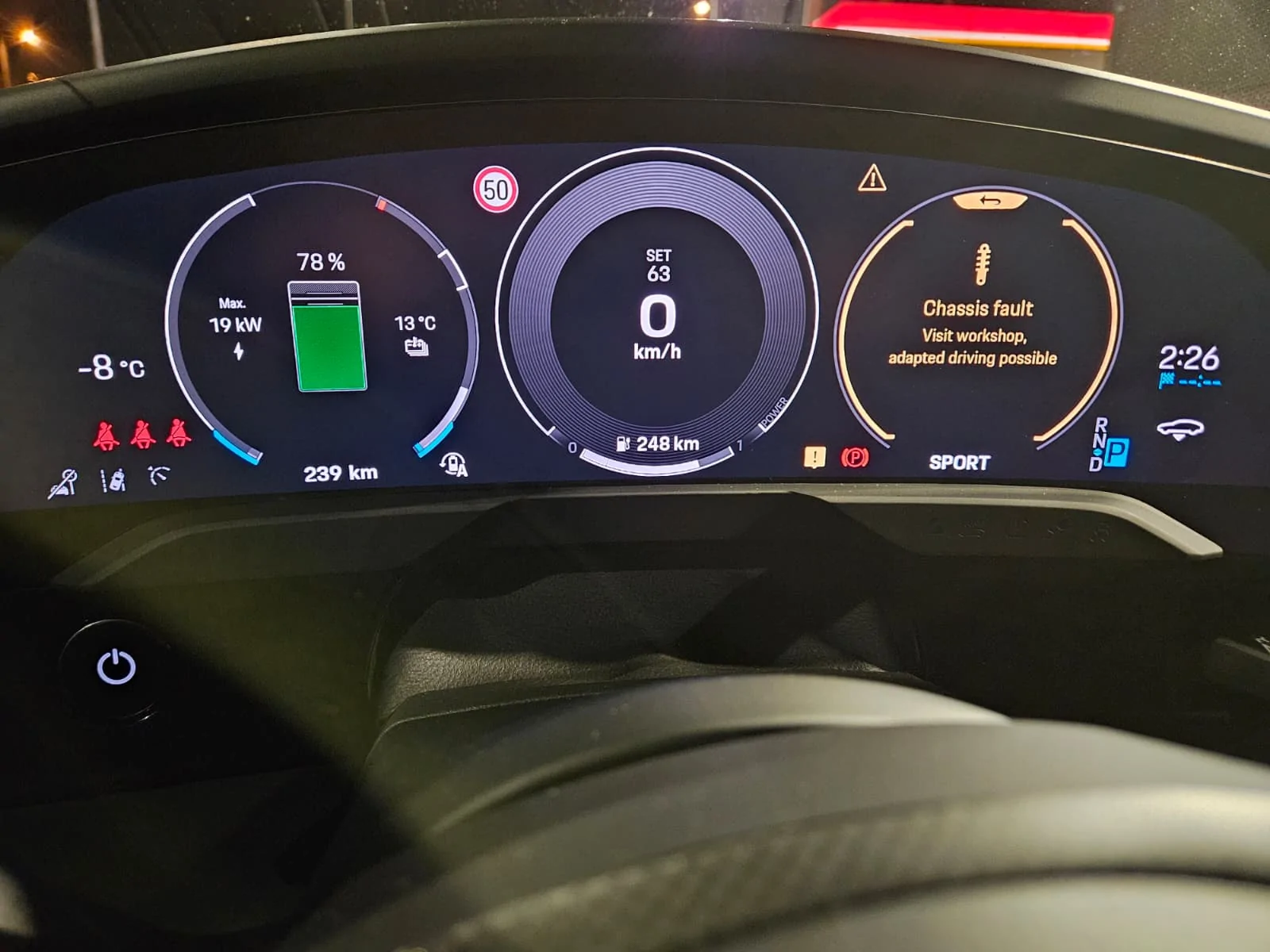

Its a RWS or PAR error?
My tool showed an error in the RWS module.
They did the whole suspension commissioning process. I am guessing that calibrates PAR too.
I'm going to keep the car like this for a bit and see what it does.

Error happened today while being very close to the Porsche dealer.
Called my service rep and they were able to take it in right there (30 minutes before closing).
We made sure the ignition never turned off, and they were able to get a full fault log and a video for Porsche central with the error active.
It always happens when coming to a stop or just after starting to move the car.
They said they had one car with a PAR issue, but there it was making all kind of strange sounds in the rear. They replaced one air spring, but that did not change anything, after that they replaced the rear PAR servo, which was on backorder for over 2 months. This fixed the car, and it didn't have issues since.
Though in my case the PAR is not making any strange noises at all, and the DTC that I get is definitely in the RWS module with the suspension controller just logging a bunch of reactions. When the error happens the car drives completely fine, the only thing that doesn't work is the rear wheel steering.
The service rep did say that if there is a par error the RWS also gets locked immediately though, but let's see what the factory says...

Car was at the dealer yesterday for a suspension check. Got to drive an ICE cayenne, and thats just as horrible as I remember.
Long story short - front left strut has an air leak. They are going to be changing it once the part arrives.
So at least at the moment they found nothing wrong with PAR or RWS rather an issue with the air suspension. Let's see if it solves the issue...

Could be. They have a special test procedure for the suspension that takes a couple of hours.
They explicitly said that it's not PAR though, but the front left strut leaking air, but since it's all one unit the entire thing is getting replaced.
Well, now waiting for the part to come, they will call me next week to confirm the installation date.
