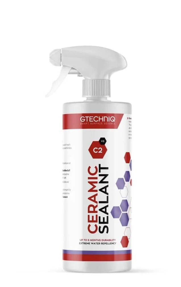

If you talk to a good detailer, I think he will be pleased with your routine. Some recommend drying with a special blower or good electric leaf blower to get rid of most water.
Your routine should make the ceramic coat last a long time. As mentioned by others, adding some easy to apply additional ceramic coating as maintenance is good. But be careful to do this in the shade or in a garage, else you may introduce streaks etc.
I have used one of these with a foam gun and got great results. super easy and quick to apply. There are many similar formulas in the market though.
