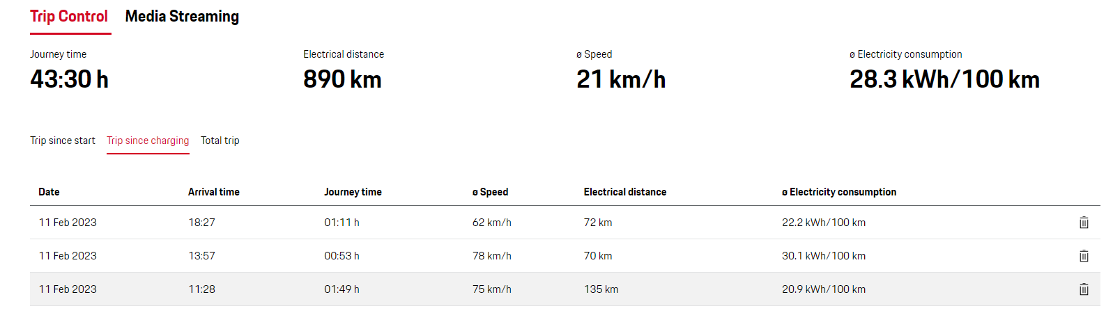

My Taycan just over 2 weeks old. I am happy on today's motorway performance / consumption. Outside temp. 5-8 degree C.
Best 20.9kwh/100km

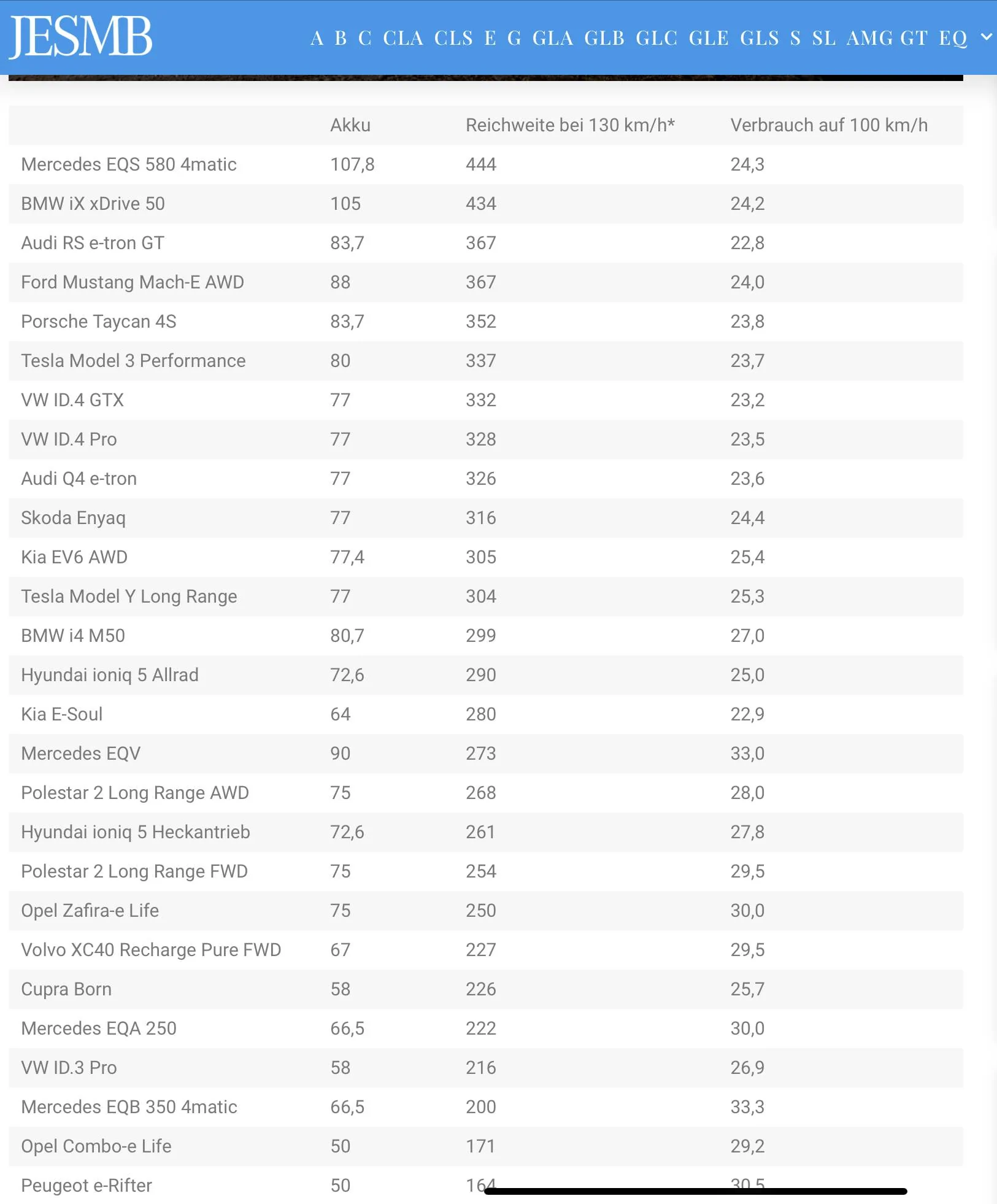

Here is an another interesting consumption statistic. For reference this seems to have been done at different external temperatures so not quite comparable. Think the temperatures were between -1 C and up to nearly 30 C in some document.
Taycan scores pretty well again

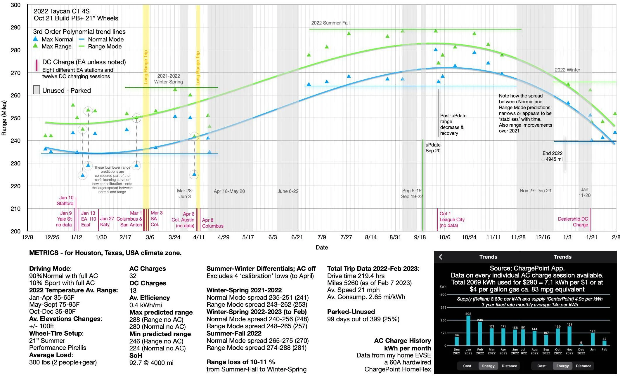

Here's some data from my car in a much milder climate :)
Nonetheless with a year plus of data the winter 'losses' in respect predicted ranges is right on the money re marketing of 10-11%. Of course a ton of variables to consider when comparing like-car setups to different climate and terrains.
Interestingly despite very similar temp ranges the second winter season is seeing a slight improvement in range estimation despite comprising almost entirely short local trip distances.
Fantastic set of data - thanks for sharing with us.
What would also be interesting is how the predicted range compares to actual miles driven. I appreciate a huge number of variables will affect this, not least the length of journeys.
You're getting much better ranges than me overall (Taycan with PB+ & 20" wheels), especially in warmer weather in the UK where I seldom get anything over 250 miles. For me, the big drain is short trips in cold weather. I can start with it showing 200 miles, travel 10 and end up with 175 or less in very cold conditions. Of course this is mainly due to the large draw to heat the car and the battery, but it is much higher than I expected.

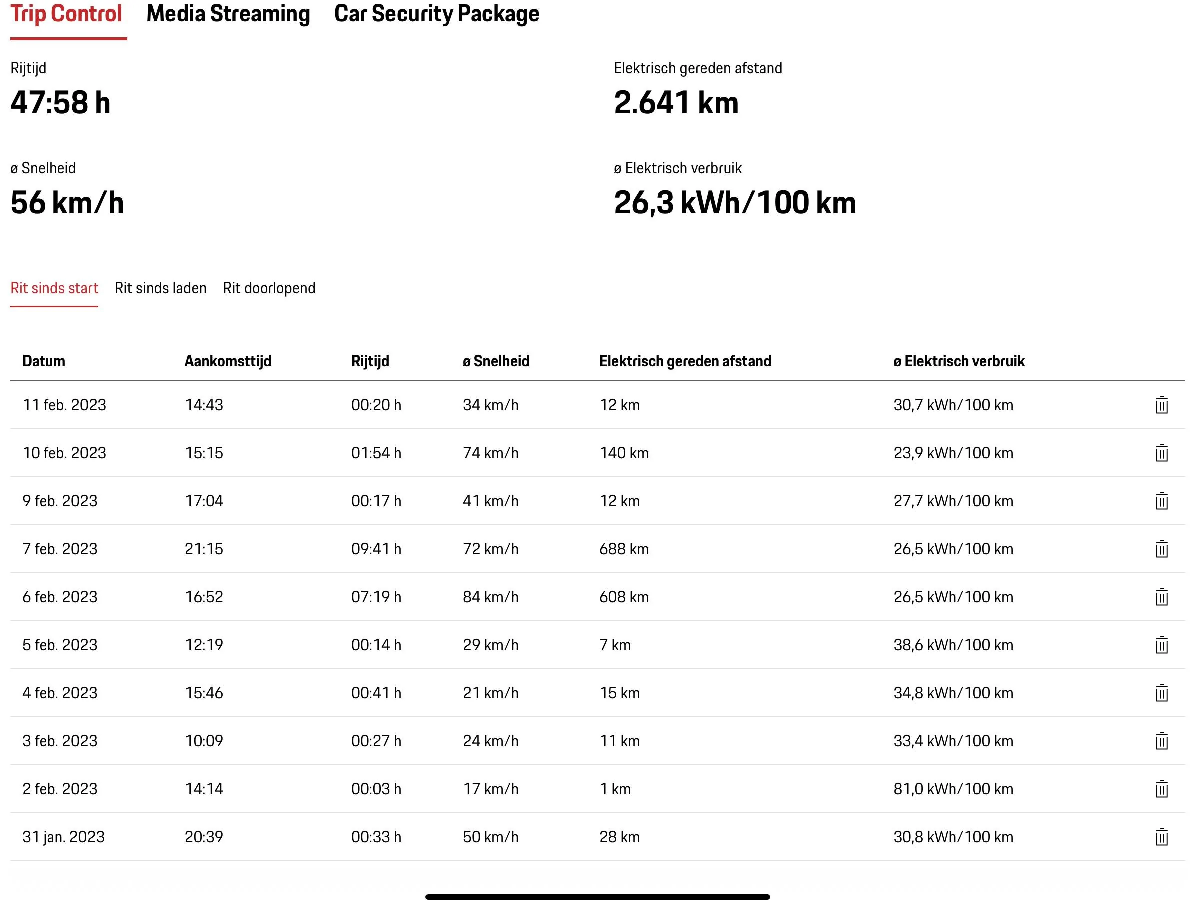

Over the weekend I drove 330km to the centre of Sweden and back again in my Taycan Turbo CT with 20" Winter Pirellis and fitted with the optional heat pump. Used range mode most of the time, with heating on and heated seats for 3 people. A little use of cruise control, but sometimes turned it off due to weather and road conditions.
I got 25.4kWh/100km on the way there in a mixture of -1.5C to 5C in very harsh winds (we had to get out several times and clear the road of debris), plus snow & rain.
I got 26.4kWh/100km on the way back with about the same temperature but mostly good weather and sunshine, with wet to icy roads.
I think the increase was due to the increased speed I was travelling. I found it quite hard to stick to a speed which is good for range.
But we don't buy a Porsche for its economy! It's a very heavy performance car and I'm happy to drive it!
Thx, no prob. - if interested also have an SoH thread too here with over 30 participating cars to date:
https://www.taycanforum.com/forum/threads/baseline-for-hv-battery-soh-on-delivery.12815/
Indeed, based where I am, I very rarely have to use the heater in my car, only sporadically for a month to max. 2 and typically in Jan-Feb.
In respect 'real 'word' consumptive numbers the best read is probably the 2.65 mile per kWh average for all miles driven to date.
