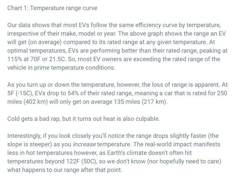

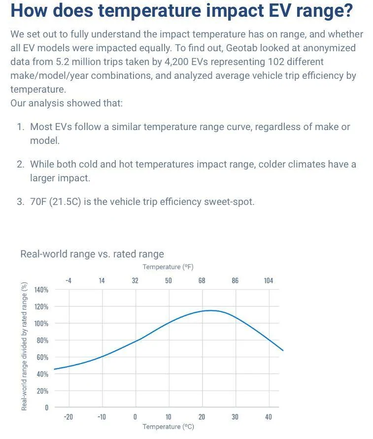

Here is a decent overview based on a very large dataset in respect how external temps affect range. Obviously cold weather a known factor but very high temps as in my local area can have an equally detrimental impact on actual range achieved - and the little data we have to date may further indicate a bigger hit on SoH at least initially in very hot climates.
I throw this out there as even last night here in Houston with temps in the low 30's here my battery at 7 AM this morning was still 50F; whenever I complete overnight charging sessions the end state (85% SoC) has temps typically 85-90F but in very cold weather down to 70F.
In either case a good starting HV temp and hence why even on short trips driving style does matter i.e. my definition of style includes average speed (e.g. say 80 mph for 10 miles of highway vs 60mph); rapid launches from every stop on that short trip etc., which will impact the short trip range but of course in a relative sense to longer trips.
As in the link I shared in the prior post above the consistency of external temperature ranges and hence static HV battery starting temps for my use case are near fixed simply due to the local climate conditions that prevail here, as are other factors for me like terrain/elevation, load, wheels/tires. This allows me to look at my data and surmise why I still see some very notable changes in consumption through a large set of short trip data. Which brings me back to style (speed, launches etc) coupled with trip length-duration as being more important factors on range again in my specific case - most definitely others and YMMV - actually will vary ;)
https://www.geotab.com/blog/ev-range/
Couple of extracts from above link and of course there are numerous other more rigorous datasets out there and posted on this forum specifically documenting HV temp controls on EV performance:

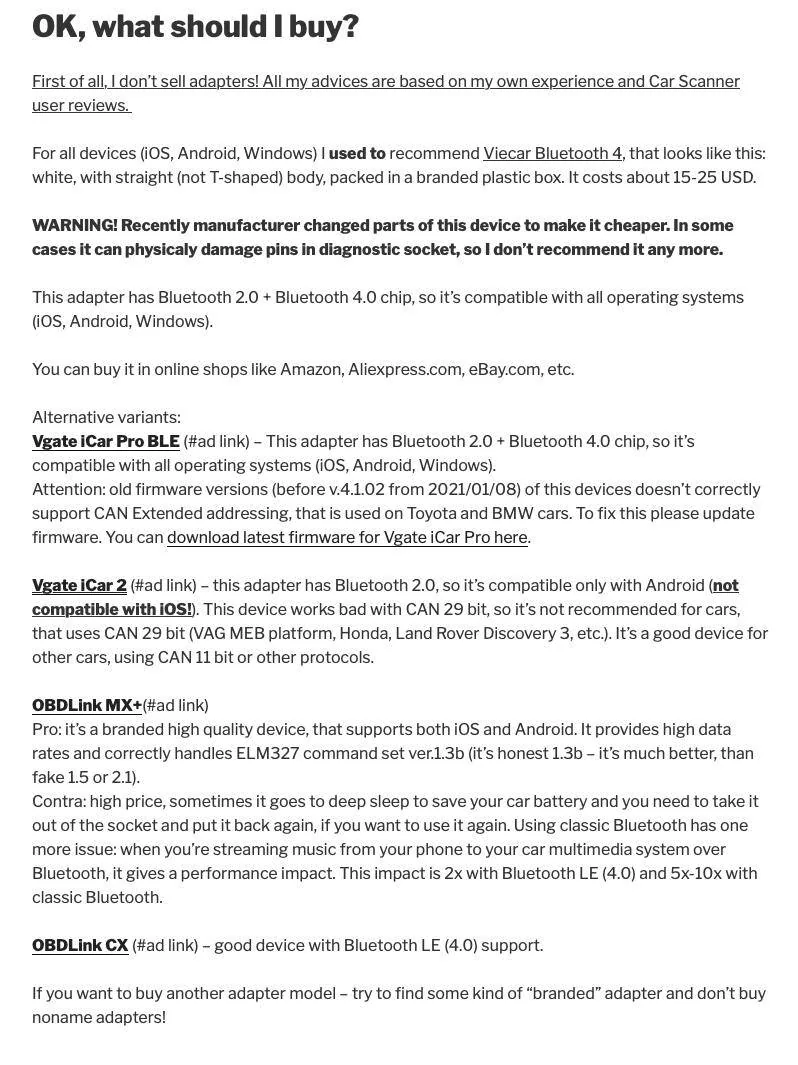

One critical thing for the OSX/iOS application is that you need a scanner that is Bluetooth 4.0 compatible - Bluetooth vs 1-3 scanners will almost certainly not be compatible with your car+iPhone.
This one works seamlessly with the CarScanner app (free) on iOS/iPhone and the app has a dedicated Taycan setting preloaded. I know this first scanner is China sourced (possibly ripping of thee tech) which understandably some dislike:
https://www.amazon.com/gp/product/B088LW211V/ref=ppx_yo_dt_b_search_asin_title?ie=UTF8&psc=1
This second source might be a more 'official' source but obviously a lot more expensive - I need to recheck the official site address ...:
https://www.obdlink.com/products/obdlink-mxp/
And if of interest, a site with some overviews:
https://www.carscanner.info/choosing-obdii-adapter/
Example of recommendation:
Porsche Taycan Range ST GTS Screenshot 2023-02-22 at 10.57.44 AM

I bought this one:
https://www.amazon.co.uk/dp/B07LDDWTJG?psc=1&ref=ppx_yo2ov_dt_b_product_details
Car Scanner connects to ELM fairly quickly but remains disconnected from ECU, at least while “on” but sitting on my drive. I didn’t try driving with it connected.
It would be a shame to accidentally scramble the ECU so I gave up!

Odd indeed - possibly some issue with the physical connection and may need to check with manufacturer but invariably a pain!
Well if you ever want to try an alternate, the vLinker MC+ most def works with multiple forum members having used it to date but understand you don't want a closet full of OBD scanners!
