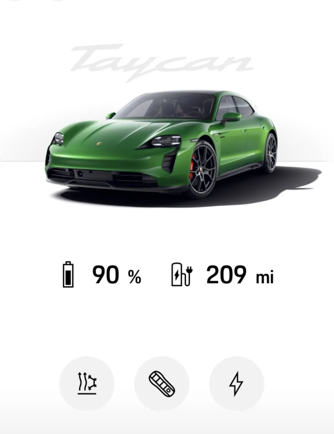

Porsche Taycan Range ST GTS IMG_4729
Non ST GTS after run in, winter, ca. 40% highway with relatively high speed (no ticket up to 147km/h) so ACC on 150km/h. SoH 98%.

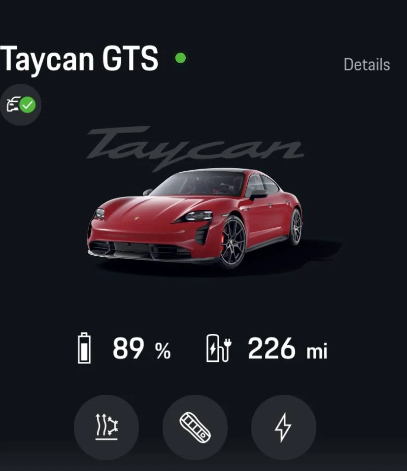

Yes
This is right now from the app. Scotland in winter, that’s a reasonably accurate figure as long as it’s not all short trips
Porsche Taycan Range ST GTS F7CD22CD-922B-471E-A888-FBE0D04D22B7

I don't think a photo of the charging screen tells much without other data, particularly in winter.
What mine shows when I have just charged to 80% and the battery has warmed up a bit is sometimes 10% more than the next morning when everything has cooled down again.
Anybody using the timer to charge just before they drive the car will have the battery condition closer to optimum than somebody who just jumps in the car cold so will probably always get better displayed range.
Personally I largely ignore the displayed range now since the calculation varies with battery temperature and keep an eye on miles per kW/h for individual trips and overall.
