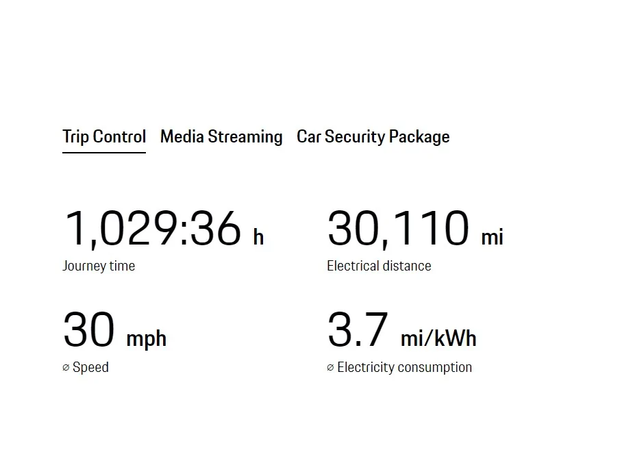

just had a look, for the first and probably last time ever................
Porsche Taycan Real Range of Taycan Screenshot 2023-09-29 135902
Thanks for that.
Crikey! That would be 310 miles on 100%.

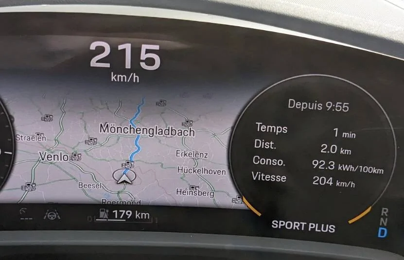

Here two extreme examples:
Porsche Taycan Real Range of Taycan PXL_20230817_181353031.MP
that's about 3.9 mi/kWh. Summer, national road, low steady speed (around 45/50 mph). Feasible ... but why buy a Taycan if you plan to drive it like this every day.
Porsche Taycan Real Range of Taycan pxl_20230619_075628453
or ... 0.7 mi/kWh. Summer, highway, Germany, a bit faster... but if you plan to drive it at these speeds every day, better buy a ICE car: range won't exceed 60 miles here ?

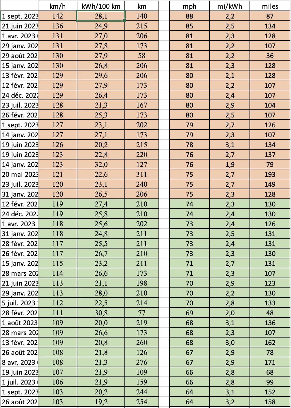

Now, real use, over a year, at different speeds : on highways, but different weather conditions.
Porsche Taycan Real Range of Taycan Screenshot 2023-09-29 at 20.19.54
orange rows are for average speeds above 120km/h (75 mph). At same av. speed (80mph), i've seen 2.1 mi/kWh (winter) but also 2.9 mi/kWh (summer)
green rows for av. speeds between 100 km/h (65mph) and 120 km/h (75mph). At same speed (70mph), i've seen 2.2 mi/kWh (winter), and 2.9 mi/kWh (summer)
but also 2.2 mi/kWh at both 88 mph (summer) and 70 mph (winter)
Conclusion : it's between 2.0 and 3.0 mi/kWh ?... and range has never been an issue, in all the trips I've done in Europe.

real range depends on soo many parameters ....
So a range of between 166 and 250 miles.

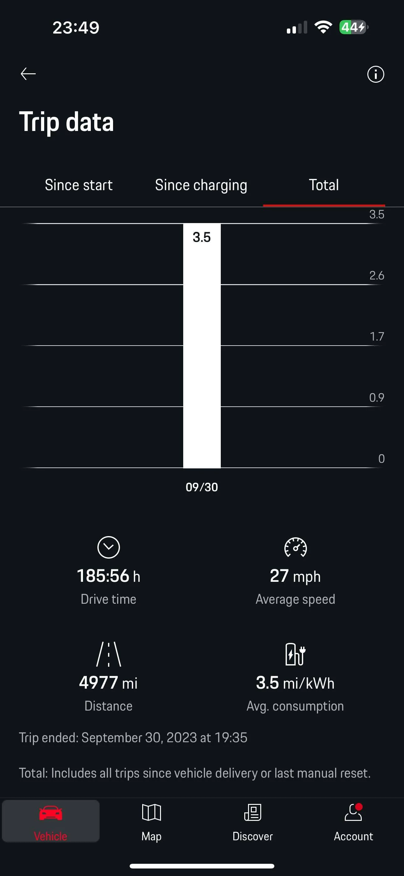

I agree the total miles/Kw seems overstated. Ours shows 3.5 miles/Kw, but when I review daily data, we tend to run between 2.8 and 4, with about 80% of the trips around 2.8-3.2 mi/kw.
This is a Taycan Turbo.
