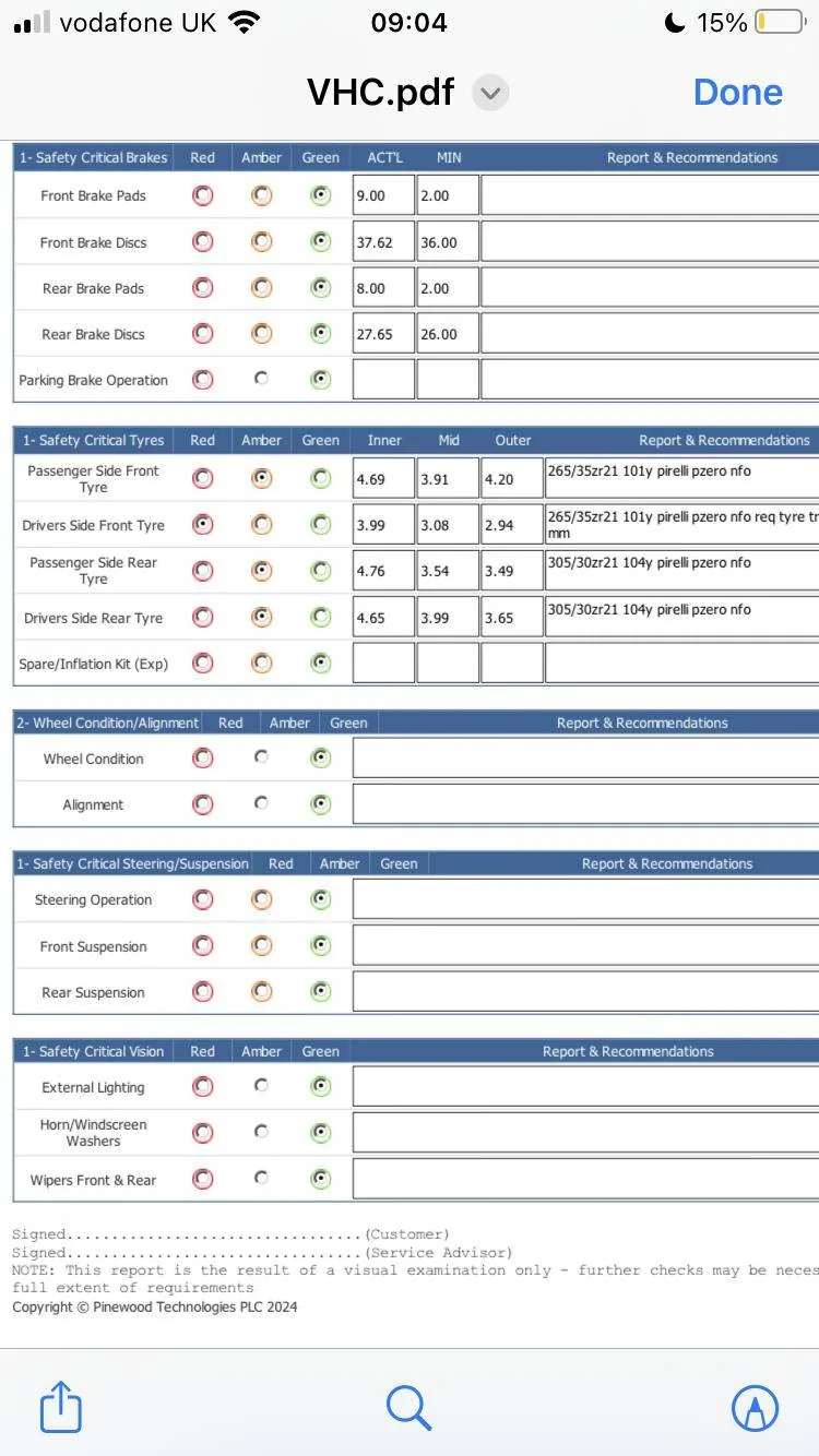

This is my report at 13,600 miles.
The front passenger tyre was replaced due to side wall damage so has only done about 5000 miles.
Fronts have worn worse like most people report here. Also outside corners worse than the inside.
Fairly even though?
Porsche Taycan Rear tyre wear IMG_4606
You can see how gently it has been driven because the brake pad wear is effectively nil.
