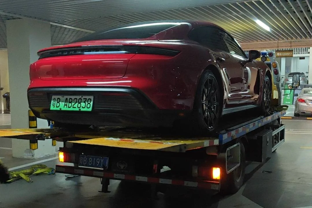

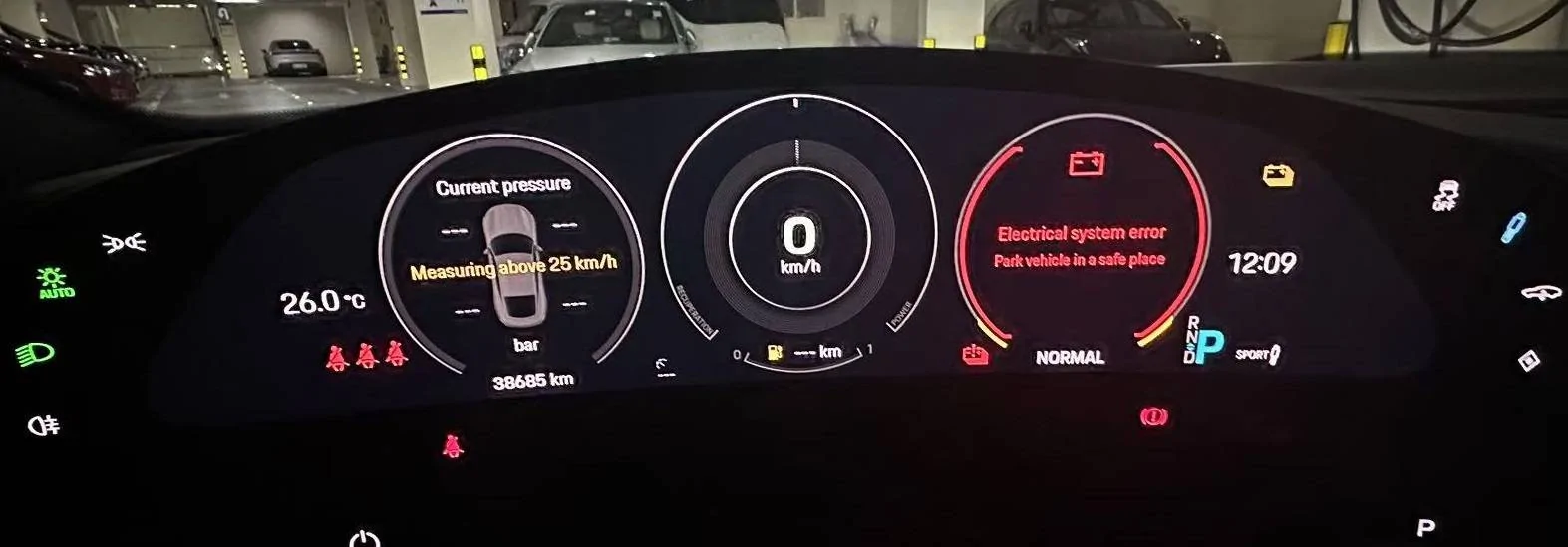

Just got it back end of August, now after 2 weeks parked again:
Porsche Taycan Red Circle of DEATH 7d587799423c491dd00ade29a96937
Porsche Taycan Red Circle of DEATH 39e543953140685867d476381925ca
3rd time within a year.
Just a reminder: I paid 230k USD in 2020 for it. Today a kWh costs around 80 USD. Why can't Prosche upgrade the battery, so that I have a car I can actually drive?
