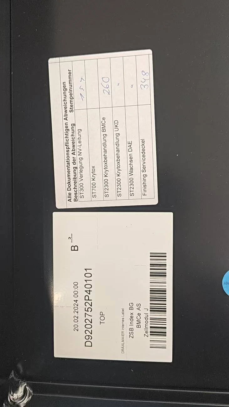

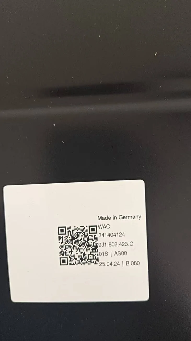

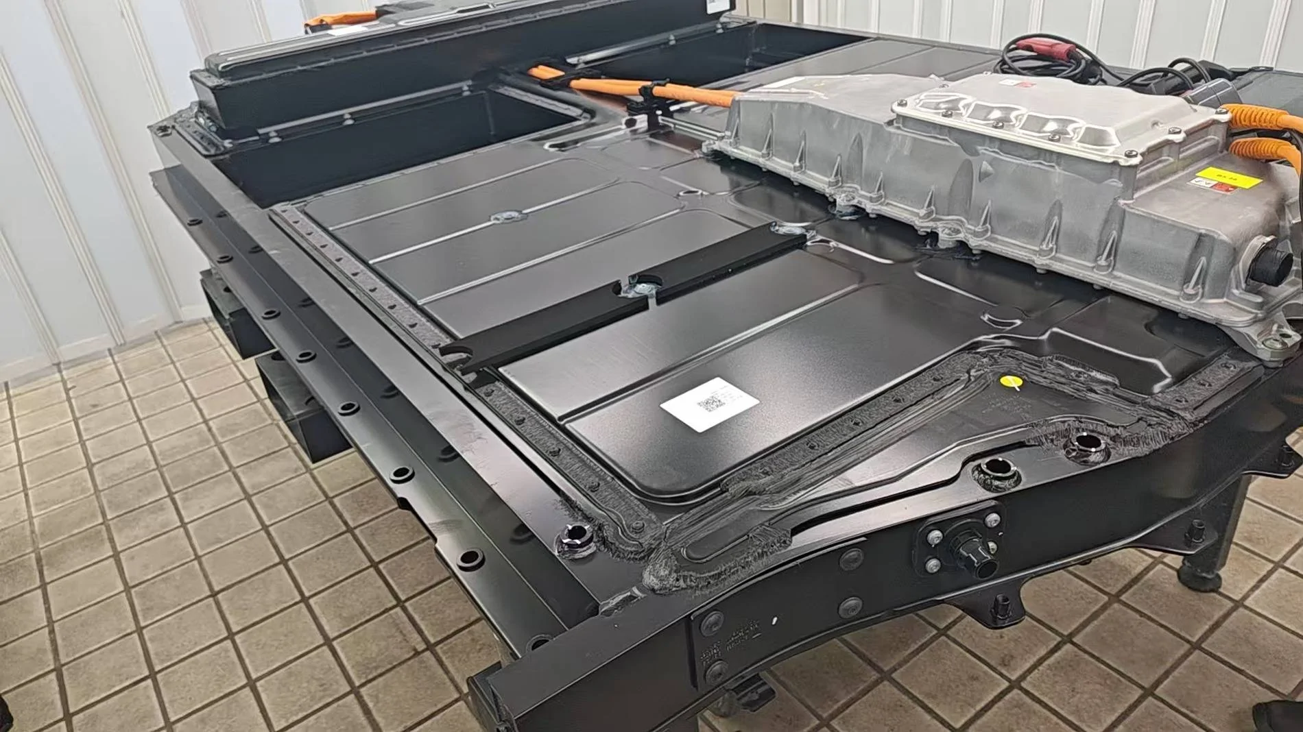

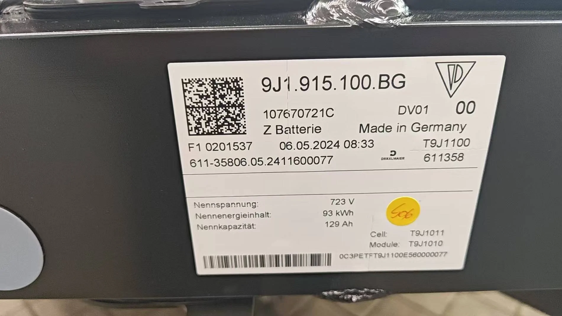

Has been installed now!
It says Zellmodul J, but based on this thread, I could not figure out if the quality is good.
Does anyone know more about this battery pack? After 3 module failures and 5 months in the shop over the past 18 months do I finally have a solid car?
I hope it works for you ????
As a recipient of a new battery after 3 1/2 years and 40K miles, I would say you are in very good shape. Definitely get an OBD reader and check your voltages regularly at <10% and 100% just to make sure.

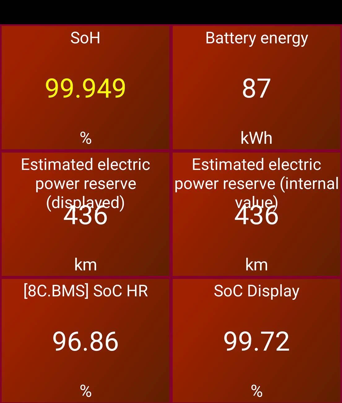

25K miles only. I hope it's more reliable now, otherwise I give up on Porsche for good!
Porsche Taycan Red Circle of DEATH Screenshot_20241230_095952
Unfortunately the capacity of the battery with 87kWh is not up to date anymore!
