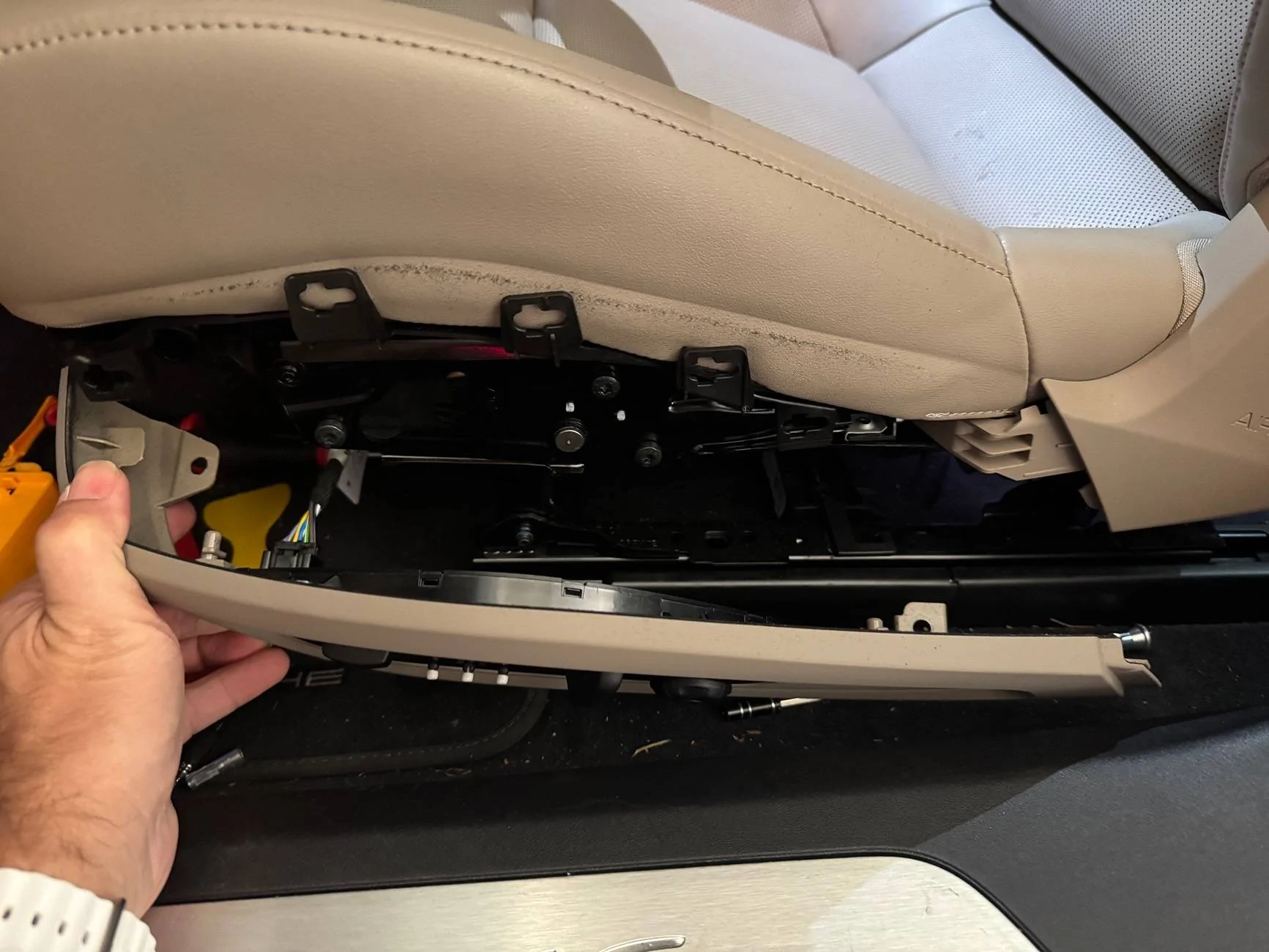

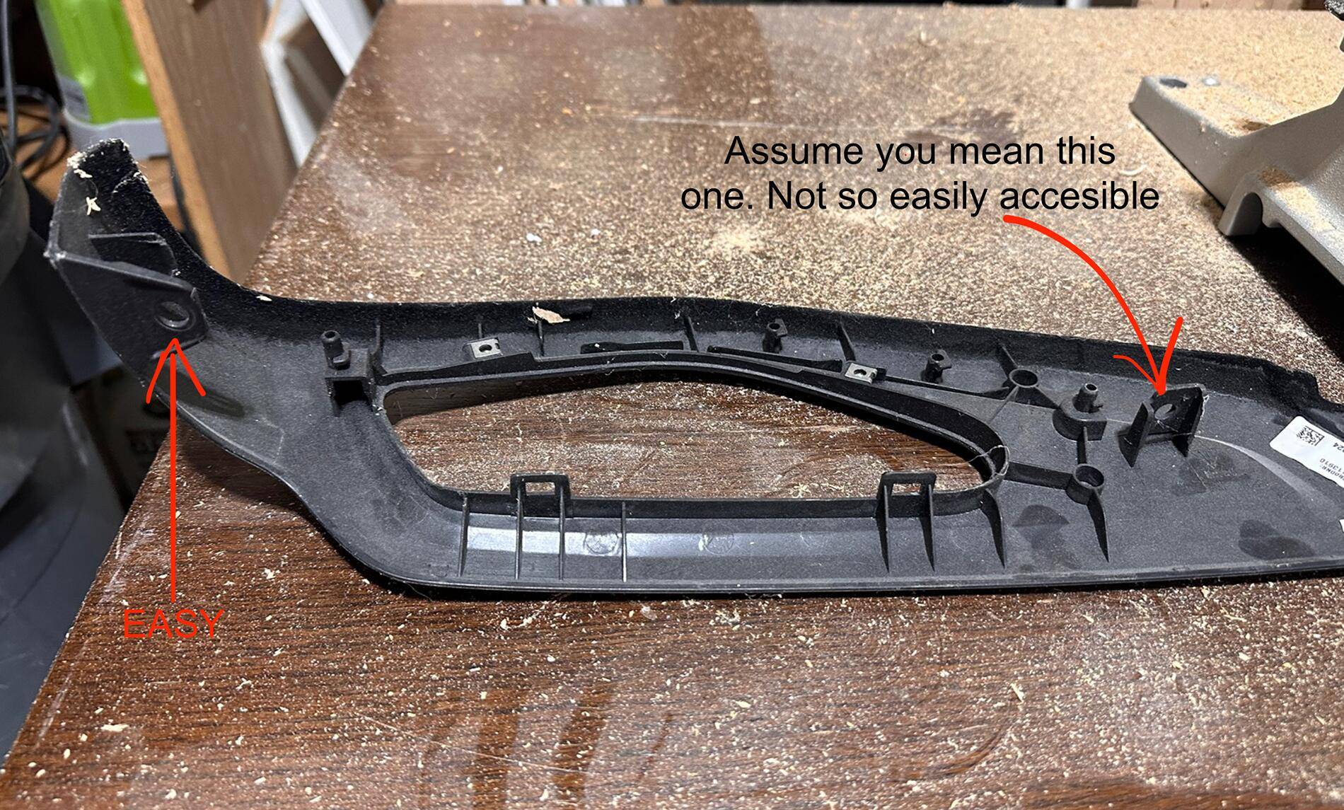

Thank you so much for taking the time to post these. I will look more closely once my part arrives in a week.
I was hoping just remove marked red easy one below and pops off and then can remove the buttons component. But appears a more difficult screw in the rear if I understand. Not sure I understand the part about removing the seat and what exactly, but I'll look more closely and cross that path once I get there. I'll try and take some photos/video of too then. Thanks again.
I was hoping the same, I didn’t have a tool that could work at that angle, so just took seat out which made it trivial.

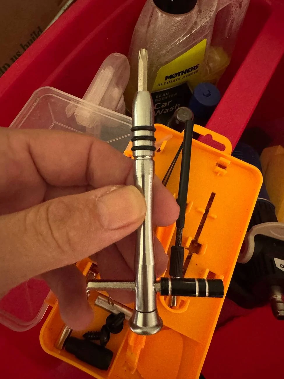

Thanks again! Provided needed inspiration. Here’s what did it for me (tool cheap on Amazon).
Porsche Taycan Seat button fell off IMG_3769
Porsche Taycan Seat button fell off IMG_3770
