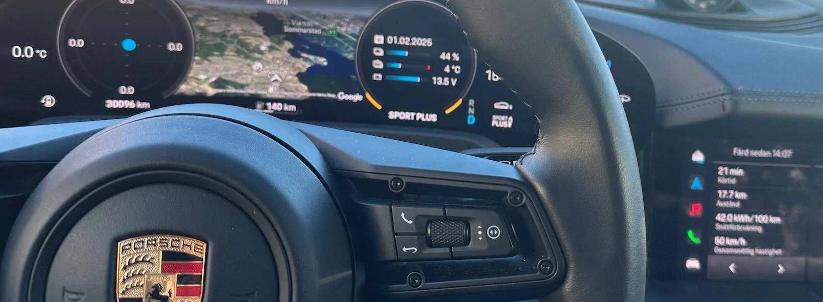

Ye, but I have run 10 minutes with sport plus. Battery goes from 0 to 4 degrees. Parked the car for 45minutes. come back. Battery temp 4 degrees. Run sport plus for 10 minutes while driving. Battery still at 4 degrees. See below. 0 degrees outside. 4 degrees battery. S+
Porsche Taycan Seized cooling fans. Skärmavbild 2025-02-01 kl. 17.54.25
I can not tell you how the car will behave at such low temps, as i park indoor, and have never seen my battery below 10 degrees.
If it is a big concern to you, just make an appointment with your local center. If the car is under warranty, all will be for free.
Good luck
