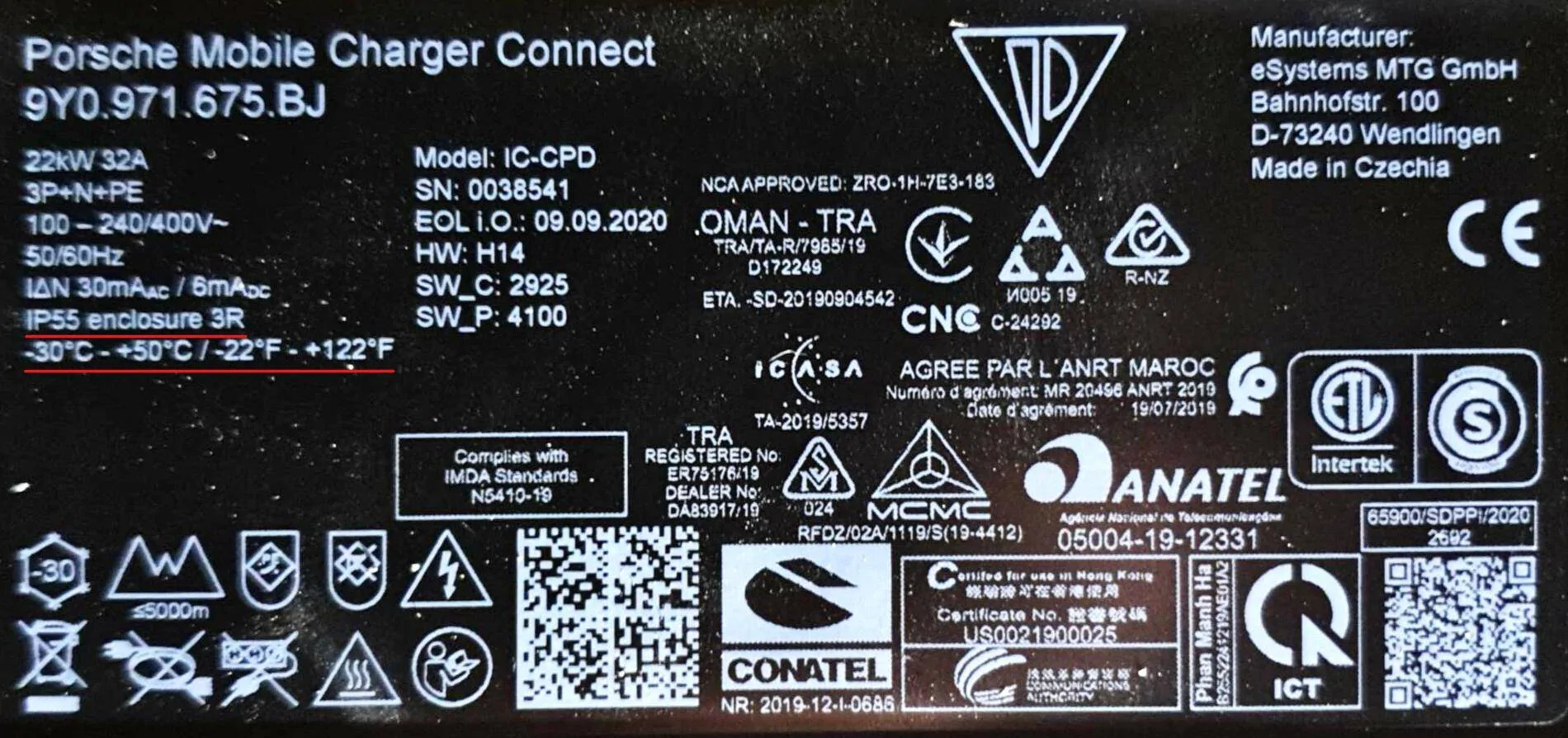

I don’t think the PMCC is outdoor rated unless it’s in the dock - but I could be wrong.
It's clearly rated for outdoor, and the plug is rated IP44.
Below is the nameplate of my Charger

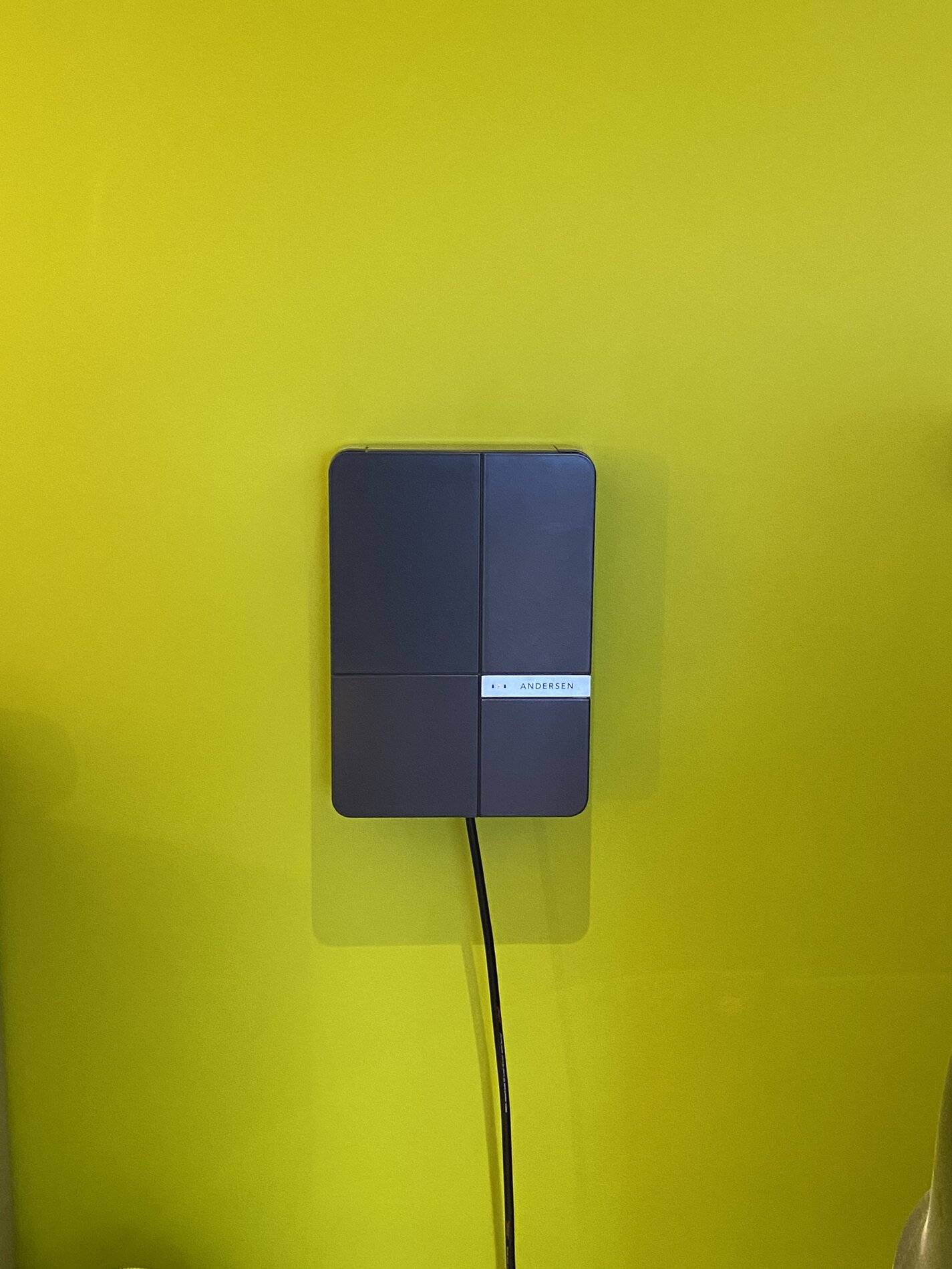

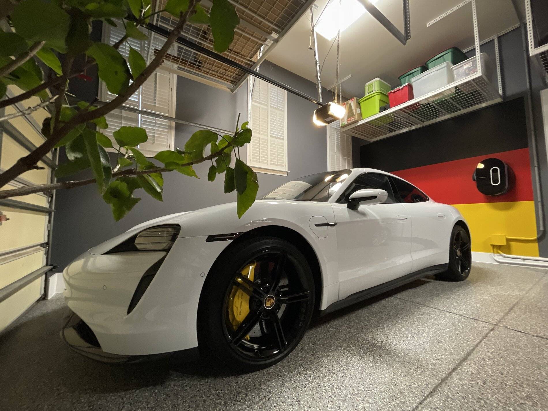

My Anderson A2 has been installed, and as per their blurb, is charging at 7.2kW (I was getting a charge rate of 3.6kW from the Porsche Mobile Connect unit). This is for a UK property with a single phase 32 amp supply. Very pleased with the installation and reduced charging time.
Porsche Taycan Show your home charging setup for your Taycan 1FE1F742-EED1-43CB-88C5-DAEA373A7ADE
Nickj
Nick
Jun 29, 2020
772
308
Crayon 4s
Thats a very yellow wall, Norfolk yellow?? Is it mounted inside a garage. Looks smart. I like the Anderson, but as no one would really see mine couldn’t justify the extra £££
