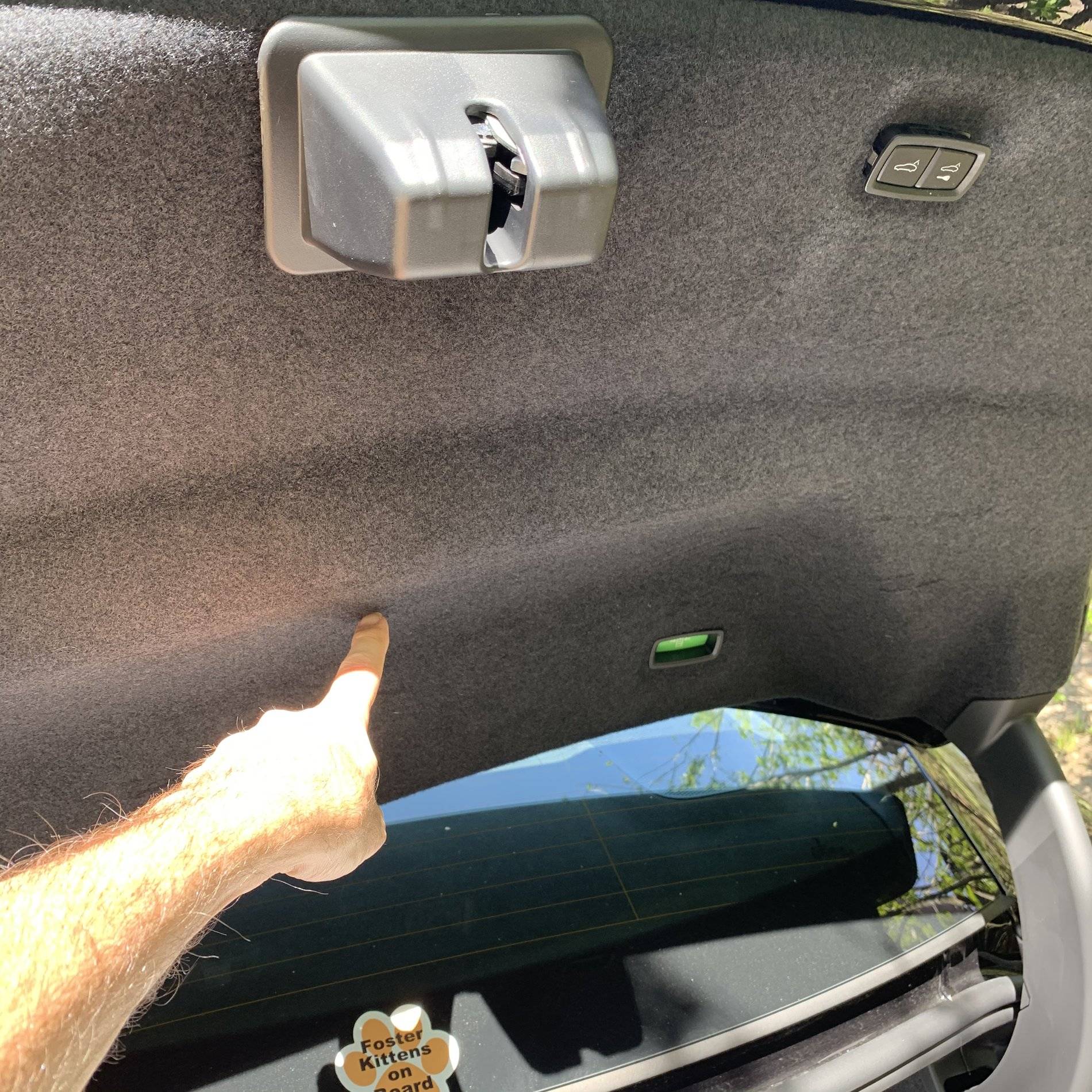

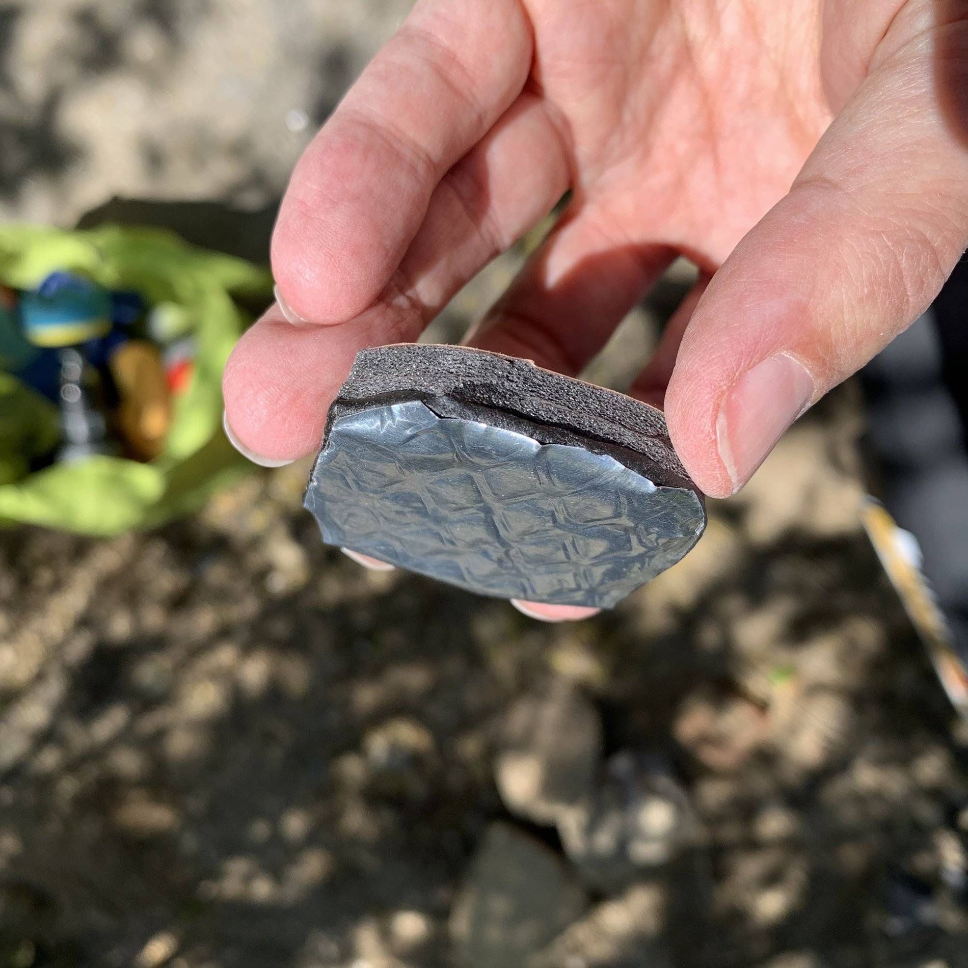

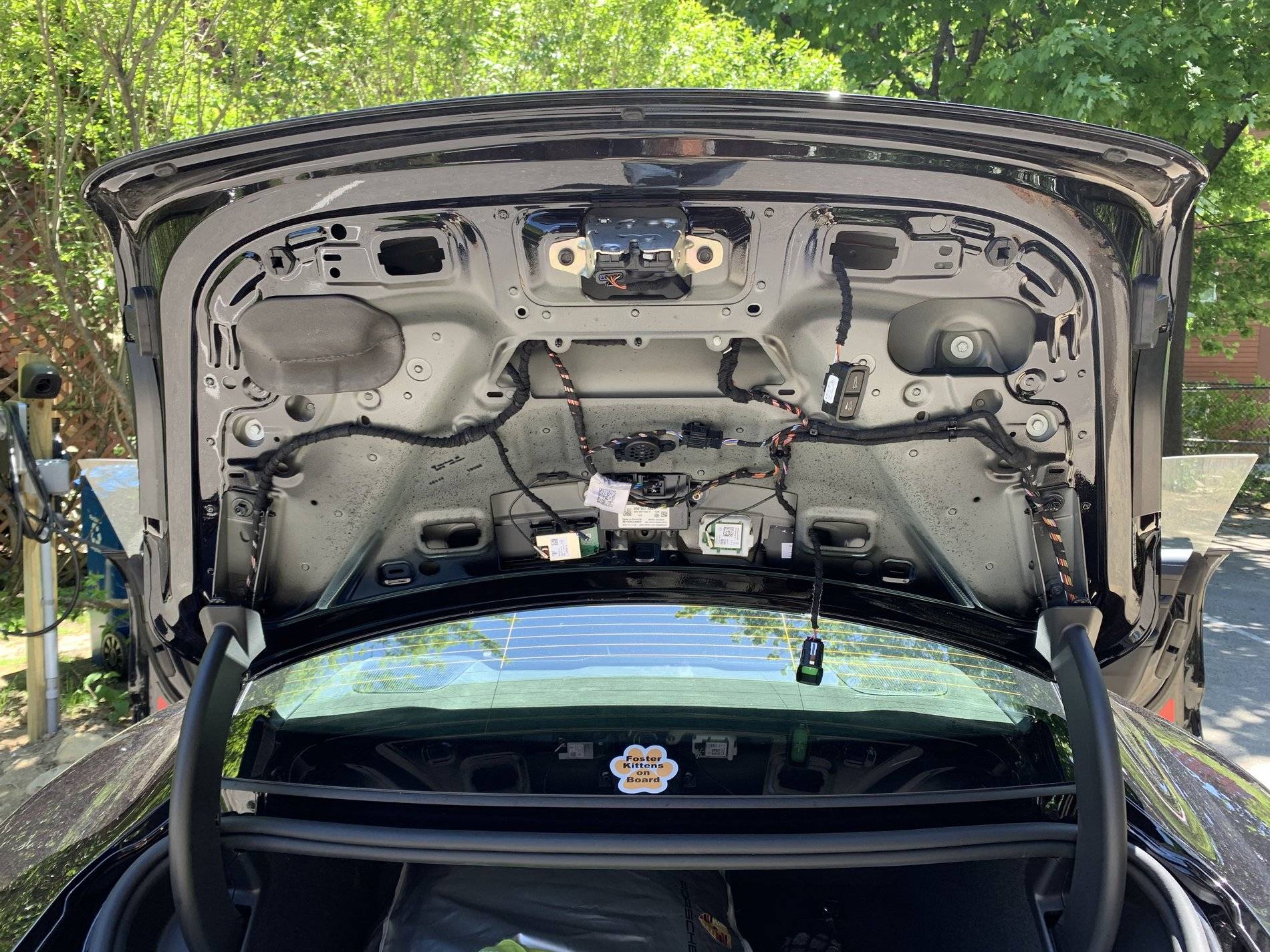

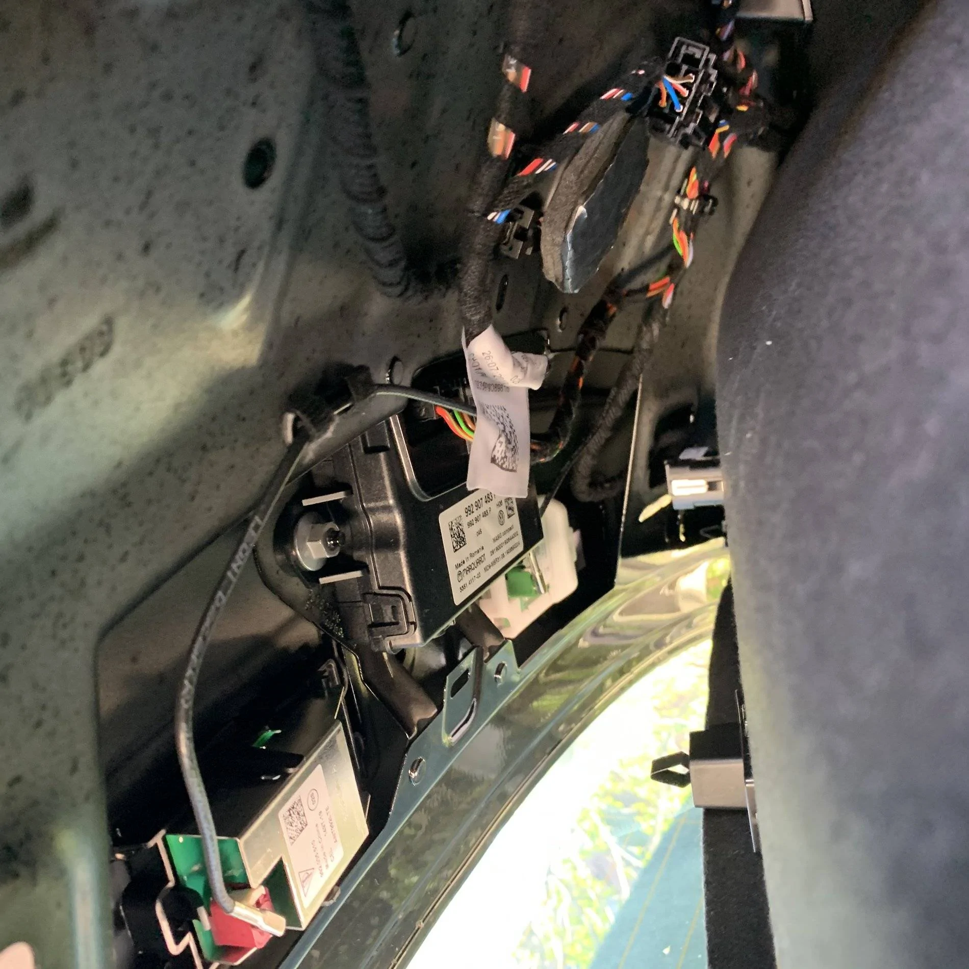

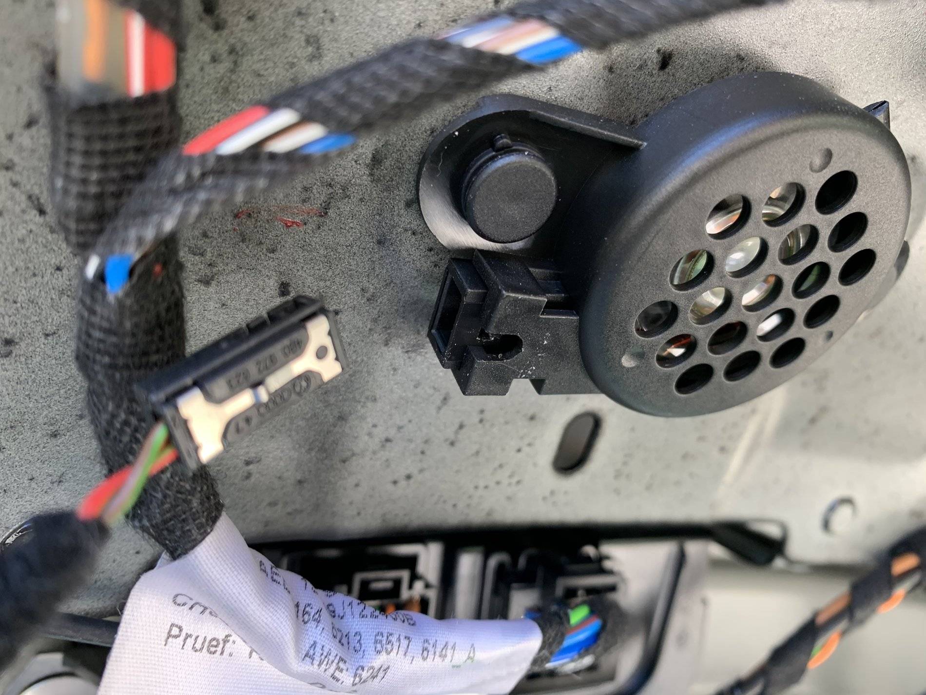

Ok. So, I opened it up. There’s the annoying speaker. Hmm... maybe I can make it quieter. I’ll cover both sides of the speaker with sound absorbing materials.
Nope. Fail. Didn’t significantly reduce the noise.
Ok then, now it’s unplugged. Hopefully it won’t throw a code.
The only regret is I also lose the warning beep if the trunk hits an obstacle when trying to close. I’ll just have to watch it more closely. I got used to turning my back and walking away, listening for the “failed to close” beep.
Golden Silence.

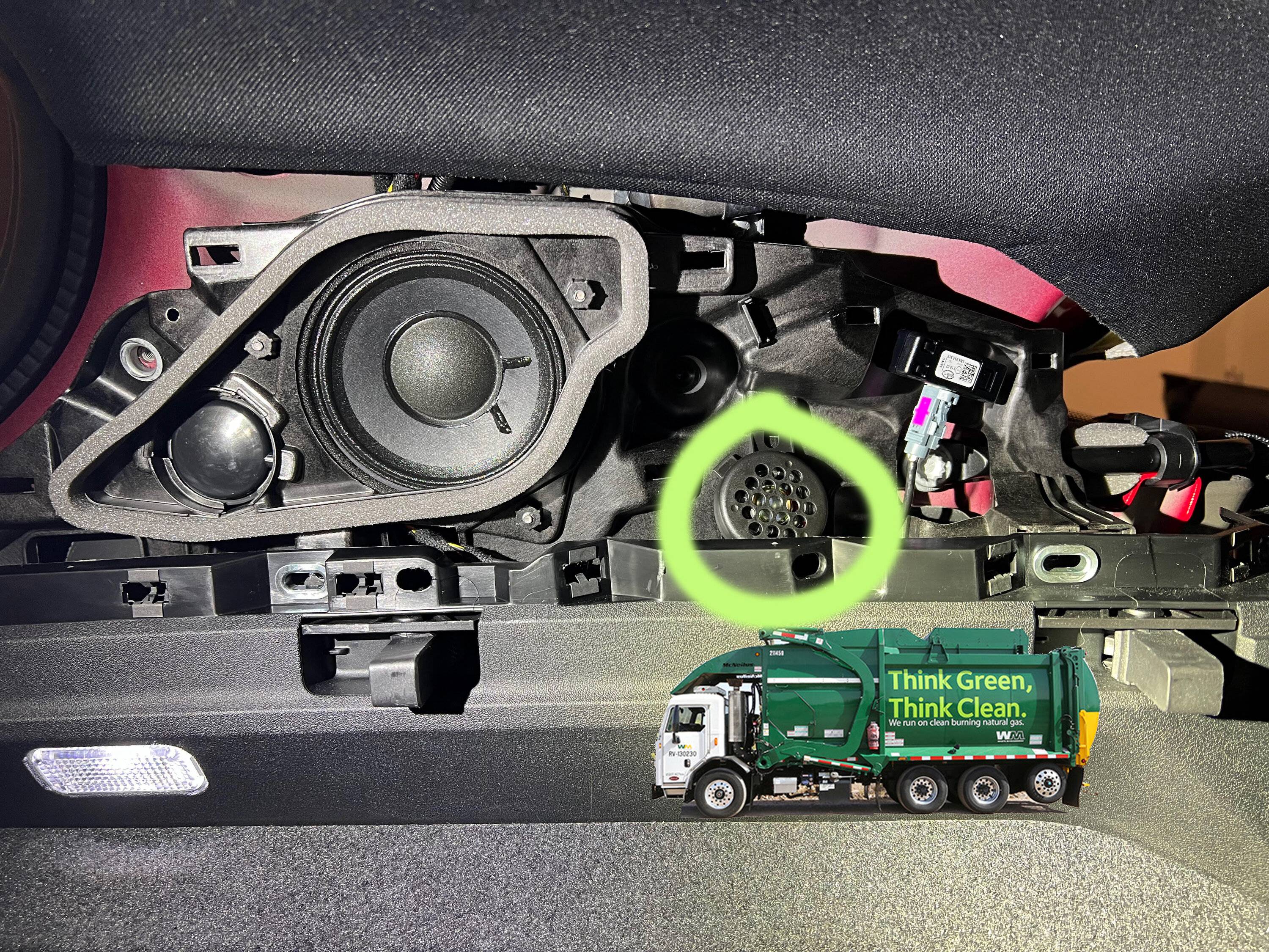

Ha, I went through the same exasperation a while ago... On the Cross/Sport Turismo, the garbage truck speaker is in the upper left section of the trunk, cf attached picture.
To get to it you have to pry the speaker cover panel. From there either you work with tweezers to unplug it, or you also unclip the next panel -- the one the rear seatbelt comes out of.
It does throw a code with it unplugged (000020 - Warning buzzer for rear hatch Open circuit) which also prevents closing the trunk from the center console touch screen. Opening still works, but closing is disabled. I assume that's the same with the sedan.
